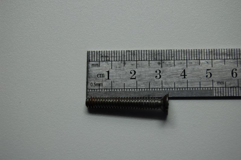

Cant find the correct screw to hold up my pendants
7 Jul 2006
57
Stirlingshire
Hi Guys
Having a bit of a problem tracking down some replacement screws for some ceiling pendants, the house is a 1930's build with medal conduit pipes , the screw in the picture is the only one I have , a previous owner decided to hold the pendants up with wood screws lol, she has went and bought some new fancy light shades that are a tad heavy so want to fix the pendants properly with the correct screws, tried everywhere local and all they keep saying is that it’s an imperial thread and i will be lucky to track them down.
I’m pretty sure you electricians will have come across this before, so hoping someone might be able to help, iv compared threads with metric screws, the thread matches an m6 screw but the diameter of the m6 is to big, to me it looks like an m5 diameter screw with an m6 thread..
My mate suggested tapping the holes up to m6 but tbh I scant be arsed with the hassle lol
Kev
I'll bet it's some imperial size. The problem is there are so bloody many systems.
Could be a 7/32 BSF thread but without getting a proper set of thread gauges on the thread and a set of calipers on the diameter it's hard to tell.
Indeed - and what about 0 BA, which I think is pretty close to 7/32" BSF. BA screws were pretty common in anything electrical.

0BA seemed too fat to me if his discription of the diameter is anything like accurate. Still worth a try though.
As I said without a set of calipers and thread gauges to measure the screw it's very hard to tell.
I would say it would be a 2BA thread, they are very common with older electrical items.

Its 2BA for imperial BESA boxes, I was told an M5 will just about fit, but it'll be tight as its slightly larger diameter and the head won't sit square as the thread angle is different
Think you can still buy 2BA machine screws on ebay though, as people still need them for older cars etc

The problem being that the screws are normally brass and break off over the years. I have done a good few replacement lights over the last three years and all the screws were 2ba, i am able to scource from a local tool shack(NOT B&Q) so a good merchants should be able to help.
A traditional ironmonger may have BA screws in stock, usually the even number sizes, as will many screw and fastener specialists.

If all else fails, get yourself an appropriate sized thread tap, probably 4 or 5mm. Just a taper tap will do the job. Re-thread the holes to take more common metric screws - much nicer than trying to mash a metric screw into the wrong size thread, shearing it off in the process, and leaving an unusable lug.

If it was 0 BA a M6 bolt would go in, as 0 BA has a major diameter of 5.99948mm and a pitch of 1.00076mm, although the form angle is different, it will fit no problem.
It could be 7/32 BSF however the pitch of the threads is closer to M5 than M6
If the pitch of the threads is close to M6 but a smaller diameter I would say it's 7/32 Whitworth(BSW).
BSW & BSF machine screws are readily available, try eBay or a local engineering supplier
