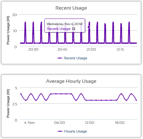

I use a smart charger, and normally I will monitor the power into charger, and when it drops to 2 watt which is 0.1 amp I know battery nearly charged, I will wait a little longer and when I open bonnet want to see volts on charger over 12.8 volt, which confirms fully charged.
The charger will often alternate between 0.8 amp and 0.1 amp at the end of the charge a few times, the charger will switch to 0.1 amp when volts hit 14.4 volt, and return to 0.8 amps if the volts drop below 12.8 volt, it starts charging at 3.8 amp, then drops to 3 amp but not really interested in the first to stages, it is when battery is fully charged which is of interest.
The Kia Sorento is parked at bottom of the garden, to far from house for one extension lead, so I charge the Honda Jazz at the same time, and use the bonnet space of Jazz to protect the extension lead plug and socket. The net result is I don't charge the Sorento very often, so this time Sorento battery 95 Ah was under 12 volt when put on charge, far lower than normal.

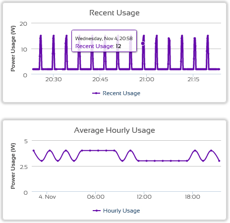

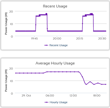

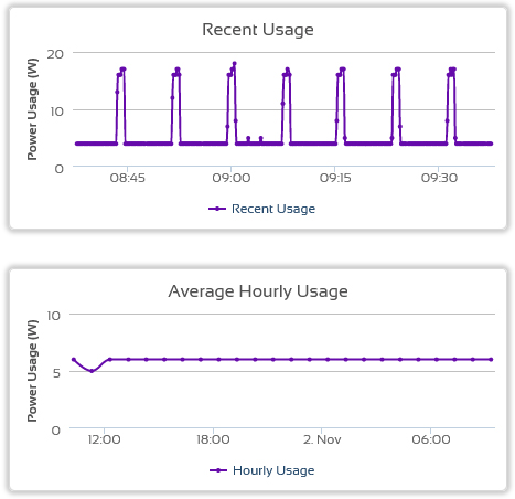

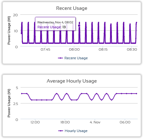

So this Jazz and Kia charging 22.jpg is the charge rate as the Sorento hits 14.4 volt and first drops to 0.1 amp charge rate, and you can see twice an hour the charge rate rose to 0.8 amp, and a few days latter this is the charge rate Jazz and Kia charging 30.jpg where it goes to 0.8 amp 7 times an hour, OK only 1 minute long each time, but the voltage is now dropping faster than when it first started to pulse, which seems wrong way around, in the past the time between the 0.8 amp charges as increased as battery became more charged not not decreased.
The Jazz battery 35 Ah has stayed at 0.1 amp and the volts have slowly risen to 13.8 volt, and in the past the Sorento has taken longer as bigger battery, but has also risen over 12.8 volt with just a 0.1 amp charge rate, so a little puzzled as to what is going on.
We are in lock down, can't drive the cars. I can't drive them until 9th of November when the fire break ends.
There is as far as I can see, no problem, however I can't understand why, as the battery reaches 14.4 volts it reduces charge rate from 0.8 amp to 0.1 amp and as one would expect the voltage will fall again, however why should the rate of fall increase? I can see why as the battery creeps into fully charged status how the time to reach 14.4 volt decreases, so the time at 0.8 am will decrease, but can't understand why time at 0.1 amp has also decreased.
Start patten when dropping to 0.1 amp Jazz and Kia charging 22.jpg and patten this morning Jazz and Kia charging 37.jpg as said understand why it stays at 0.8 amp for shorter time, but not why also stays at 0.1 amp for shorter time.

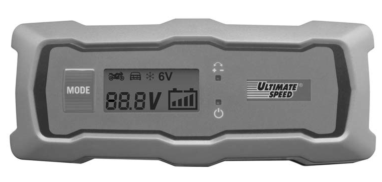

Two Lidi chargers, look very like the Ctek but have built in voltmeter, work both 6 and 12 volt, and very much cheaper, it explains the final stage, at 12.8 volt it raises output to 0.8 amp and at 14.8 volt it drops to 0.1 amp, if at 0.1 amp it hits 14.4 volt then switches off.

So interest only, why does the volts decay faster the more charged it becomes, I would have expected the reverse.

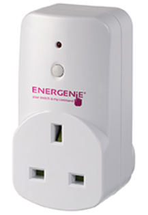

It seems the pulses are getting less frequent Jazz and Kia charging 38.jpg so it would seem likely it will stop pulsing given a little more time, the charger ChargerA.jpg shows fully charged, it is the energy monitor Energy-monitor.jpg which is allowing me to see what is going on. Until a couple of years ago I did not realise how much time is important with battery charging, I tried to recharge 2 x 7 Ah VRLA from a stair lift when the owner had switched off the charger, and batteries replaced and old pair mislaid for 12 months. Had to cheat and charge in parallel with a good battery to get the charger to work, and for 10 days nothing, then as if some one flicked a switch they fully recharged.
Normally I would not consider leaving a battery 10 days on charge, well not on charge as nothing seemed to be going into the battery, just on the charger, but after the 2 weeks they seemed non the worse for being nearly 9 months left fully discharged.
I am guessing the Kia battery has some sulphation and the charger is slowly removing it, but not seen this charge patten before, can't drive anywhere until the 9th when the fire break ends, so no harm seeing what happens.
The question is in the past have I been too fast condemning a battery, did I simply not leave it long enough, and if it takes a week or more for a battery to fully recover, can it ever fully recover on the car, unless using other than car alternator to recharge.

But 95 Ah at 0.1 amp is 950 hours, about a month, so can't really expect the battery to respond fast, it is only likely just above the internal drain on the battery, had the car around 4 years and never renewed battery, however once I take it off charge it will likely sit unused until Christmas, so makes sense to ensure fully charged before removing charger.
