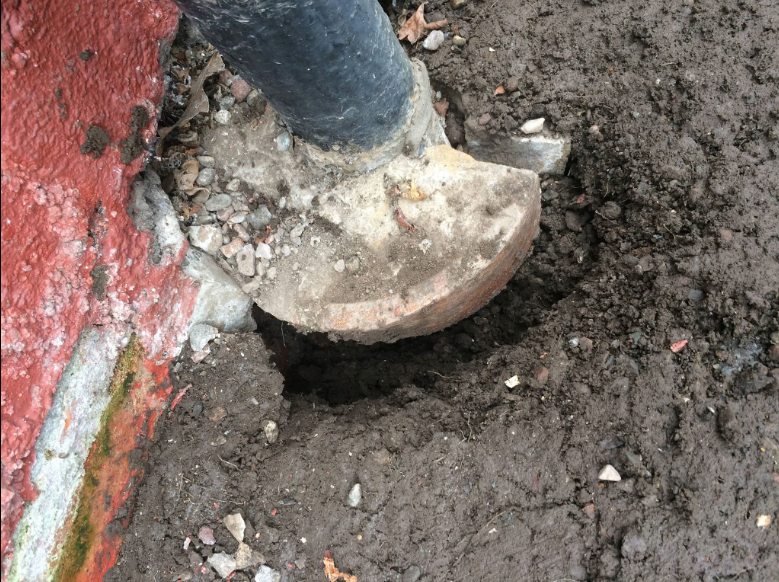

I have discovered today that the cast drain for the kitchen/bathroom waste (sinks/shower - not toilet) is fractured - underground. There is like a concrete collar round the pipe at ground level and that's all broken and I can see water peeing out of the pipe through the large hole round it.

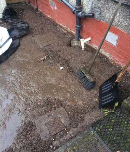

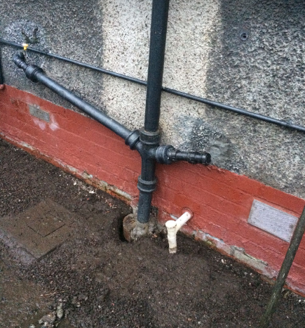

post acouple of photos one up close an the other well set back. post another one showing from the nearest manhole to the collar - is the CI drain actualy a gulley?
Will do. What's a gulley? The drain runs down the front of the house and my upstairs neighbour's kitchen and bathroom waste goes into it and then my kitchen waste goes into it (my bathroom is off a different waste after it was done up). There's a little sort of inspection bit about 5 feet from the main pipe where you can see the water coming off it - or you would if it wasn't draining direct into the ground :(
Under that concrete sort of collar, there is a hole - it would appear a large one - who knows where it's going. The water can be see peeing out of the pipe on the broken side of the concrete
The cover at the bottom of the photo is where you can see the water draining

It's fixed! :D My neighbour's builder son came and fixed it. I can't say it was a hole - there was just no drain!:eek: It was like a concrete elbow and it was just disintegrated so all the water had just been ****ing into the garden. Hopefully no more.
what did he do to fix it an did he do anything to the white PVC waste pipe?
what was needed was a gulley was one installed? google pics of gulleys.
He haunched it??? Seems to be fine and no, he didn't touch the white pvc - that's the replacement drain outlet from my bathroom - the one that the plumber told me that he needed a trench dug for it and I just looked at him and asked why he was telling me - I wasn't digging a trench!!
I looked at gulleys - I've never seen anything like that up here in Scotland
The vents on the wall next to the pipes! they are to vent the sub floor void, i would unblock them if i were you.
