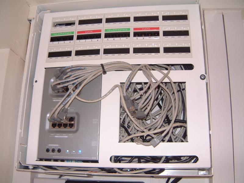

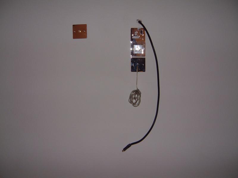

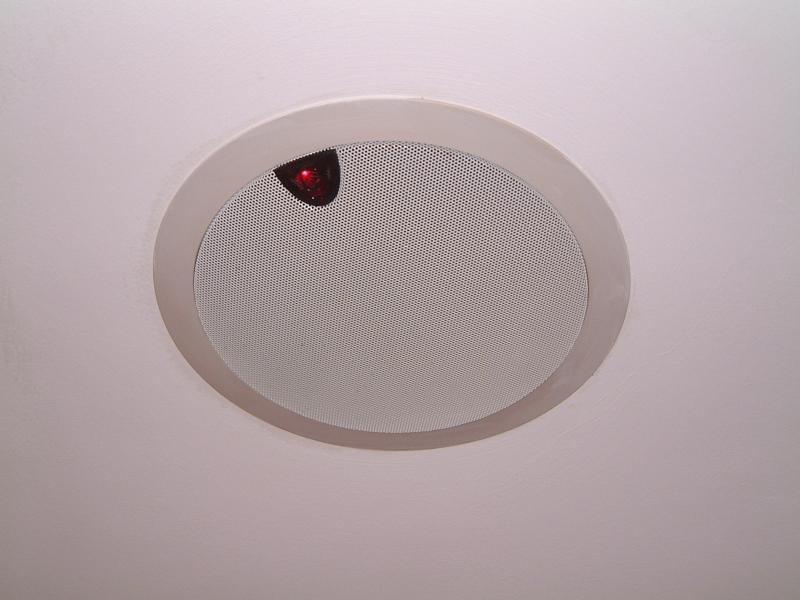

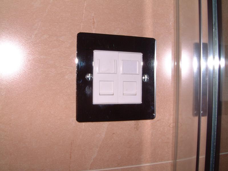

My daughter has just moved into an apartment which is stated to have Cat-6 multimedia cabling and an integrated sound system. Unfortunately apart from that I have no other information regarding all the installed equipment and how it is meant to work. There are several boxes which I don't understand the purpose of, speakers and strange multimedia switches in every room etc - I'll post some photos below.

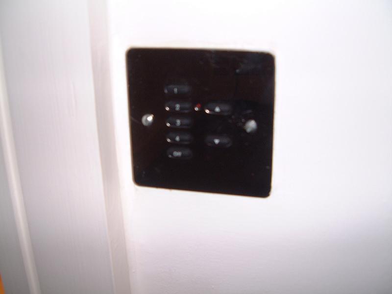

The most immediate problem I have is that there is a Rako RCp07 wireless switch in the lounge and it is not switching one bank of lights that it is meant to control. Does anyone know where the wireless signal from the switch is received to do the actual circuit switching ?
Some kind of network box - closed and open views :

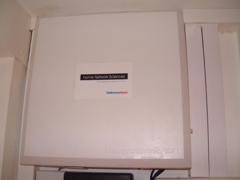

Don't know what this box is for :
Speakers and switches I don't understand in every room :
Huge amounts of multimedia connections in every room :
Even in the bathroom !

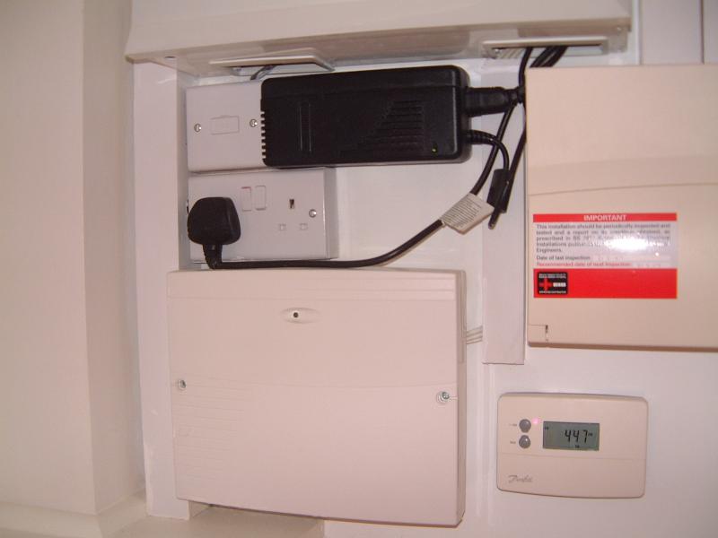

A door video entry system - I don't know if this is connected to the network in any way. It doesn't work ( completely "dead" and I can't even see where it's powered from ) :
I'd be very grateful if anyone can advise me where I should start to look to see if I can at least get the wireless Rako switch to operate the bank of lighting it is not switching at the moment. Also, where are the lighting dimmers that this Rako wireless switch controls likely to be located ?

What do the boxes you have picturered say on them?

I'd start by looking for model numbers on the stuff you can see to see if you can nail down what each item is and if one of them is likely to be your receiver.
I'd also look for anything that looks like it might open a hidden compartment in the building.
But it's perfectly possible the receiver is hidden somewhere totally inaccessible like above a ceiling.
It's also possible that some boxes related to the system were taken away by previous owners/tennants.
Thanks for your replies - I don't believe that anything has been taken away. I think it is possible that the wireless receiver unit I'm looking for might be somewhere above the ceiling - I just don't know. It would help if I knew what I was looking for ! :confused:
The rako kit has recievers that look identical to ELV lighting transformers - several can be coded the same so one switch operates several lights. Are they downlights that are not working? Look behind them ;)
If it is fixed lights like pendents or fancy drops etc, you would hope they placed the controlers (recievers) for them somewhere accessible.
Each reciever can switch upto 500w, so one will likely do a run a lights.
The install looks a mess - nothing is level!
The inside of the patch panel is a mess too!

Three banks of downlighters work OK ( buttons 1 to 3 on the wireless switch ) but the lighting that doesn't work is the "mood lighting" above the coving.
