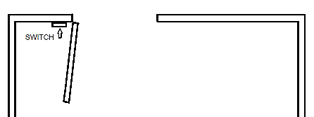

ehhh? Its in the room.. Right behind the door.. So I have to go in, close the door behind me and then struggle to find the switch.
I can't stress how dark it is.. I am on the edge of town so there is literally no light of any kind.. And once you go into the room you may as well close your eyes..
For some reason the developers put the switch on the hinge side of the door, where as it should have gone on the other side...
It really isn't a big deal.. I can live with it if I have too.. Buts its far from ideal.....

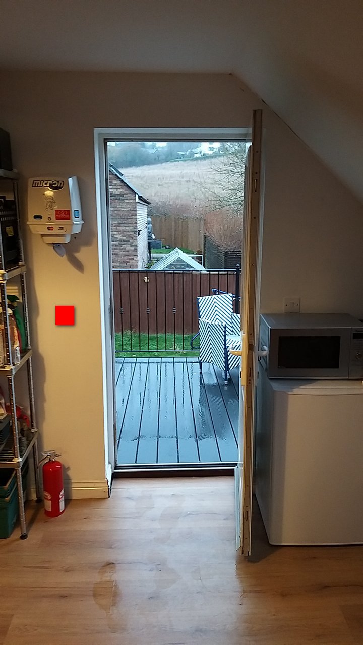

This should help understand what I am trying to do... Light switch is on the right.. Door is hinged on the right.. Door is open and gets in the way of the switch, so you have to close it behind you to get to the switch...
Not actually so bad going in.. But coming out can be dangerous as you have to switch off the light (giving you immediate night blindness) and then open the door to get out without smacking yourself in the face with the door and tripping over the step.
If the switch was on the other side, I could simply step out and switch the light off as I go....
So I want the switch on the left side where the red box is....
