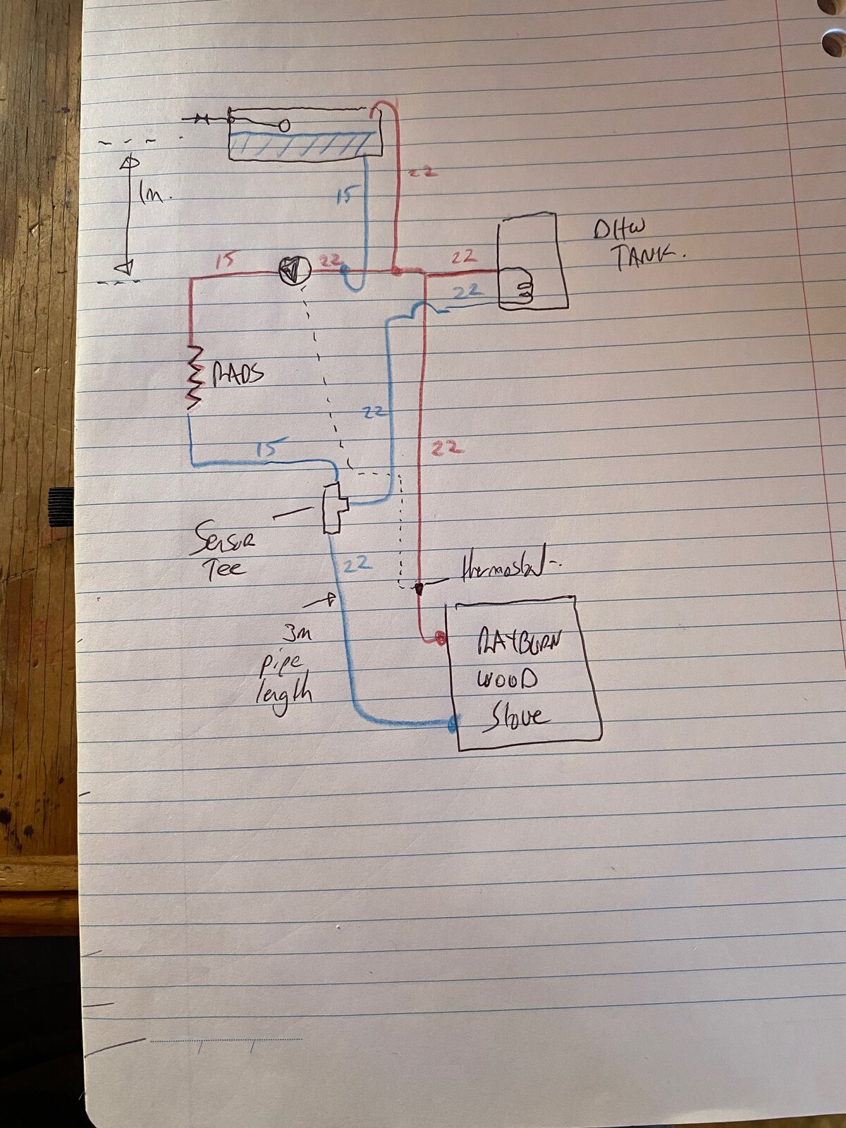

In my post #24, the schematic is the planned schematic to rectify the current issues. It creates a fully pumped circuit, where a manifold distributes water to the DHW tank and two radiators. The pump switches on via a thermostat positioned close to the boiler. If the water from the Rayburn drops below a set point, say 65 degrees, the pump stops.
In post #31 by Jon, the schematic shows a primary gravity thermosiphon circuit between the wood stove and the DHW tank. A pump on the return line with an injector tee is shown for the radiator circuit.
I like the gravity fed thermosiphon circuit as the tank acts as a good buffer for when you need to ramp up the fire to cook bread for example. However. it is a bit problematic for me to plumb like that now (not impossible just a bit difficult).
Do people think the schematic I drew in #24 is significantly inferior to the thermosiphon option?
In the injector tee circuit, the cold water feed looks to act primarily on the supply side of the pump.
I suppose I am asking, in a wood stove arrangement, whether pumping with a manifold is ok, desirable or inferior to the thermosiphon/injector tee setup?
Couple more questions:
1) The static head on the pump inlet for the injector tee setup seems to act down the feed pipe, through the injector tee, through the stove, through all the radiators and back to the pump. That seems like a lot of static head reduction.
2) I presume given the (1), the injector tee and pump in loft would not work?
Nathan
Here is an example of the injector tee and pump in the loft and vent and feed going to the pump inlet.
The tank thermosiphons and the radiator circuit is pumped.
I should be able to get 1m static head between top of water in header tank and pump in this arrangement.
Comments?

What sized flow/return pipes to the cylinder as currently supplied from the manifold?
There should be no isolation valves on this circuit, the pump is also in that primary circuit, the system should really be somewhat like your schematic, below. Apart from any regulations, it must be remembered that in a gravity system the circulation force/head is tiny, for example, the circulating head/pressure per meter height with flow/return temps of say 75C/40C is only 0.018M or 0.69inches, assuming your circulating height is ~ 5M then the circulating head becomes 0.09M/3.45inches, or a flowrate only 17% of a pumped system running at a pump head of 3M.
Gravity circulation is also affected by horizontal pipe runs, if possible, they should be installed with some upward slope.

As above, the cylinder should be stand alone.
That's why the pump is cavitating?.
It posssibly should, @Exedon will know.

That looks reasonably OK IMO.
No, the static head on the pump inlet is just the height between the pump inlet and the F/E tank water level, which we understand is 0.5 m.
The dynamic head on that point is only a little lower, due to friction loss between the cold fill connection and the pump inlet.
Don't understand. Is the F/E tank also in the loft (above the pump)? I don't know anythng about injector tees.
