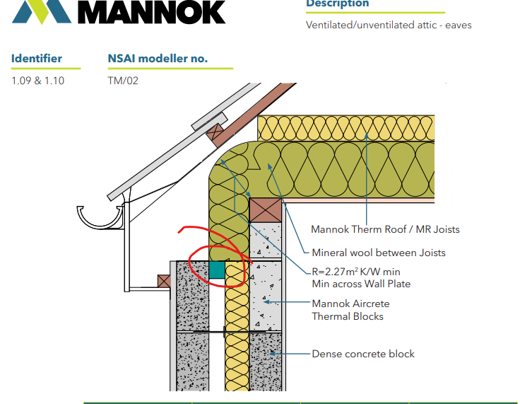

Hi, When the cavity is filled with 90mm PIR there is a 10mm remaining cavity but there are very few details of how this is finished.
In this diagram a closure (circled in red) is shown but I cannot find any products to do this (Fire socks etc are all 65mm or bigger)- any suggestions on what should be used? Thanks
