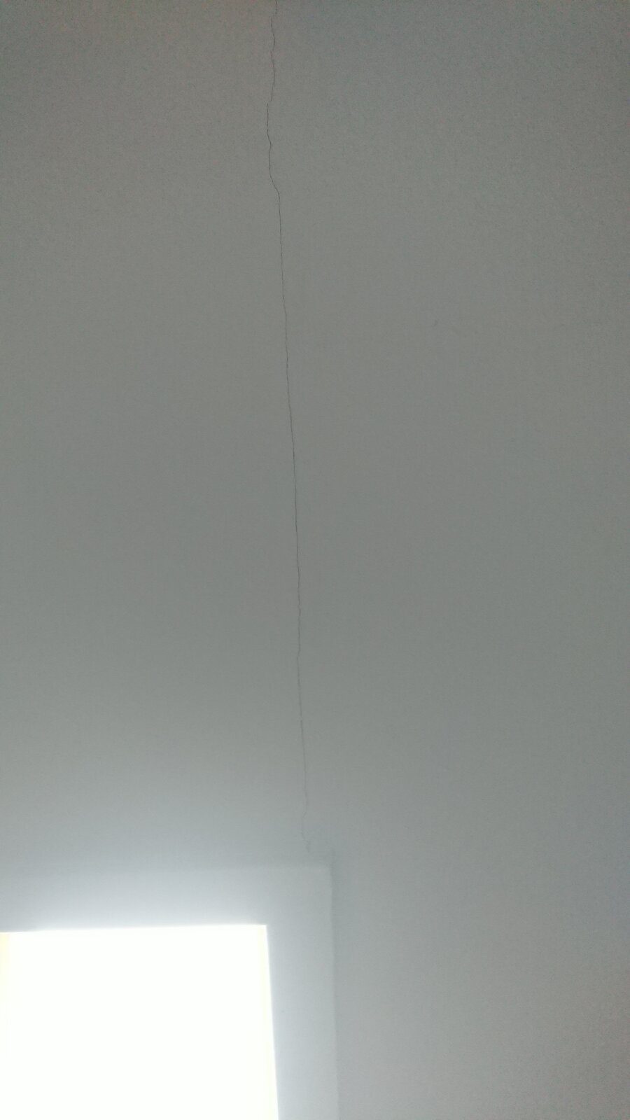

I noticed this crack coming from the corner of the bottom frame of a skylight in our roof. It is quite straight and 1 and a half metres long. Should I worry about it, or just try to paint over it. Opinions gratefully received!

Probably just a join in the plasterboard. Rake it out with a van opener so that there's a 'V' in it, fill, sand and repaint. Cross your fingers that it won't come back!
