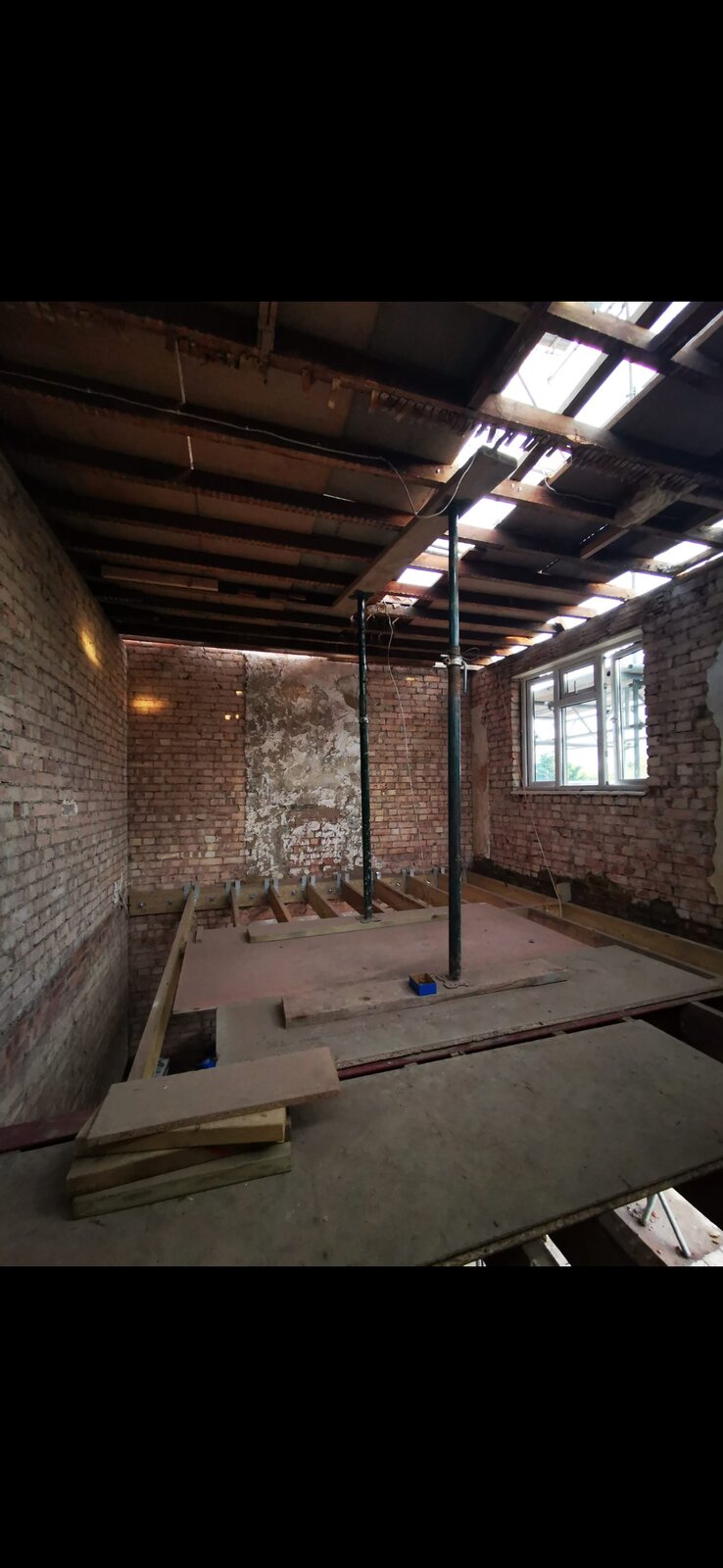

Hi all,
Please see pic
Building dormer loft conversion. Steels will have a joists between them and support on the wall as per normal practice.
The pic shows 1st floor old ceiling joists but builders claim they are not in a great condition, some of them bendy and need replacing. As they are only now holding a ceiling only, is it necessary?
Thanks for you input

I don't understand what joists are what, what's staying and what's going.
Towards the top of the pic are the ceiling joists for the first floor (old). New joists are being fitted between floor beams above in the dormer loft conversion

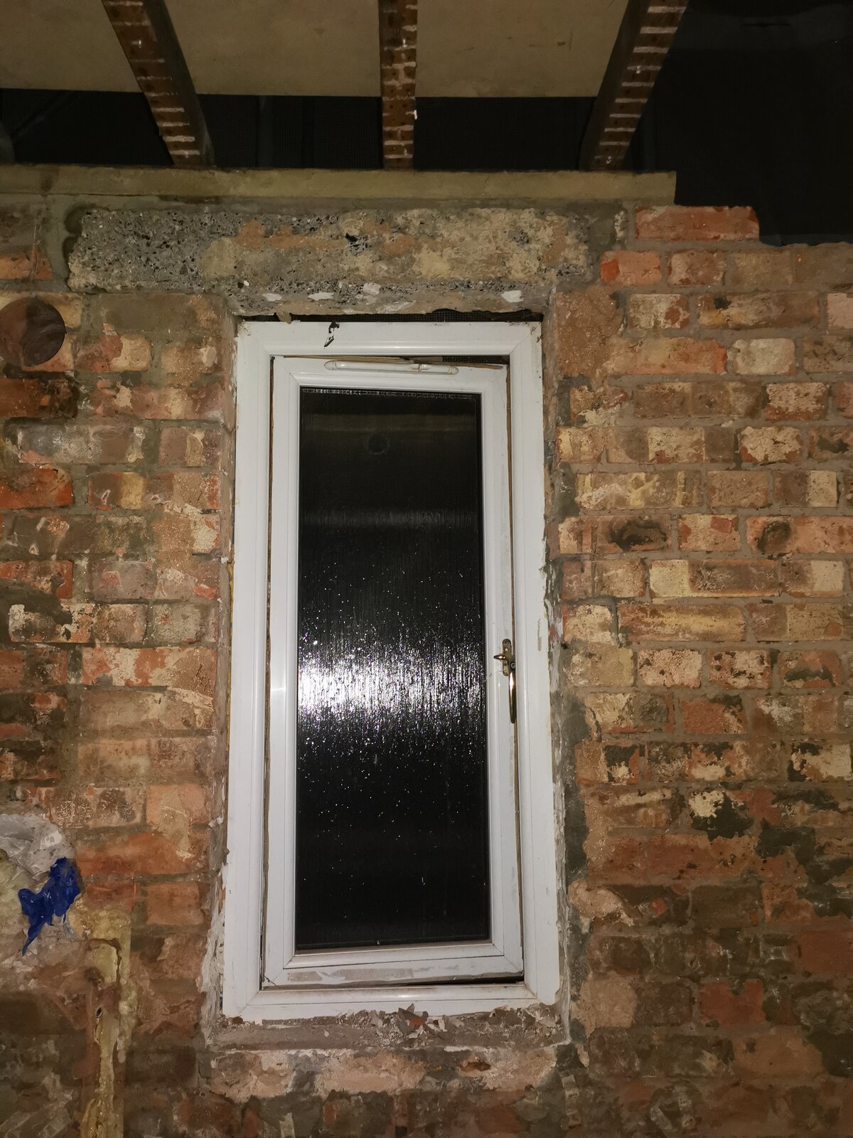

Lots of things are popping up now:
Lintels are like this:
Been told they all need replacing... Would you agree? The house was like this since 1920s!

There is nothing wrong with old things! :cautious:
Things which are performing well and have no problems now tend not to need changing. Only change stuff if it is broken, is nearing life end or wont perform as needed once you do other changes (extra loads on lintels say) or suchlike.

While you're talking to BCO, get his thoughts on those joists- they look well overspec for a ceiling only, if they've sagged a bit then builder could sister bits of roughsawn fence board or similar to them to give you a flat level ceiling. Jacking them up won't work well with no downward load on the ends :)
I did have a conversation. He said the lintels should be replaced. I don't get why?

Are the building regs now specifying they have to be steel lintels?

I don't get why?
You need to find out why, it is nonsense that a 150mm concrete or even any lintel needs to be changed for a loft conversion
If need be all you do is put another lintel above before the floor joist go on

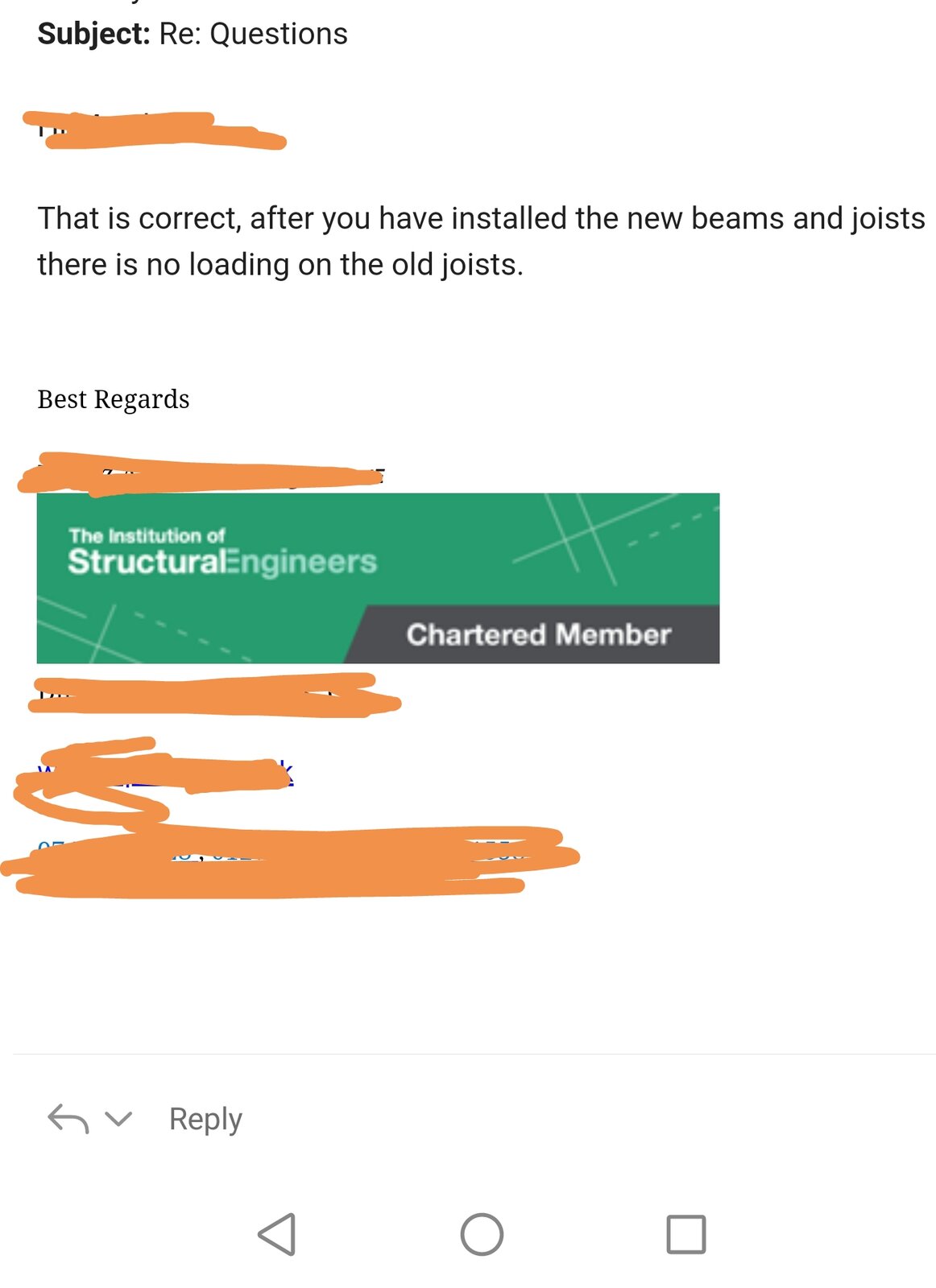

I emailed the structural engineer to get confirmation. So I'm perplexed at the BCOs rationale for saying I have to replace those ceiling joists as it's load bearing! Makes me question all his other assessments
