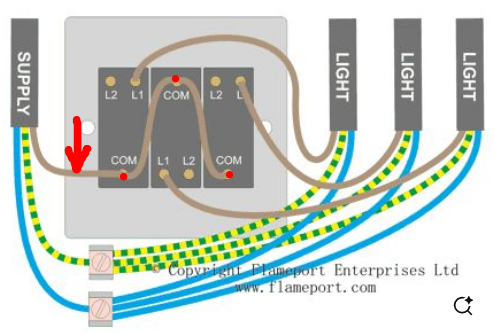

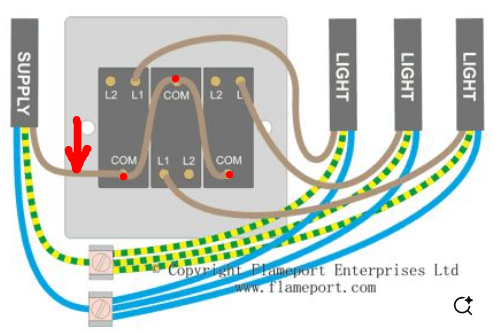

Planning to replace existing single ceiling pendant light with 9x GU10 bulbs and a 3 gang light switch for 3 separate zones.

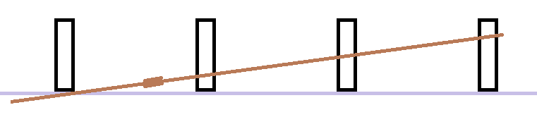

you will have larger access holes for drilling through ceiling joists.
