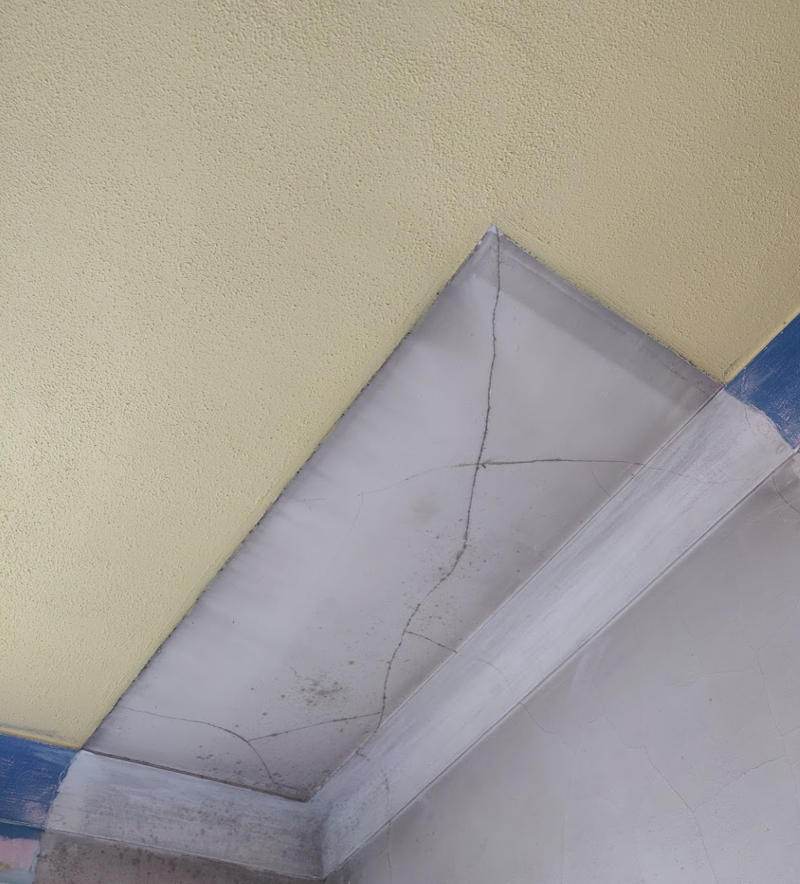

Hi there,
Doing some renovation work in the box room and we have taken away a large floor to celing cupboard.
However, now the ceiling pattern does not match (I suspect the ceiling paint was done with the cupboard in-situ).
What is the best way to continue to ceiling pattern...
Thanks in advance
