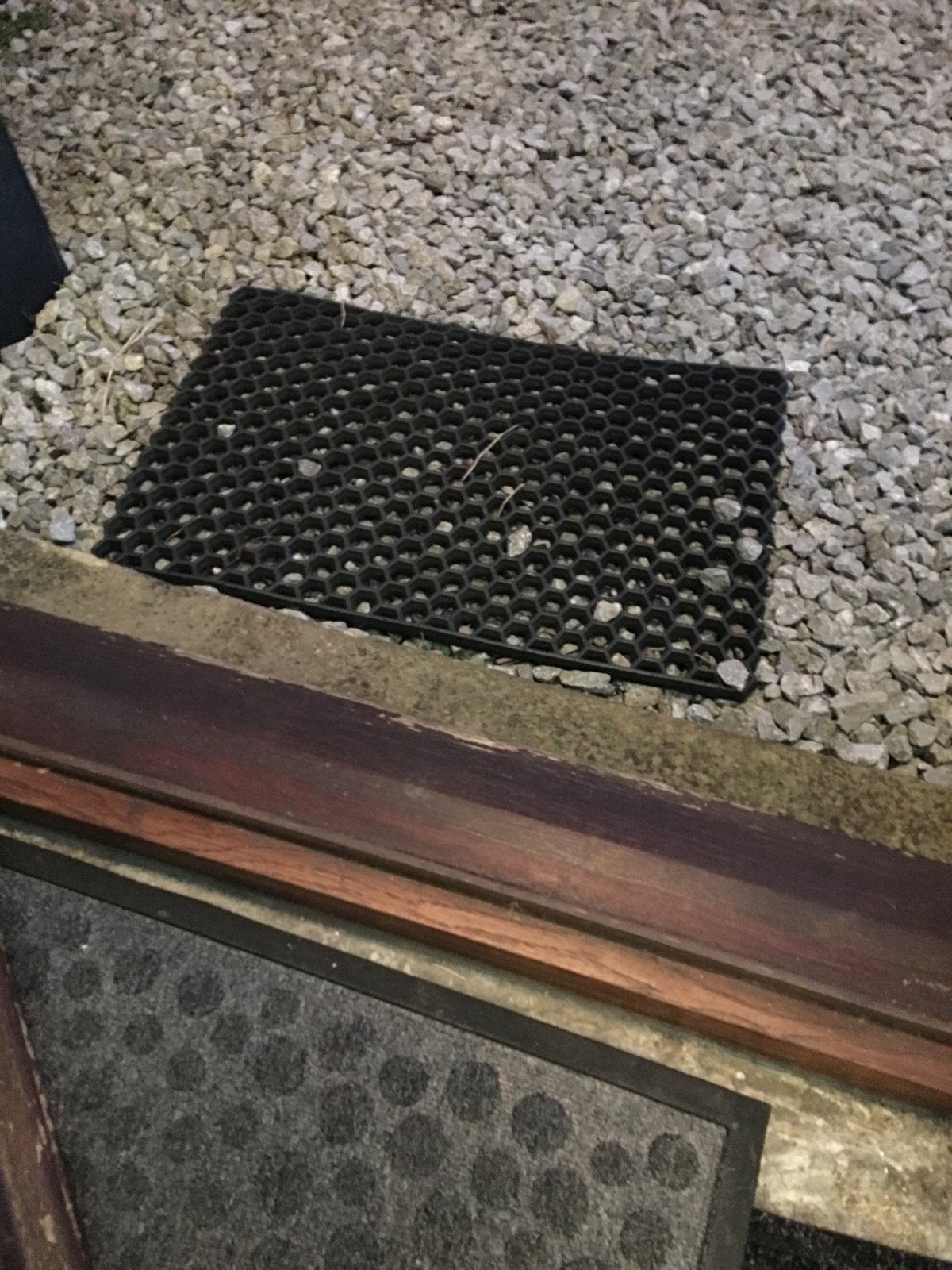

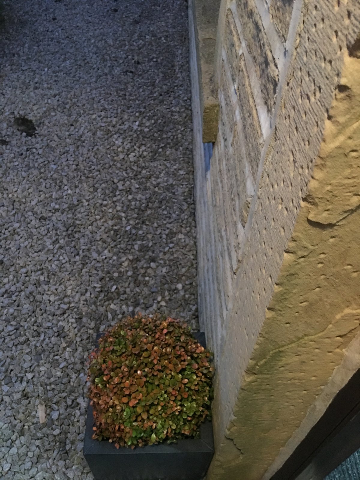

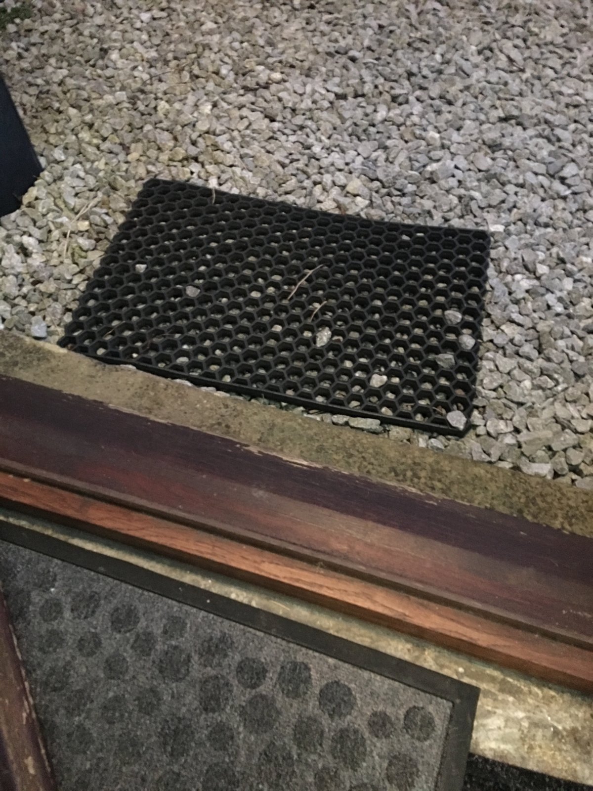

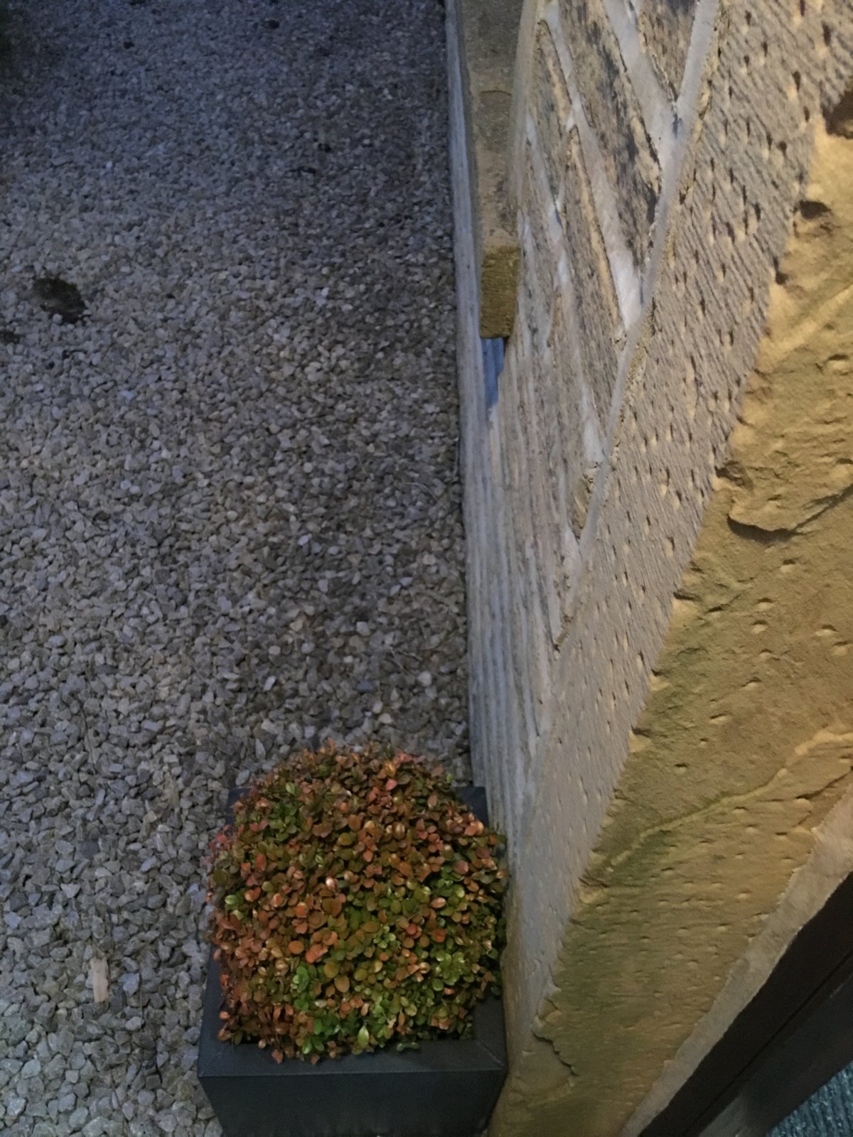

Picture is front door threshold and a shot looking to the right of door. The coal chute us just under the gravel below the window cil.
I’d thought about some humidity control is the chute is the only vent one open. The cellar is approx 2m x 4m very small

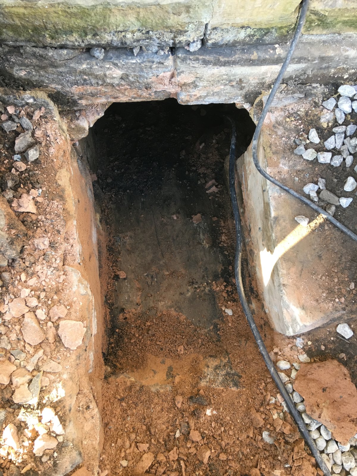

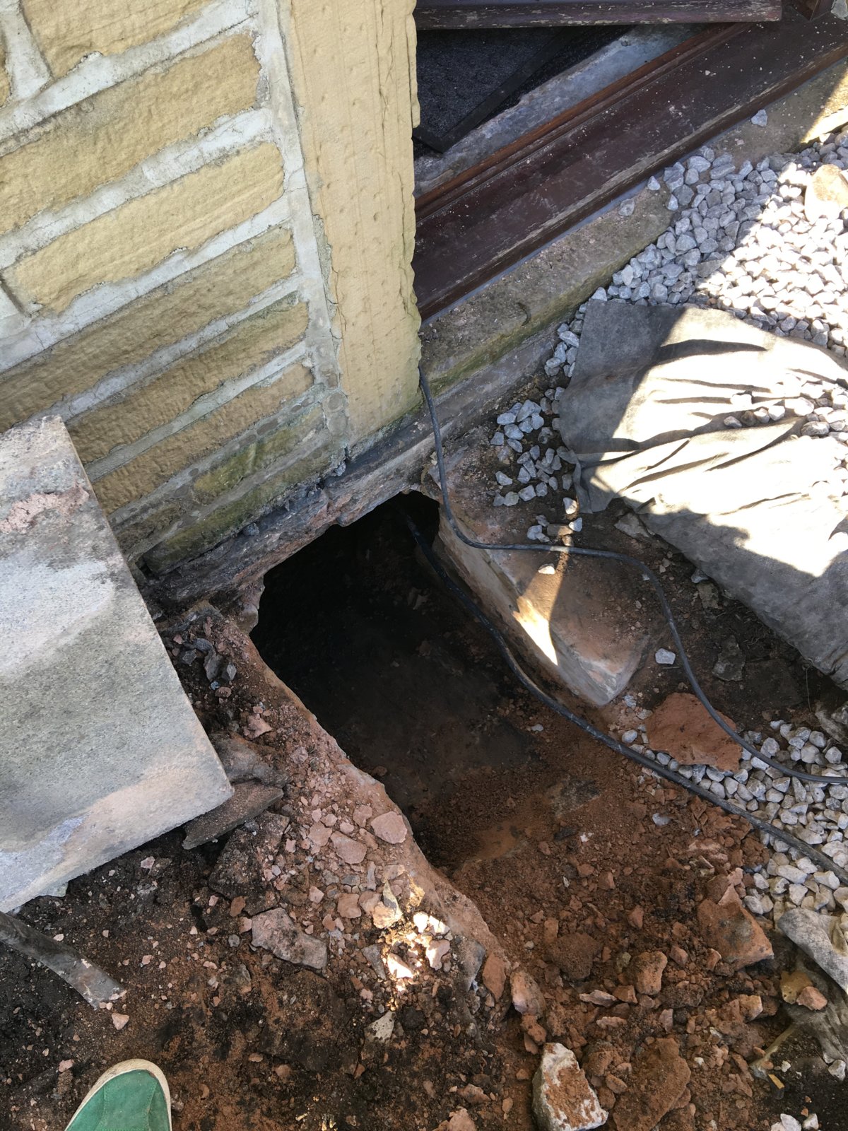

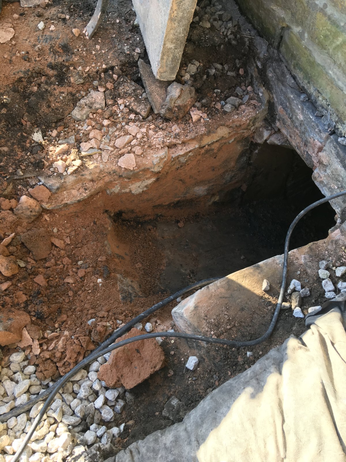

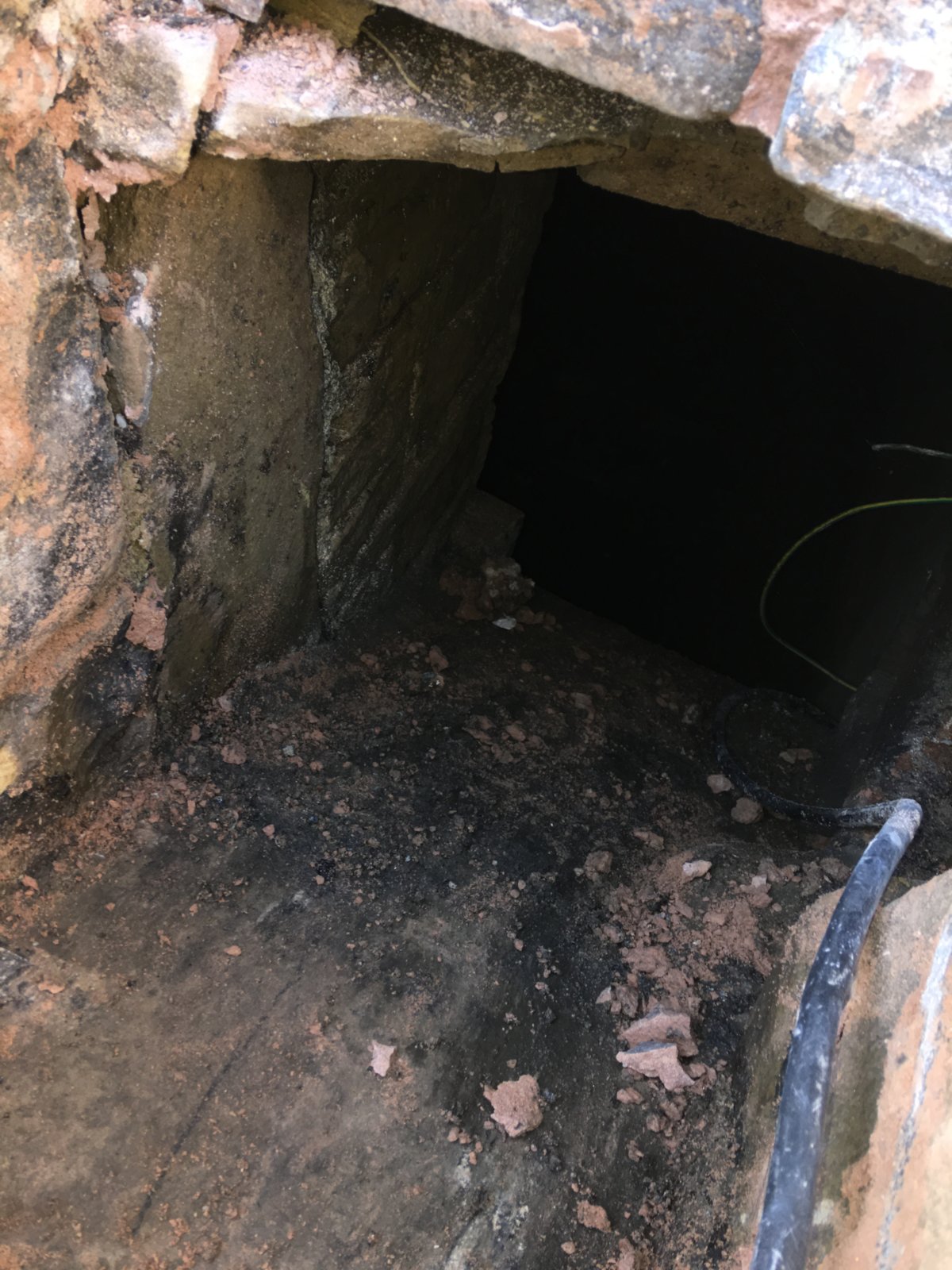

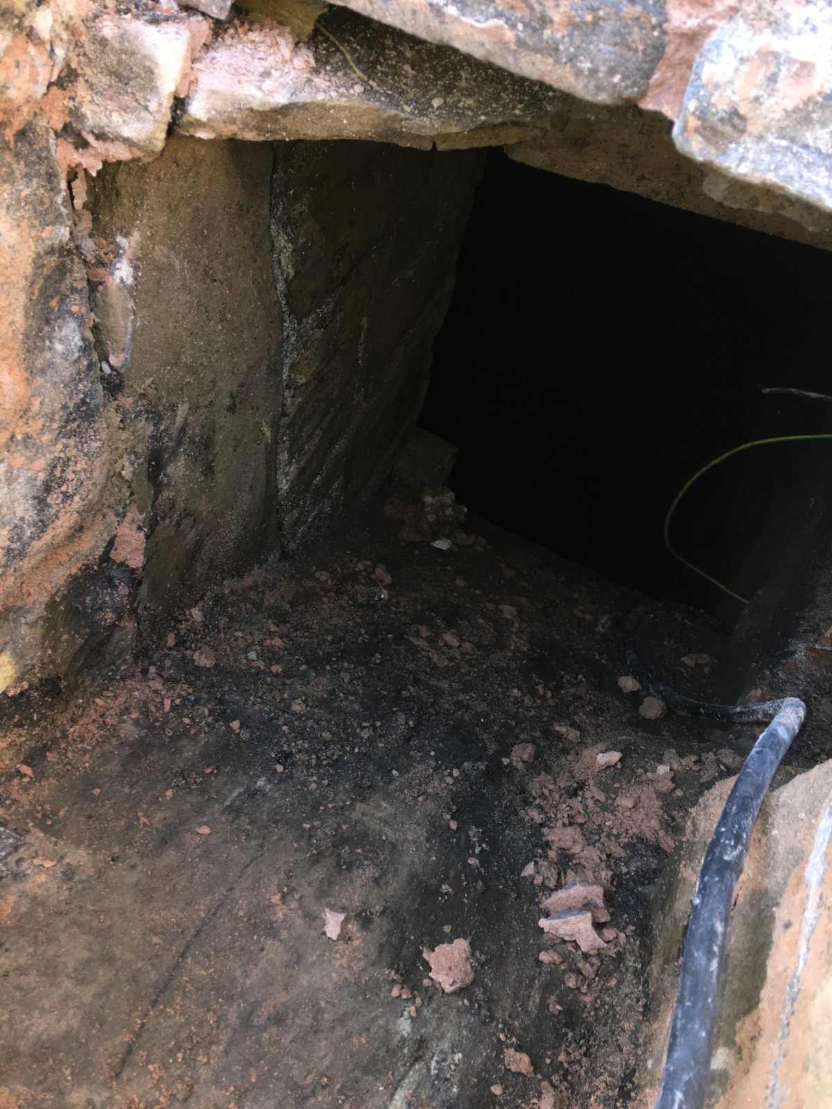

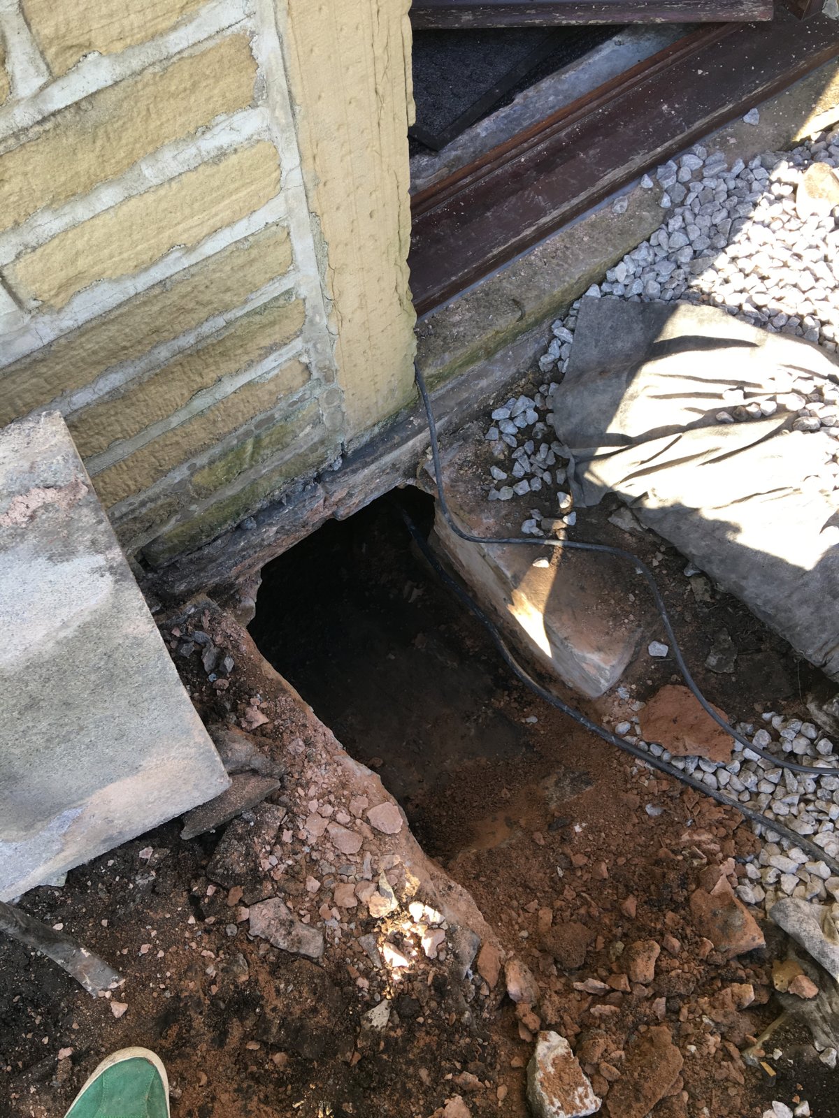

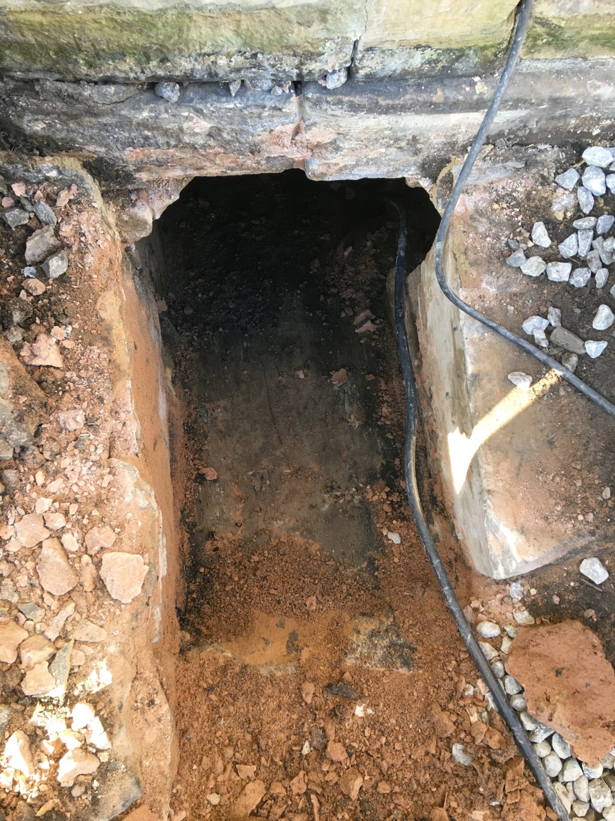

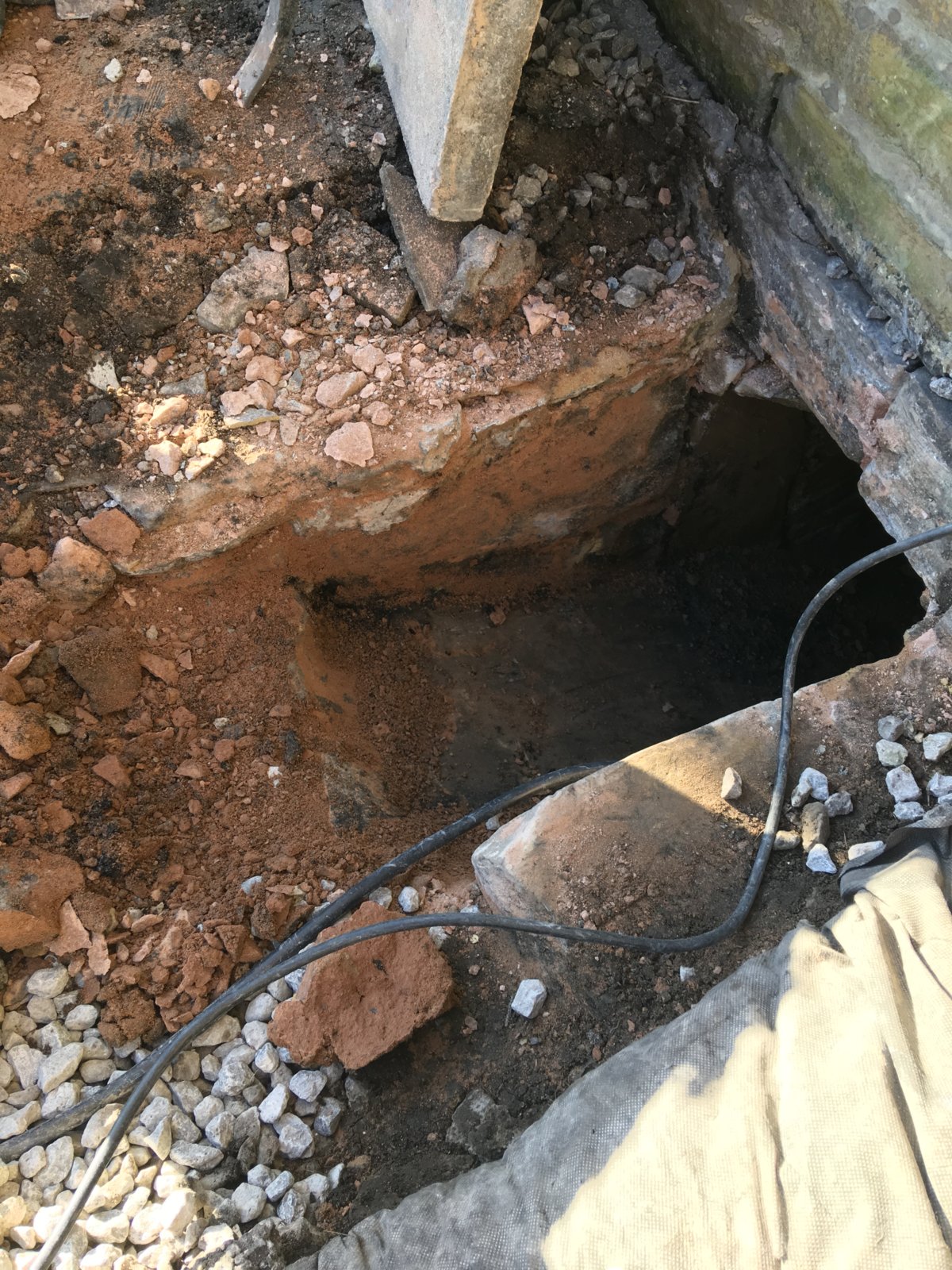

Hi all. I did a bit more research and found some periscope air bricks. I’ve also dug out the old coal chute and covered with a slab to stop rain pouring in.
What I’ve found is that the solid ground floor forms the cellar roof. They are huge slabs, as such I can’t chip out a stone one course above the coal chute opening to install the vent. It’s actually the floor. I could chisel a bit out but I’m a bit worried about damage. Secondly I can’t install a vent at another point in the house as it’s all solid floor. The cellar is 1/5 of the house floor space.

You could make up a pericope vents using 4" soil pipe and stick a fan on the internal end to increase ventilation.
Any ideas what to put on the external end to prevent water ingress and rodents getting in? Also would the fan draw air in or push air out
You may need to be a bit creative on this. You need ventilation on both sides of the cellar, and the fan will pull from one side, and push out of the other. You'll also need to find a fan, and then find the pipe size to match it. The pipe needs to be sited about a foot out of the ground, and then be bent back over on itself so that it points downwards, and then fit a rodent cover on it.
