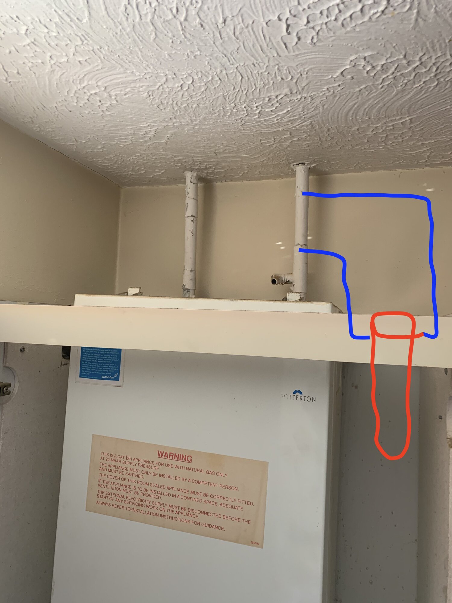

The x400 is in now for over a week, though wished I had used 2 bottles. The only exposed pipe work in the house is above the boiler and in the tight airing cupboard.
Regarding Magnaclean:
There is only a 22mm vertical height between the ceiling and the boiler (see pic). I doubt even the smallest filter will fit into that space. I am assuming its not possible to connect it as shown in the blue drawing.

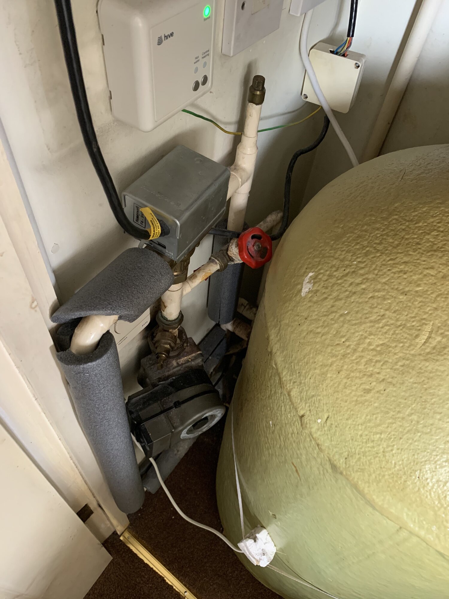

The airing cupboard is on the tight side so not sure it will be possible either
Also I did try the magnet trick and there was some magnetism in the airing cupboard on the pipes under the grey insulation. Strange because those pipes are very hot
