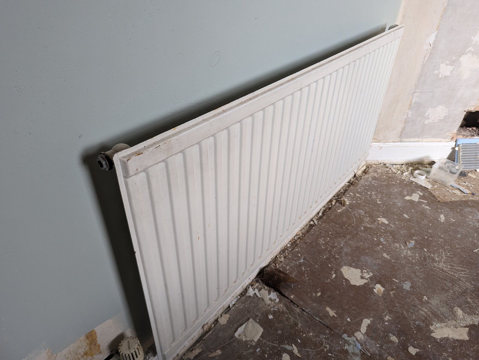

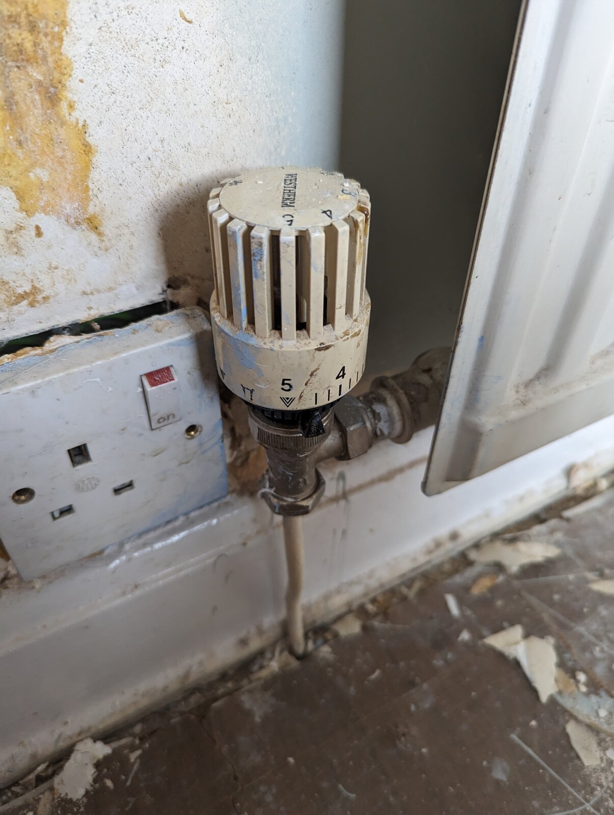

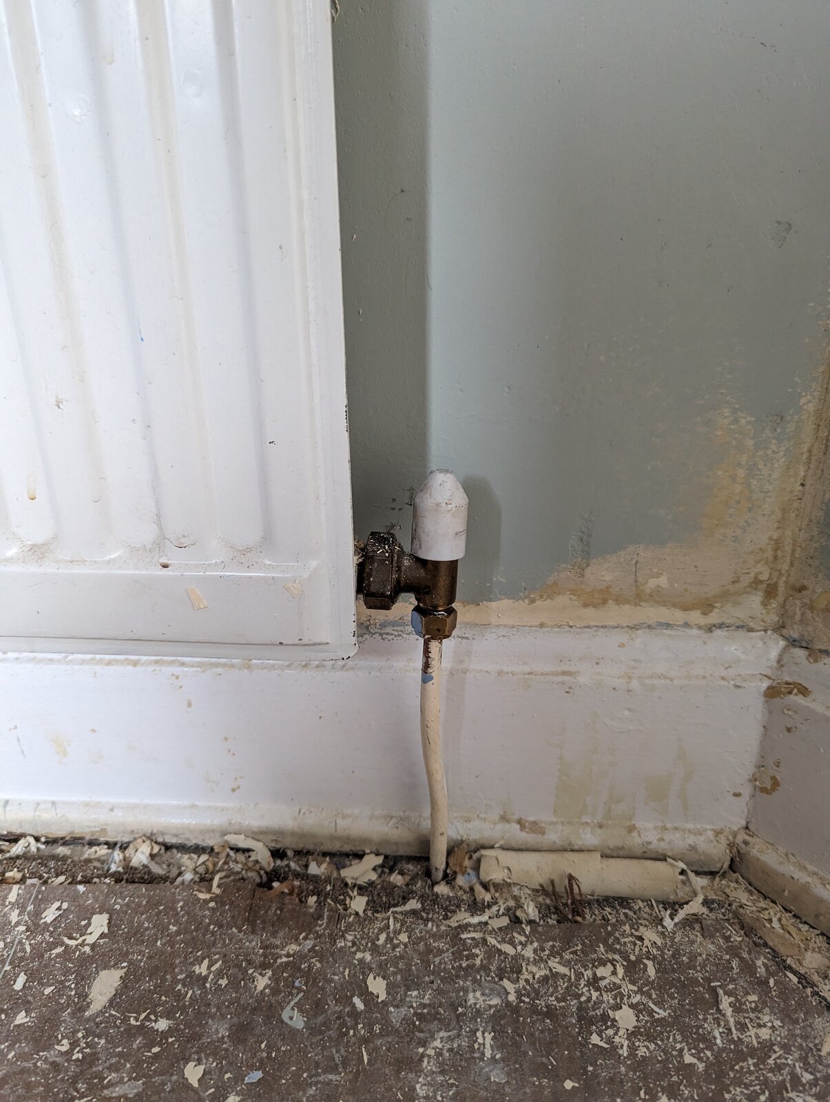

on the actual radiator put a pic up of your rad

You close both valves on the rad ,remove the rad after draining it, and fit blanking cap nuts to both valves.
No need to remove the valves from the pipework.
