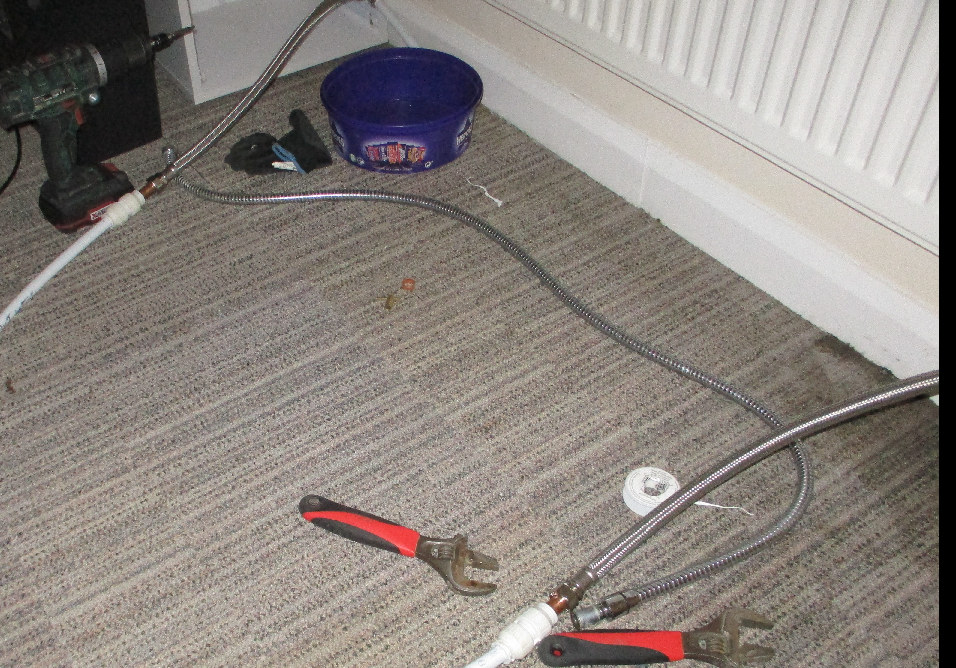

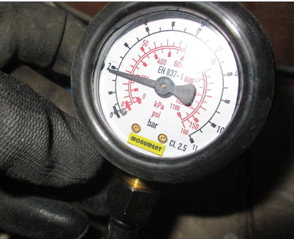

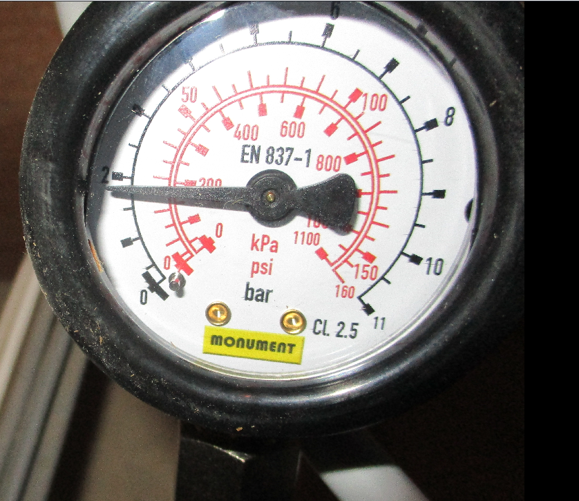

I tried everything to get this rad moving until I pressure tested F/R and found they were the same.

Hi all,
Thank you for all of your help. I've tried to do as many f your suggestions as I can.
I can't take a useful picture of the loop pipe as it joins the system under the only par of the downstairs that is still carpeted, and all our furniture is in that room.
However, today I checked the system, and the Flow pipe (marked by the builder), was cold, whilst the Return pipe, (again marked by the builder), was very hot.
I drained the system and re-joined the loop pipes, then refilled the system. With all the radiators off except the previously cold one, that rad started to get warm. After some time, and some bleeding, it got relatively warm, so I opened the other rads one by one. There is a huge amount of air in the system, and the pump struggles to get up to speed.
There is still air in the system, that I am struggling to clear, but at least the rads are getting hot. I know that new valves etc can fail, but the rads and valves downstairs are brand new the year, and the ones upstairs are old, but have not been a problem since the builder started work.
I do think, and my thoughts are not based on knowledge or experience in the trade, that if the flows and returns are fighting against each other, it is a recipe for disaster. Perhaps someone could tell me if I am talking nonsense? I have read that it doesn't matter these days what side a TRV goes, but, for example, the 22mm Return pipe upstairs has feeds going off it, where the pipe marked Flow is 15mm. I'll see what the builder says about it when he comes back from his holiday next week.
Thanks again for all your help. At least the temperature downstairs has got up to a balmy 13.8 C

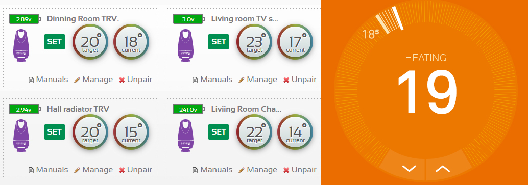

I am told one sets up the lock shield with a differential thermometer, I do actually have one, but unfortunately don't have the sensors at the moment to use it. So the 15°C sound good across the radiator, but in practice simply can't measure it.

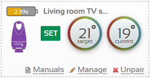

The TRV reports to the PC,
so if the current exceeds target I close the lock shield a tad, and in mothers house with a modulating boiler, after a little time trimming the lock shields, the rooms were spot on.
However my house uses oil, which is on/off, it does not modulate, Heating not keeping up.jpg I have tried to adjust the lock shields, and to be frank it has not worked, I have opened the lock shields far more than I think they should be, and with 9 programmable TRV's I am not really getting the control I want, I think the micro bore is putting enough resistance on flow so all radiators work, and no need to guess what 20°C is, it is actually written on the TRV in °C not silly *123456, but I can hear the boiler cycling, but rooms not up to temperature, and the wall thermostat in the hall is a bit useless, as hall is slowest room in the house to cool.
