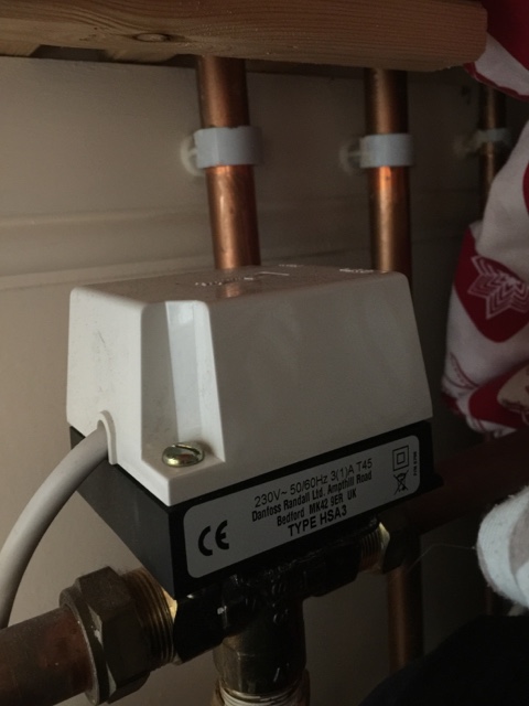

I'm staying at my sisters and noticed that the hot water heats up for an hour in the morning & at night which is is normal.
But
At the same time I've noticed that the radiators also get hot.
Water goes off and then the radiators cool down until the water heats up again later on.
Is the item shown in the supplied photo at fault or please advise.
Thanks.
Is there any way to test or eliminate it to see if when the hot water comes on the radiators don't etc.
Sounds like the valve or valve motor is faulty and not shutting off the central heating side of the system, assuming the heating and room thermostat are switched off.. What are the heating times and room thermostats set at? Is that valve set manually open?
Let the system go cold, then turn on for hot water only. Touch the pipes coming out of either side of the valve to see whether it's one or both that are getting warm
A 3 Port valve when at rest, is pulled by a strong spring to the 'hot water' only position, (i.e. the central heating port is closed) and they are driven by the motor to the 'central heating' position, so it would be unusual for them to fail and produce the symptoms you describe.
Although rare, if a mechanical fault has occurred such as the spring breaking, or a foreign object is blocking the central heating port so that it doesn't close properly, what you describe may happen. Sometimes though installations have been altered or modified wrongly which has created faults, or even wired incorrectly from their installation and so have never worked properly.

I'm assuming from your description, that the heating isn't set to be 'on' and the radiators are just heating up when 'hot water' is selected. So, is it possible that the valve's manual lever has been moved and latched in the open position?
Just to answer a piece of advice given above.
I touched the 3 pipes that the valve is connected/sat on when the hot water wasn't heating up. It was say slightly warm 3/10.
Around 6 when the water heats itself up I gave it 10 minutes before I went and touched them. This time a lot hotter say 8/10.
The model of the valve is Danfoss HSA3
As I look into the airing cupboard the writing on the top of the valve is at the top rear of the case.
It then looks like Man is in the left & Auto is in the right. Now you mention lever etc I can feel but not see which I think is a flat metal bar over to the Man side.
Well, switch it to auto then and see what happens. Is this a wind up?
I wrote this the other day. ".....Is that valve set manually open?"

Moving it to auto will (if the valve is working) give you hot water, heating or both at whatever times the programmer is set at and only when the controlling thermostats (room and hot water cylinder) demand it.
