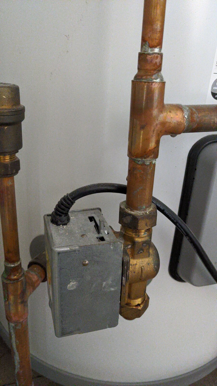

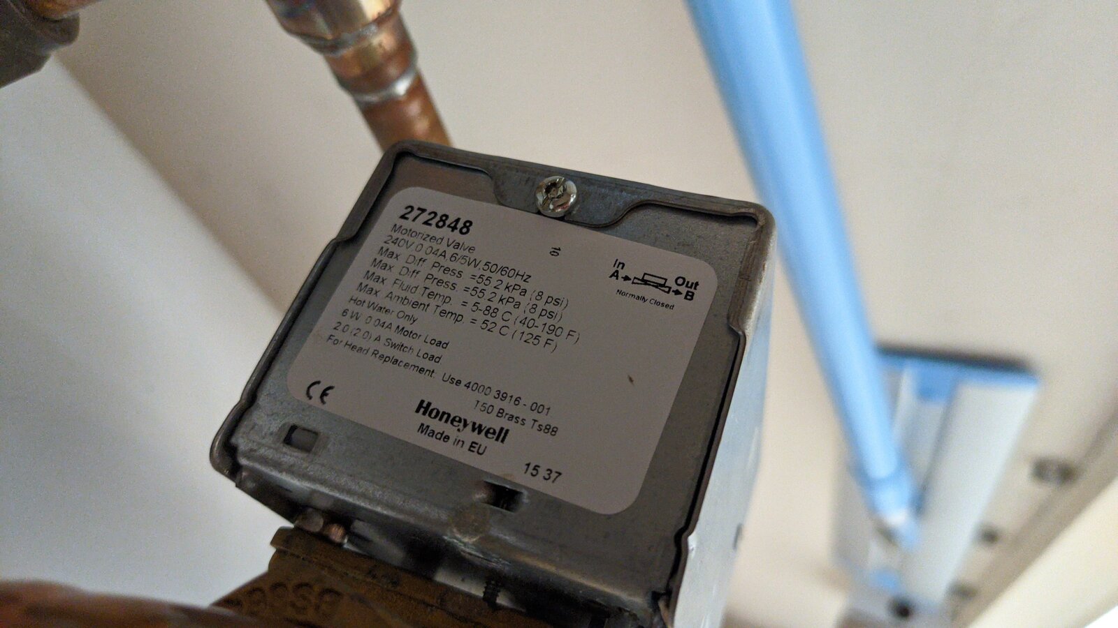

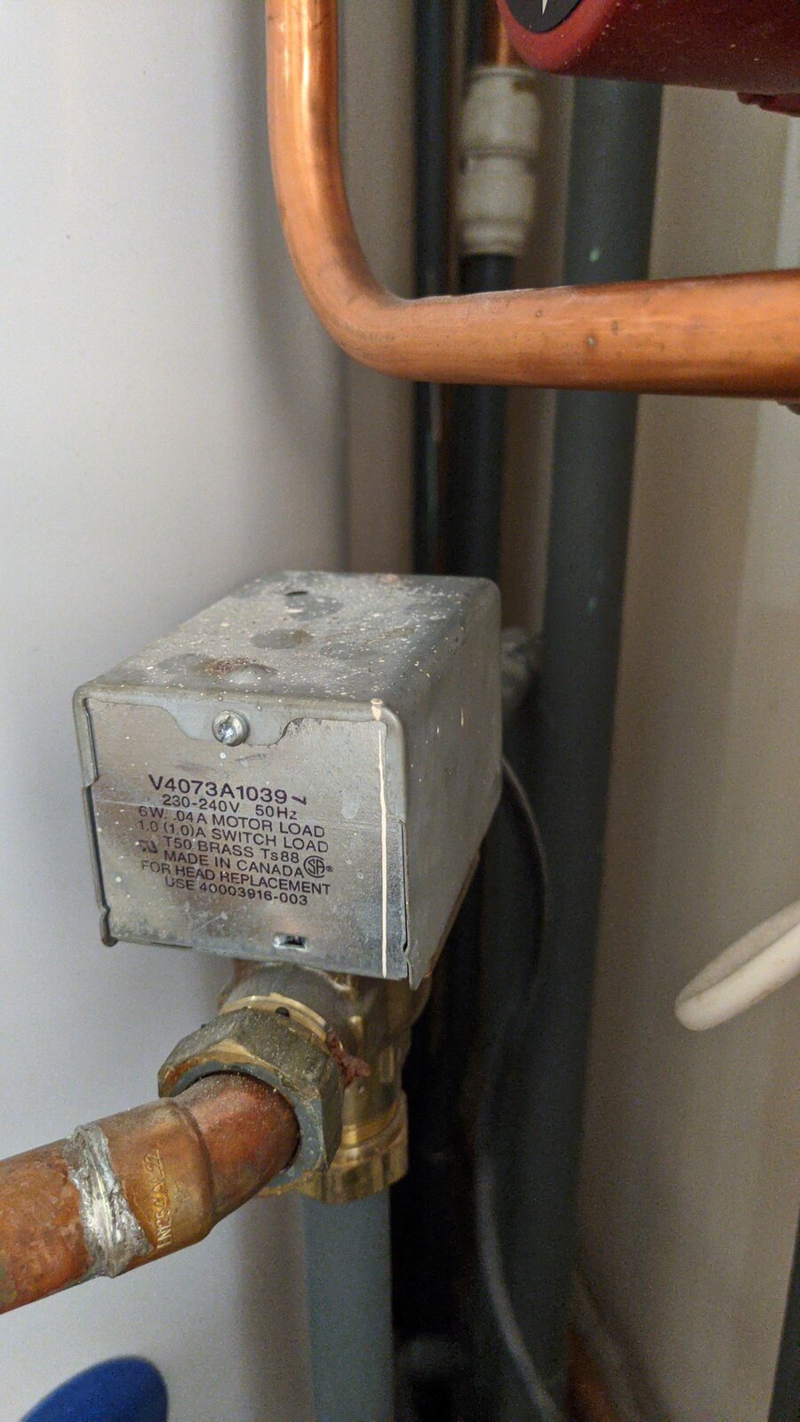

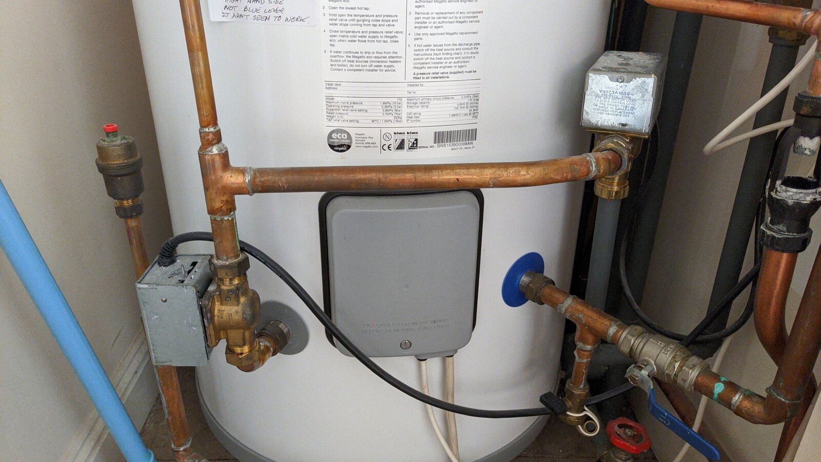

May be able to change the Valve head over without touching the water side of things. What Manufacturer is the valve and are you competent working with Mains Voltage electricity? Some pics may help.
Hi Hugh
Here's some photos. I didn't think I'd be able to replace the entire valve but I could have a go at the motor. Is it likely to be the motor though and not something gone wrong inside the valve?
