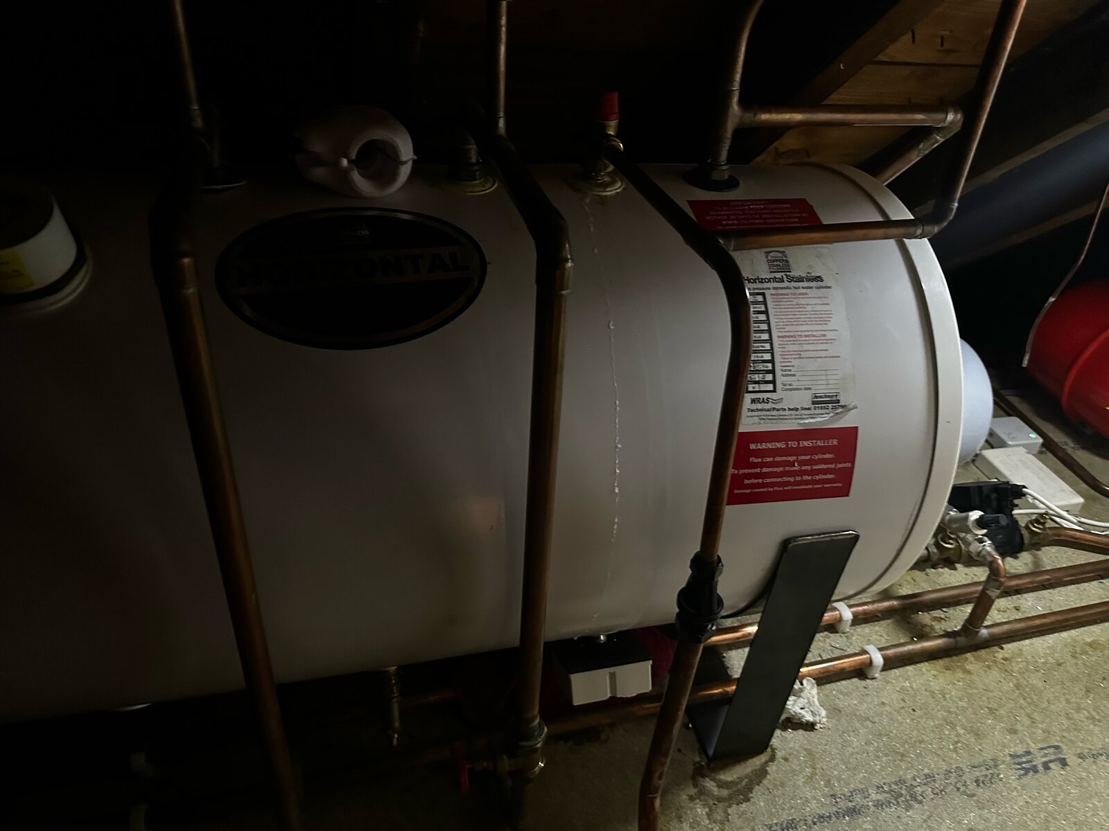

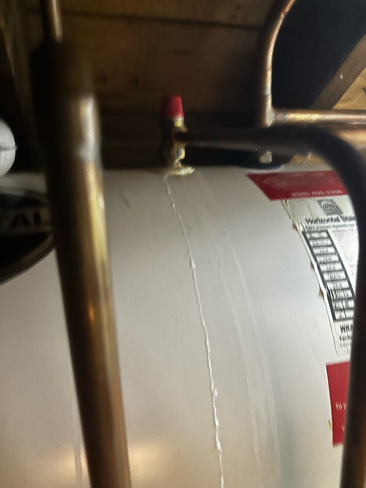

The installers are now suggesting that the valve (where the leak is coming from) is changed rather than the whole cylinder but not even offering to do that. They obviously lost their shirt on this installation and are trying to avoid any other cost, at all costs.

Having been on-site and seeing the fault with the cylinder first hand we have clarified with Mr Macleod that it is not a workmanship issue. The fault is with the cylinder, due to only being 6-7 months old - revert to manufacturer due to being under warranty.
I would prefer Mr Macleod deals with yourselves/manufacturer direct with regards to who is paying for the labour and disruption to the property as it is totally out of our hands.
As previously mentioned there is no requirement to change the full cylinder. The PRV that you have described being glued into position from factory is where the fault has been identified. How Telford decide to get this sorted would be something Telford should be exploring as opposed to sending out a new cylinder which is not feasible.
From our side, it is clear that this is a defect on an item that should be covered under warranty and down to the company to explore all options to find a suitable outcome for the customer.

If its just now leaking from the prv tapping then its a twenty minute job to rectify and still their responsibility to resolve . Have you ****ed them off ??

Having one of our engineers on-site and identifying the fault with the cylinder PRV we believe that it would be a more feasible option for Telford to make a warranty call to replace the PRV.
Telford have made us aware that the PRV is factory fitted into position and would require a process to replace to prevent further damage to the tank.

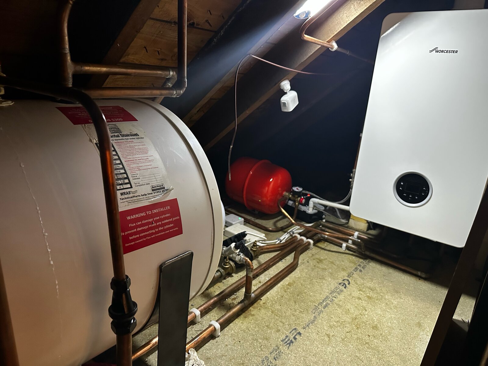

There is absolutely no requirement to change the full cylinder as it is not feasible. Telford will not cover the labour costs to remove the existing cylinder out off the attic nor cover the cost of a joiner to allow access to get tank out and also installing a new tank. The process of getting the tank out of the attic without causing damage to the property should also be factored.
From our view, it is clear that the tank has a malfunction on the PRV valve and should be covered under warranty and down to Telford to explore all options to find a suitable outcome for yourself.

If its just the PRV I can't see what all the fuss is about. Let Telford change the PRV or let the installer change the PRV if thats all that needs to be done.

Telford initially said the cylinder needed to be replaced because they could not tell if there was an internal issue as opposed to the PRV leaking.

The PRV is wound into the cylinder in the factory with a liquid type sealant (glue). Sometimes these connections take a bit of a battering in transit or possibly manhandling into a loft using the prv as a handle.
It sounds like the installer is ****ed off due to the job not going well etc (we don't know the full details). To be honest its still their issue to rectify either via Telford or by their own labour. Telford do have engineers or agents they use for in warranty repairs, so you should be able to get this resolved.
