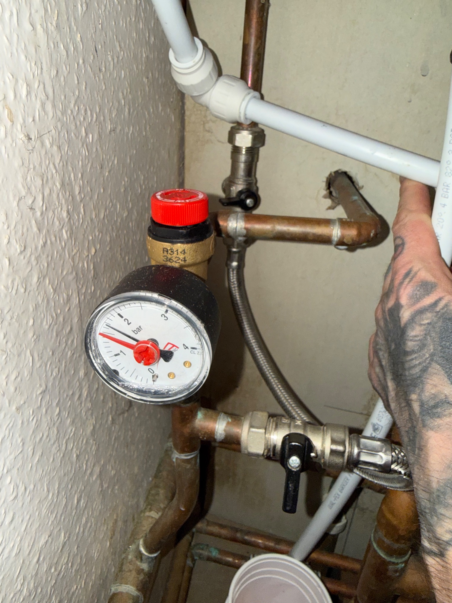

Are you certain that you are checking the actual PRV and condensate pipework ,show us pictures of those 2 pipes.
Something is amiss here ,if you are losing 0.5 bar pressure continually, hourly ,water has to be going somewhere .
If you are losing pressure when the boiler isn't being used ,and nothing is coming out the boiler,it's condensate pipe,or the PRV's discharge pipe, that's indicative of a leak on the system. Is there any heating pipework buried in concrete flooring ,or a void under the ground floor?
I’ve filled it around 6 times now and pipework in the walls/ceilings would be very obvious. It’s a Maisonette too, so I don’t have pipes in the ground. Boiler is on the 1st floor.
absolutely certain. I can see the condensate pipe at the bottom of the boiler, it goes straight out the wall underneath and that’s an outer wall. Same as the prv, which I’ve replaced.
There must be some old pipe that’s connected to the system somewhere doing something is my only guess. I had a leaking prv and bottle trap, replaced both of those and the pressure was holding. Now it’s worse than ever.
If I can’t find water, which I still haven’t, I’ll blank off the last two rads on old pipework at the boiler and just run fresh instead. Just baffling there isn’t any water anywhere.

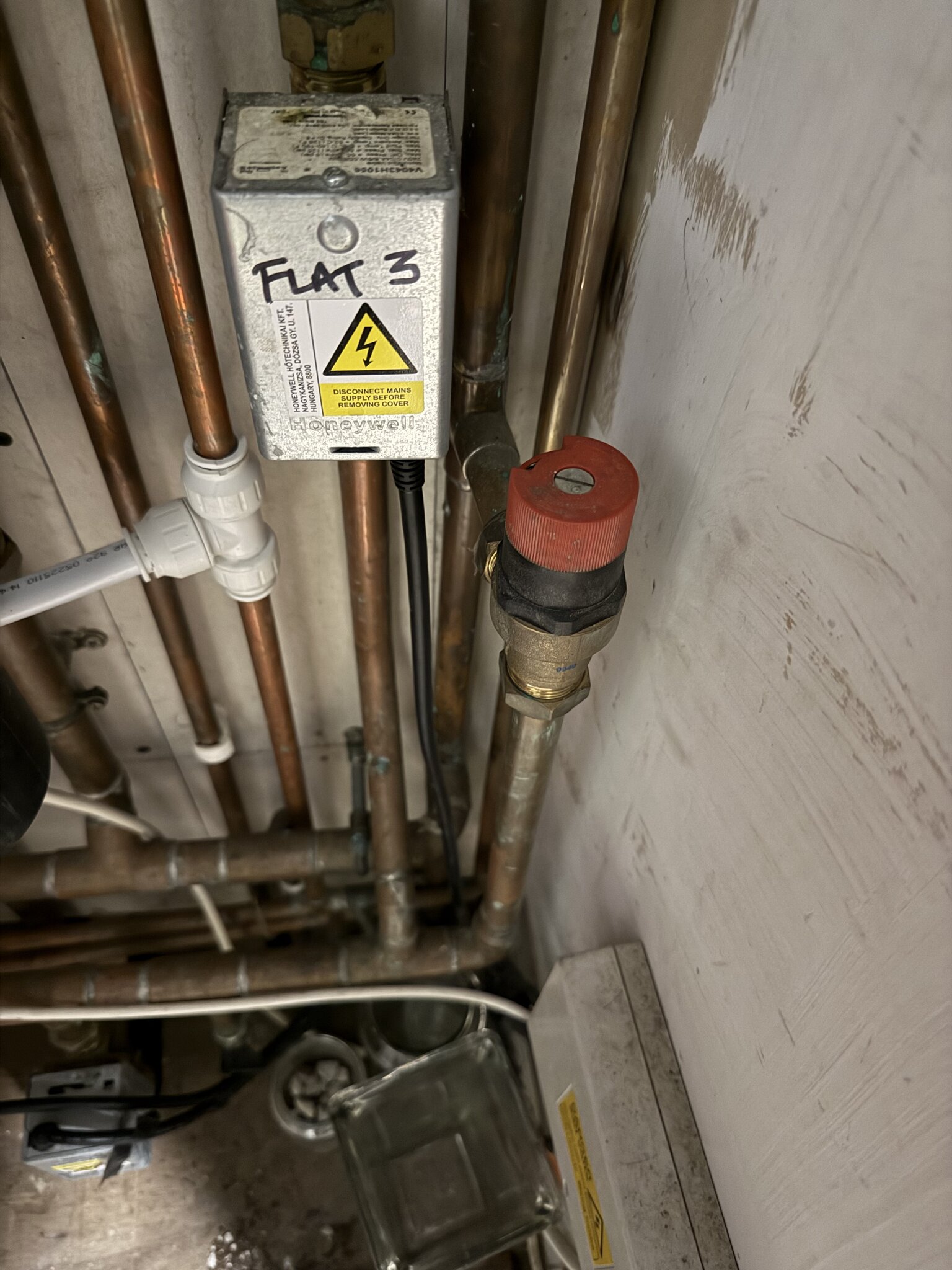

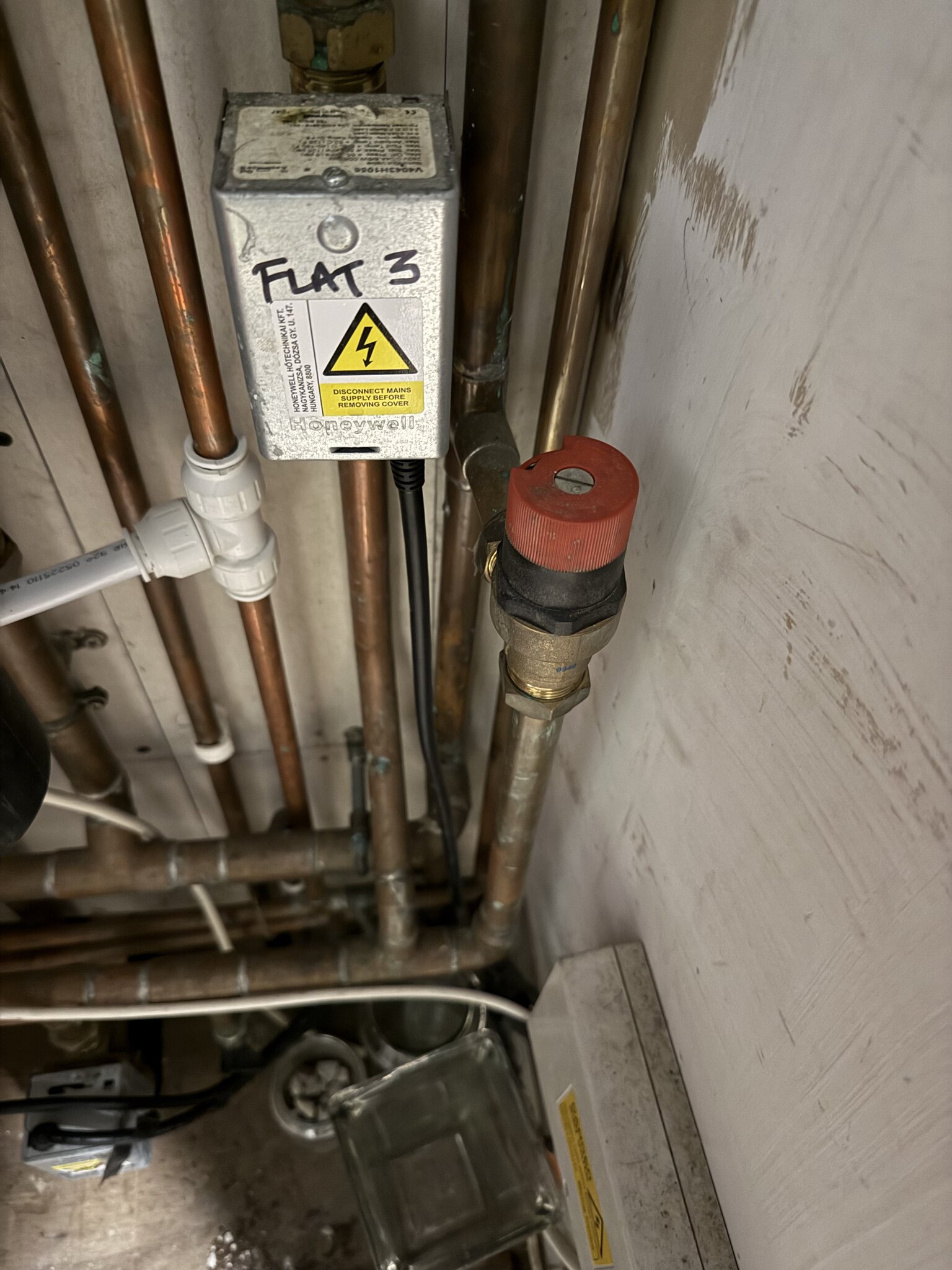

I do have this pressure valve also. But I can’t unless I’m being stupid see how if this had failed I’d be dropping pressure like I am.

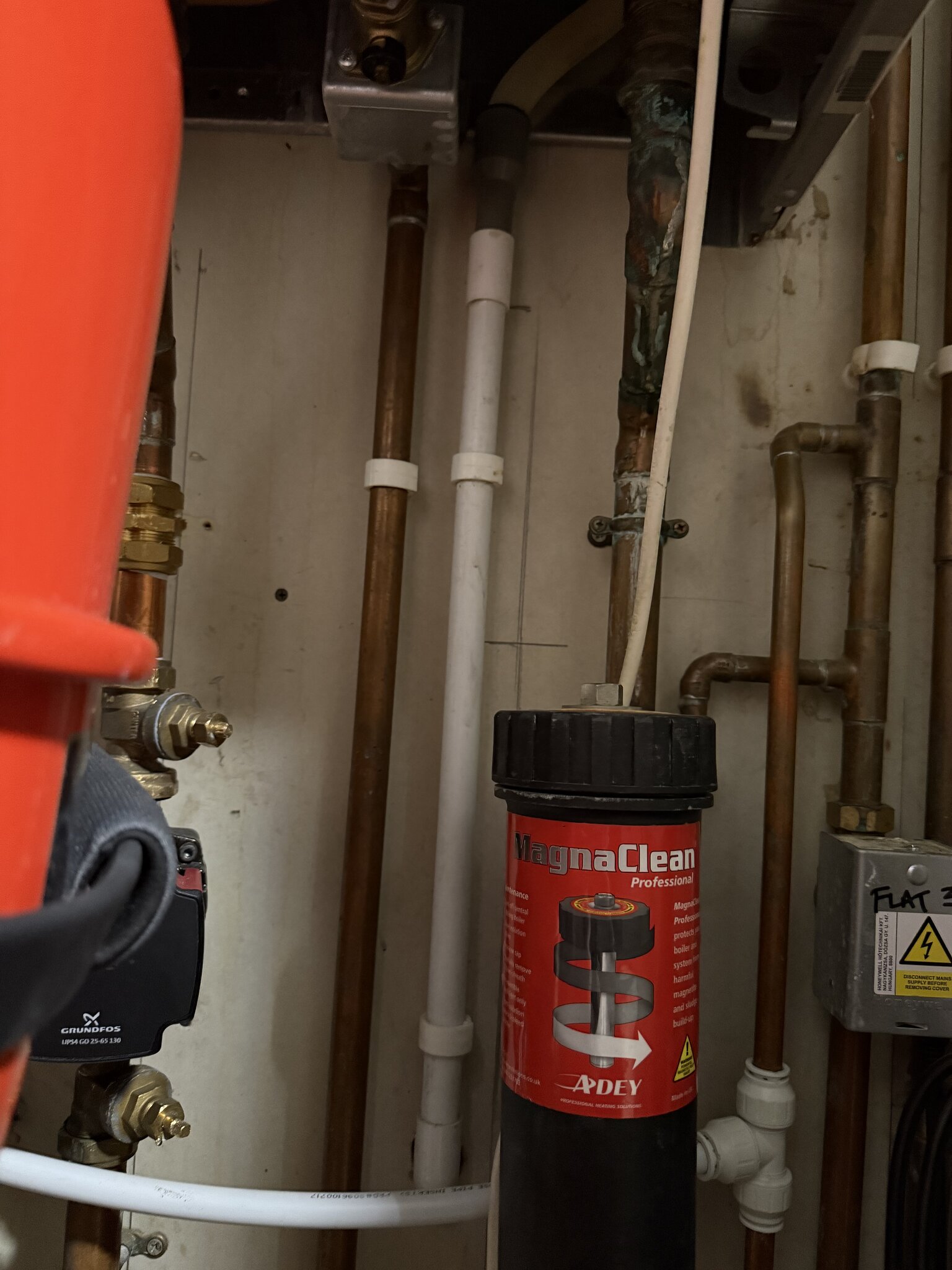

Pressurise the system to approx 2.5 bar, Isolate the boiler flow and return and unisolate the boiler after a period of 8 hours. If it drops before that it's the boiler, if it drops after that, it's the system.
After isolating the boiler at the pump and the magnet cleaner. The pressure has dropped to zero still.
That point to a system issue then, not the boiler, must be somewhere that you can't see. Do you have a drain cock on the outside somewhere?
Very strange. The hot pipe goes straight up to my office, so water would be coming back into the boiler cupboard if leaking. Then across to one other rad, but again by now I’d have water through that small section, as it’d be near 10trs now at a guess.
No the only drain is in the cupboard. It is still full of water, just not at any pressure that’s noticeable on the dial.
If there was no passing of the valves, and 1 is flow and 1 is return, then imo that points to the boiler, or did it drop when you opened back up?
It dropped whilst these valves were closed off. I closed both the magnet ones which is the cold feed in. Then the valve on the pump. So it was isolated. I haven’t opened it back up as the gauge is on zero now anyway.
