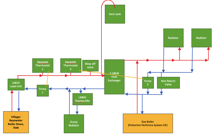

Hi, I appreciate that this is an old post, but we are considering something similar, but have more space than Russel. This diagram does not include any woodburner help to assist with the hot water, simply to interface for central heating. We'd like a thermal store / buffer tank too, but I think that it is eye-wateringly complex unless we put it in the attic - where we don't really have space.
The yellow boxes are the heat sources (wood burner and pressurised gas boiler); green are the facilitators; pipes are colour coded; electrical connections are yellow (e.g. thermostat 1 to pump 1).
Will this work? Thanks in advance.
