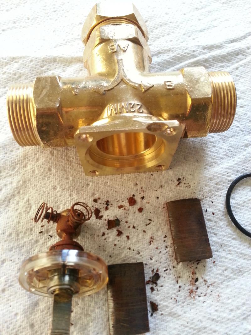

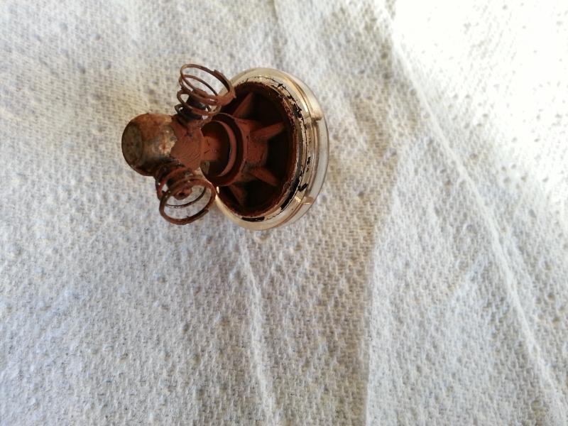

In the end I didn't (couldn't) remove the 3-port valve body (stiff nuts) but I replaced the sticking spindle.
View media item 76974
View media item 76975
You can see the rust encrusted spindle and PTFE "shoes" which look quite worn and as I thought, the new spindle moves freely inside the valve body. Consequently the boiler hasn't had any flashing LED standby issues (because the actuator couldn't move the crusty old spindle).

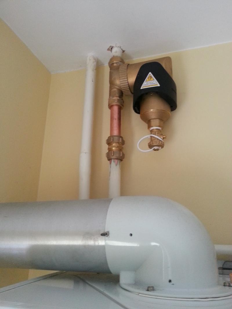

The Spirotrap filter is fitted. It was impossible to squeeze it in to the pipe cut-out above the boiler because of no flexibility / movability with the pipes, so I had to get a straight coupler and some copper pipe to fill in. I just need to sort the plaster that's come away from the ceiling around the pipe, or fit pipe insulator (?)
View media item 76976
System refilled with Fernox MB1. I've got red hot rads and very hot water!
