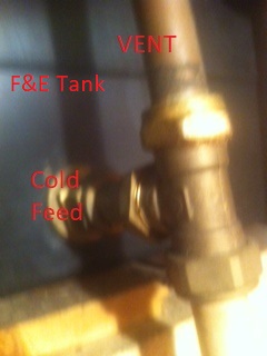

You could write a small book on vented systems that start drawing air in/vent pump over when a circ pump or new rads are installed or pump mode/speed changed/increased and the systems are perfectly clean, its quite simple to convert these systems to combined vent and cold feed which in my experience will almost guarantee 100% success, I have even seen systems with the much vaunted VCP system (Boiler) Vent, Cold feed, Pump, with the above problems "cured" by converting to the combined vent and cold feed, my > 50 year old system was installed in this fashion and some of my rads are > 40 years old, the system is absolutely spotlessly clean with only the odd drop of inhibitor added over the years.
