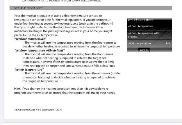

Hi all.
As the title suggests. I've recently been gifted a couple of really nice looking full colour screen underfloor heating thermostats (for the wall) and I was wondering if I could connect a fixed resistor across the floor sensor probe terminals to stop the 'stat error messaging through lack of probe being installed and just use the air temperature sensor in the 'stat body itself ?
Also, the normal output is L and N for the heating element so do you think it would be possible to just connect the live out from the 'stat into the CH CCT (to use as a switched Live) or would it be better to connect a relay across the L and N terminals to switch the Live remotely ?
Thanks for any advice :)

Thanks TTC. The 'stats are warmup 3ie models. According to the manual, they will work without a floor probe attached but they give an error code. They have got the function to just use the air sensing option hence my question about replacing the probe with a fixed resistor.
All I'm concerned about really is whether or not it would have to be a resistor that could dump some power as I can't seem to find out what voltage the 'stat would use while monitoring the probe values.
Does my idea re: the switched live situation sound OK ?
select set Heating Target in the menu
If no probe installed, you may get an ER1 Error code. You should be able to clear this by doing a reset.

Well, it seems like the resistor is not required after all ;)
I'm sure you prolly already know this but in the settings you can set up the floor type to "user defined". Once I did that and then told it to just use air temperature it didn't show an error message so all's good. :mrgreen:
It does just switch the L as well without having to link anything. :mrgreen:
