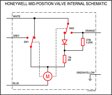

It seems likely a micro switch in the valve head has failed or stuck in, it is not really an option to renew the soldered in V3 micro switch, you would normally replace the whole head because of the complex internal wiring mid-position-valve.jpg it is not easy to test, the 5 wires have a reasonable universal colour code so I suppose you could DIY the swap, and if same make as original often the valve and head clip together so you can change head and leave the valve plumbed in. It is 230 volt so of course need to ensure dead before working on it.

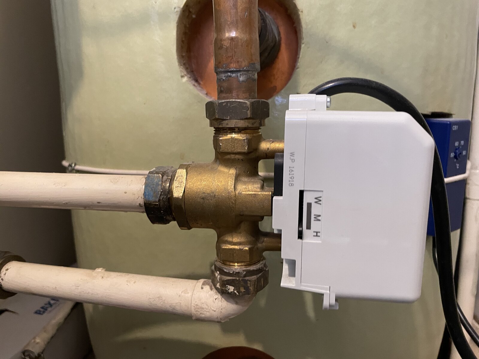

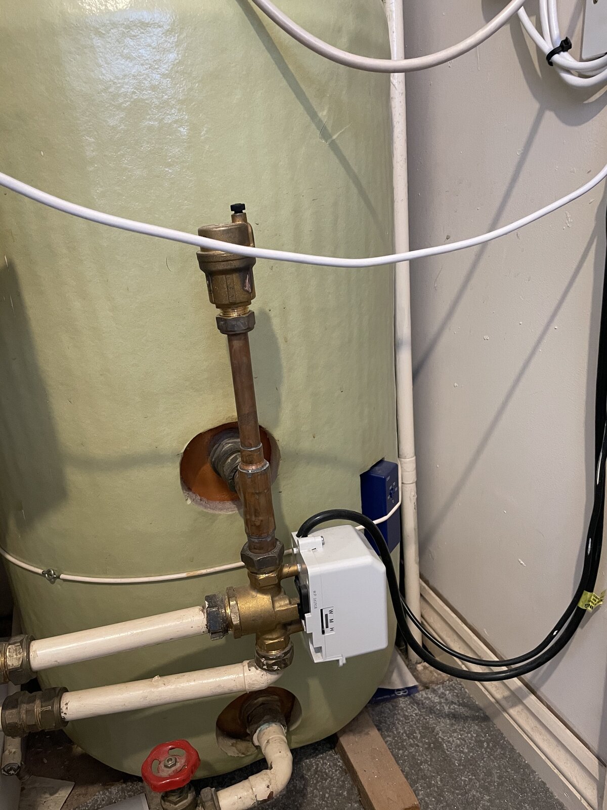

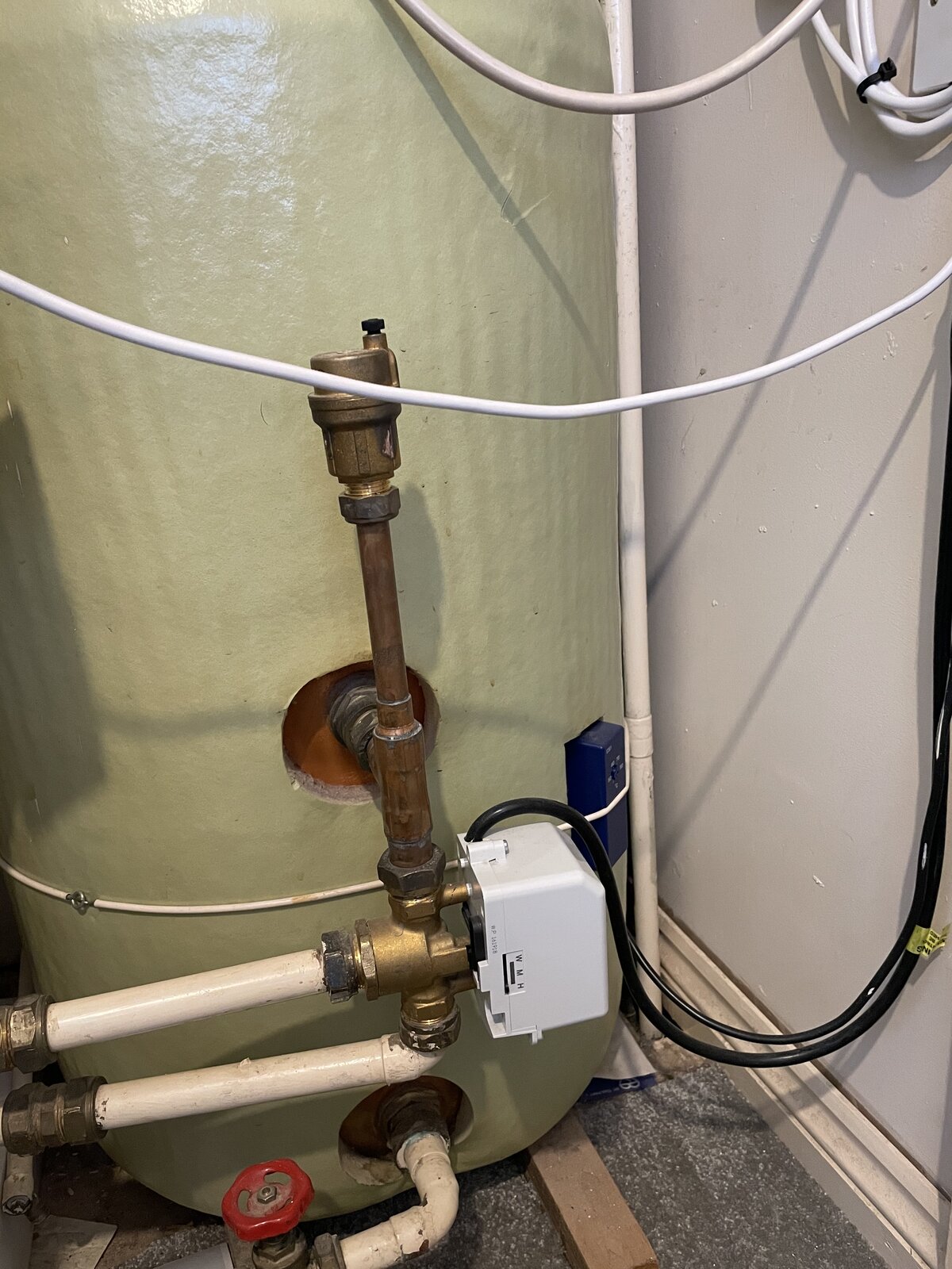

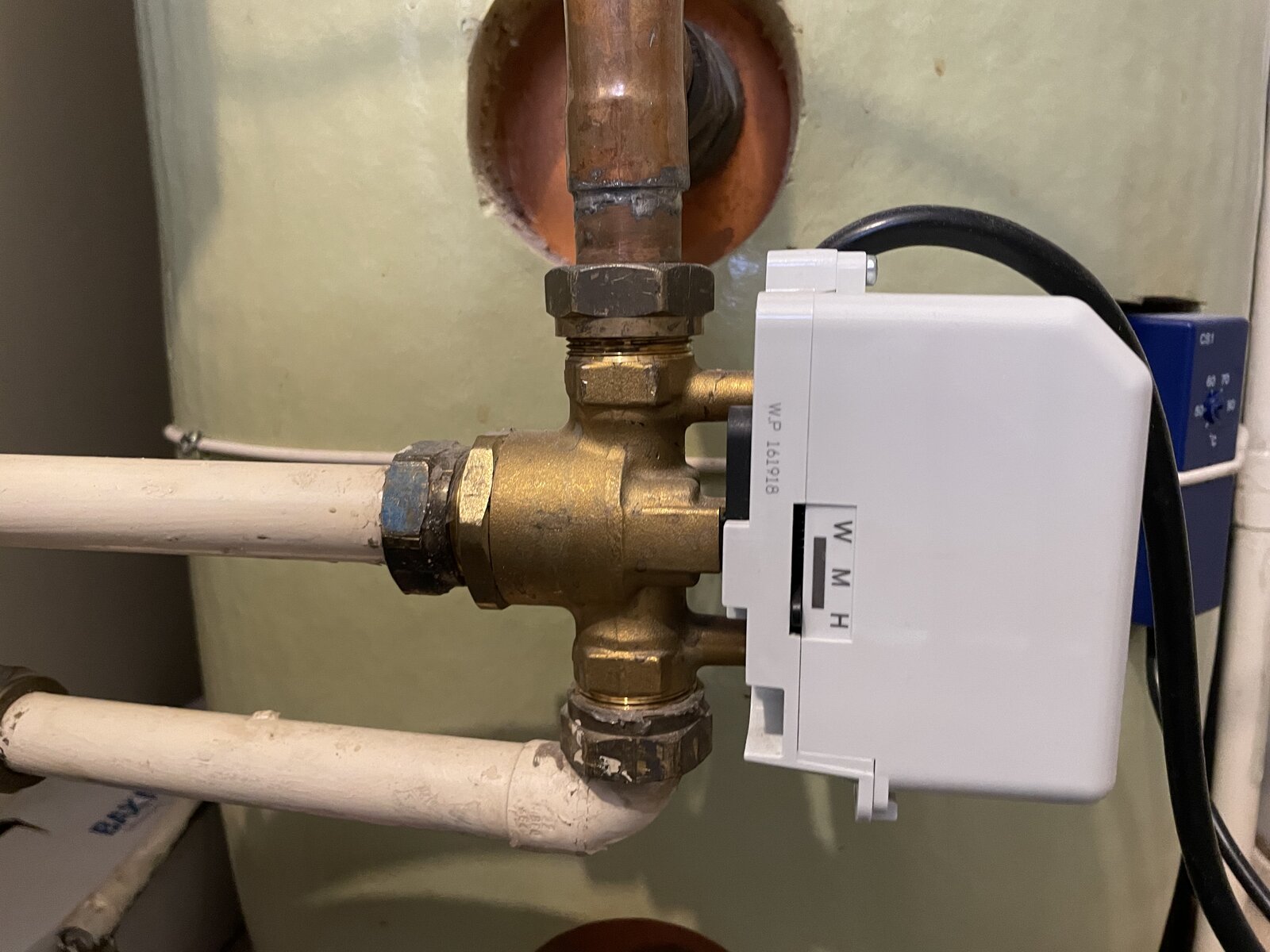

Here is a pic of the valve in case that helps at all?
Thats a Drayton valve. The white actuator head just clips off the brass body ,no plumbing work to do . A replacement just clicks into place. It comes pre wired cable attached already. You could unclip it ,make sure the spindle moves freely in the brass body. If it does, then fit a new actuator .
