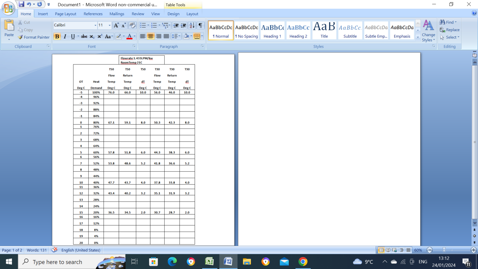

A flow temp of 55C will give a rad output of 56% of its rated output (T50) but a heat pump (if/when installed) obviously needs to run at the lowest possiblt temperature to get a maximum COP, if the HP is run at 45C then you might get DHW at 38C/40C with boosting to 60C only required once/week for legionella protection, the rad output then will be 37% of its rated output, a flow temp of 50C will give a rad output of 46% of rated output.
So based on those figures will the OP need radiators roughly twice the output of the existing ones?
Correct, T30s, the attached will give some idea of what might be achieved with rads that were originally sized for -5C outside temperature, with a required room temp(s) of 21C, of course in lots of cases the existing rads are oversized anyway but hardly by a factor of 2?.
