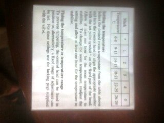

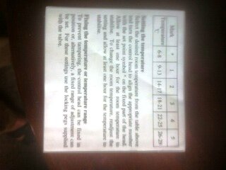

In another room, the TRV is set to 5. One side is 48C and the other just over 43C.
TRV setting of 5 means its wide open, see below, I set mine to ~ 2.5 to 2.8ish to maintain 20C room temp
The mean rad temperature is 46C

Don't know where you got that information from, TRVs are proportional controllers with a very small hysteresis of ~ 2C, so as I pointed out before, as long as they are not fully shut before the rad return temperature falls to the room temperature then they control quite well, at least mine do in the 30+ years I'm using them.
At the moment there is only about 5C difference between flow and return temps at my radiators and this sometimes reduces to nothing. Makes no difference what setting the TRV is at.
I can only suggest they are not working properly, if the boiler is under any other form of control ie one room with a on/off room stat that has a big hysteresis where the boiler is off for long periods then this will tend to cause the TRVs to operate in a on/off way but will/should give fairly reasonable room temperature control but as stated previously its vital that they are set up properly, I would think that yours, in that room you are talking about shoud be set around 2.5, then only adjust it + or - in 0.2 index increments, mine are set for years at the their same setting, as the days slowly get colder and colder in the autumn then the rads will start just barely lukewarm and gradually increase in temperature as the days march on.
