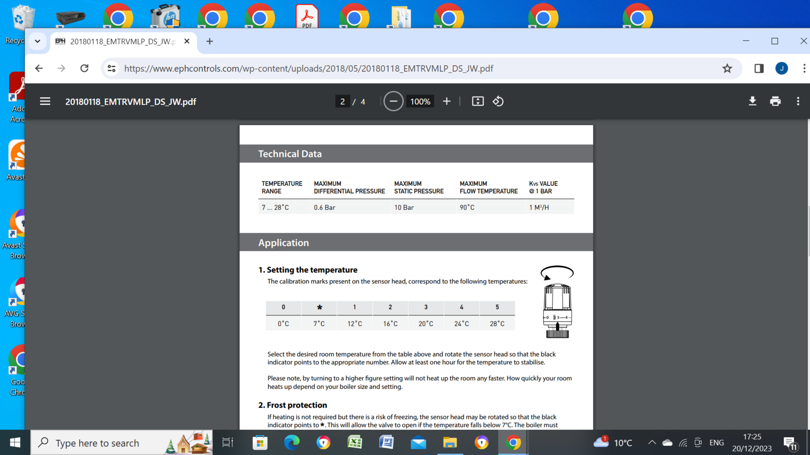

OK chaps, relax, At tremendous expense I went back through my spreadsheets where I keep everything including my last and latest will.
The EPH TRV Kvs is 1 m3/h @ 1bar. (see later)
I had also taken some readings from a outside tap that I can feed from the CWST at 5.5M, 0.55bar.
Index 1.0 flowrate 3.0LPM
Index 2.0 flowrate 3.8LPM
Index 2.5 flowrate 3.9LPM
Index 3.0 flowrate 3.9LPM
Index 4.0 flowrate 3.9LPM
Index 5.0 flowrate 3.9 LPM (full open)
So once index set to 2.5 or > then flowrate at its max.
My calcs give a Kvs of Sq.root (1.0/0.55)*3.9*60/1000, 0.3155m3/h @ 1bar, quite low vs the claimed 1.0 m3/h @ 1 bar, I can't say that the head stayed at 5.5M while testing but it would have had to fall to 0.55M if the Kvs is 1.0. I reckon the head was still 3.5 to 4M at those flows so the KVs seems more like 0.534.
I also, just now, did the same flow test with the companion L/S valve from that TRV and it flowed 3.6LPM @ "5.5M", very close to the TRVs flow rate?.
Based on the above, a 1.5kw rad with a dT of 15C requires a flowrate of 1.43LPM and the head loss through the TVR and through the L/S would be ~ 0.74M each, total of say 1.5M, how does that sound??.

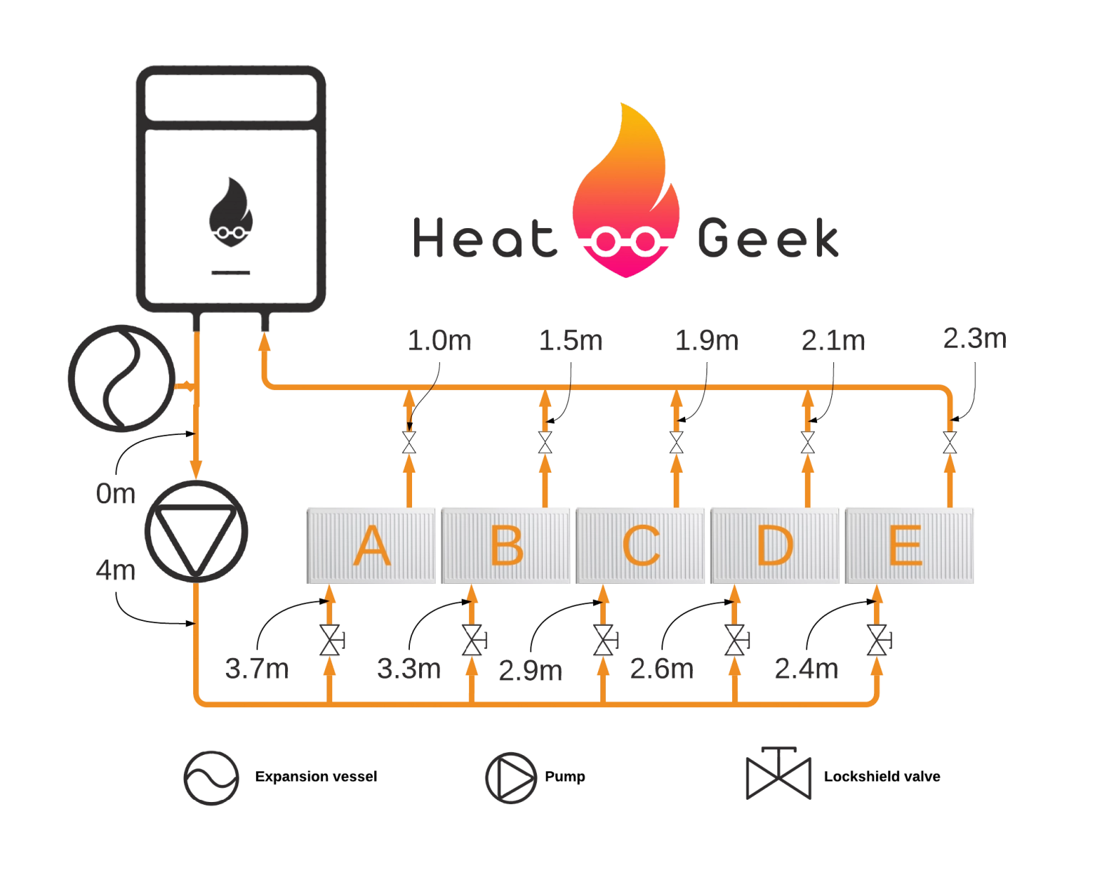

Didnt realise this was so controversial. Balancing ensures efficiency and uniformity. Assume a 22mm supply and return, with rads coming off in 15mm, occasionally supporting up to 3 rads.
You have a varispeed pump. These are desinged to maintain a constant head as rads open and close.
You then have a massive double panel radiator which is closest to boiler. You cannot be bothered to balance it, becuase it is, of course, twaddle. So at the first supply/return point on the system, you get a hugely hot radiator with minimal temp loss on the return.
Water returning to boiler is therefore hot, so boiler either cycles, or adjusts its output.
Radiator farthest from the heat source therefore gets lukewarm water, and doesnt heat up properly. Repeat this over 10-15 rads and the system simply will not work..radiators of random temperatures.
So:
Balance closest radiator to heatsource with trv fully open. Adjust lockshield so temp drop about 11 or 12c. Lockshield will likely be only slightly open. Repeat process for other rads...the one farthest from the heat source will likely have its LS fully open.
So we balance so that flow and return temperatures are about the same on each rad...if a particular rad is either off or closes down becuase it has a trv of somekind, the system remains in a steady state...the variable pump will reduce the output head based on flow resistance.
So you can either do it right, or approximate ( futher from heat source, LS more open), or not bother.
Not bother = inefficient system that wont work properly.
Entirely your call.
Correction here as I found my pressure gauge and also found a valve throttling the gravity supply which I opened for the test so these are the actual corrected flow tests.
Index 2.0 flowrate 6.8LPM
Index 2.5 flowrate 7.1LPM
Index 3.0 flowrate 7.1LPM
Index 4.0 flowrate 7.1LPM
Index 5.0 flowrate 7.1 LPM (full open)
Companion L/S valve very similiar.
The dynamic head was 3.0M, 0.3bar.
My calcs give a Kvs of Sq.root (1.0/0.30)*7.1*60/1000, 0.78 m3/h @ 1bar, not far from the quoted 1.0 m3/h @ 1 bar,
Based on the above, a 1.5kw rad with a dT of 15C requires a flowrate of 1.43LPM and the head loss through the TVR and through the L/S would be ~ 0.12M each, total of say 0.24M.

The amount of twaddle in this post demonstrates that the industry and its agents should do a bit more studying.
That confused me till I realised your sq root only applies to (1.0/0.3), not 7.1*60/1000. But shouldn't it be 7.2?
Presumably the 0.3 bar is the pressure drop across the TRV (not sure what you mean by dynamic head, that's usually V^2/(2*g))
the head loss through the TVR and through the L/S would be ~ 0.12M each, total of say 0.44M.
Not with you. If it's 1.2 each isn't that 2.4m? Earlier you said 3m = 0.3 bar across the TRV, unless I'm misunderstanding you test.
