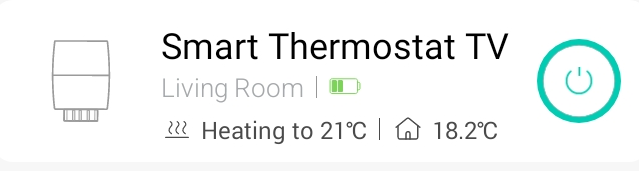

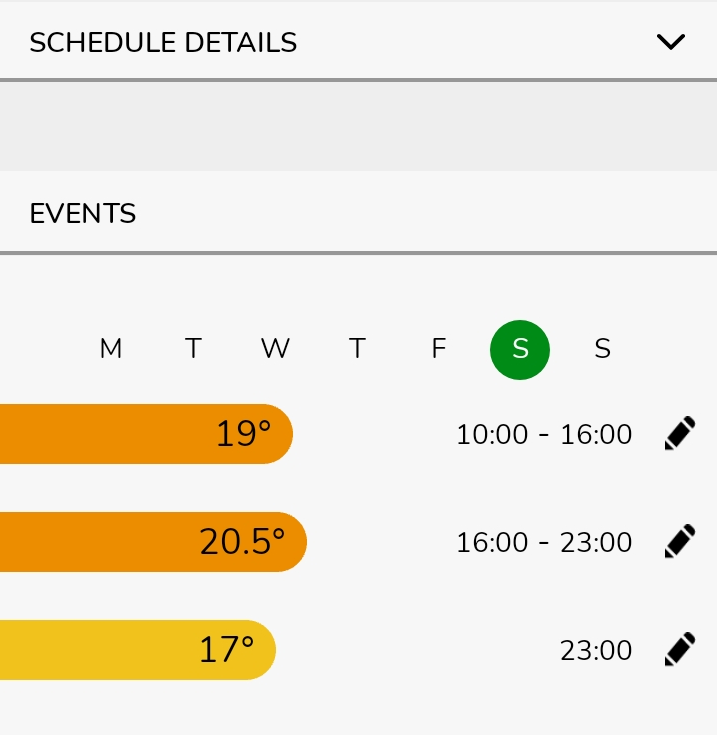

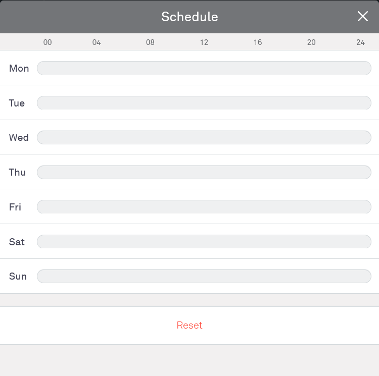

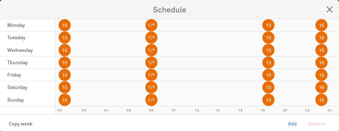

In winter we have the DHW always set to off. 1733592167424.png we have the CH 1733592225314.png set to different temperatures through the day. 1733592453944.png Two thermostats on in hall and one in living room can turn on the boiler. However even it the thermostats did go haywire and fail to turn off boiler, the TRV heads would stop the rooms over heating 1733592669169.png I have three different types of TRV heads, showing the Kasa, but what ever happens to the boiler controls you can't over heat a room, as the TRV head will turn off radiator, you would need multi faults to overheat a room.
