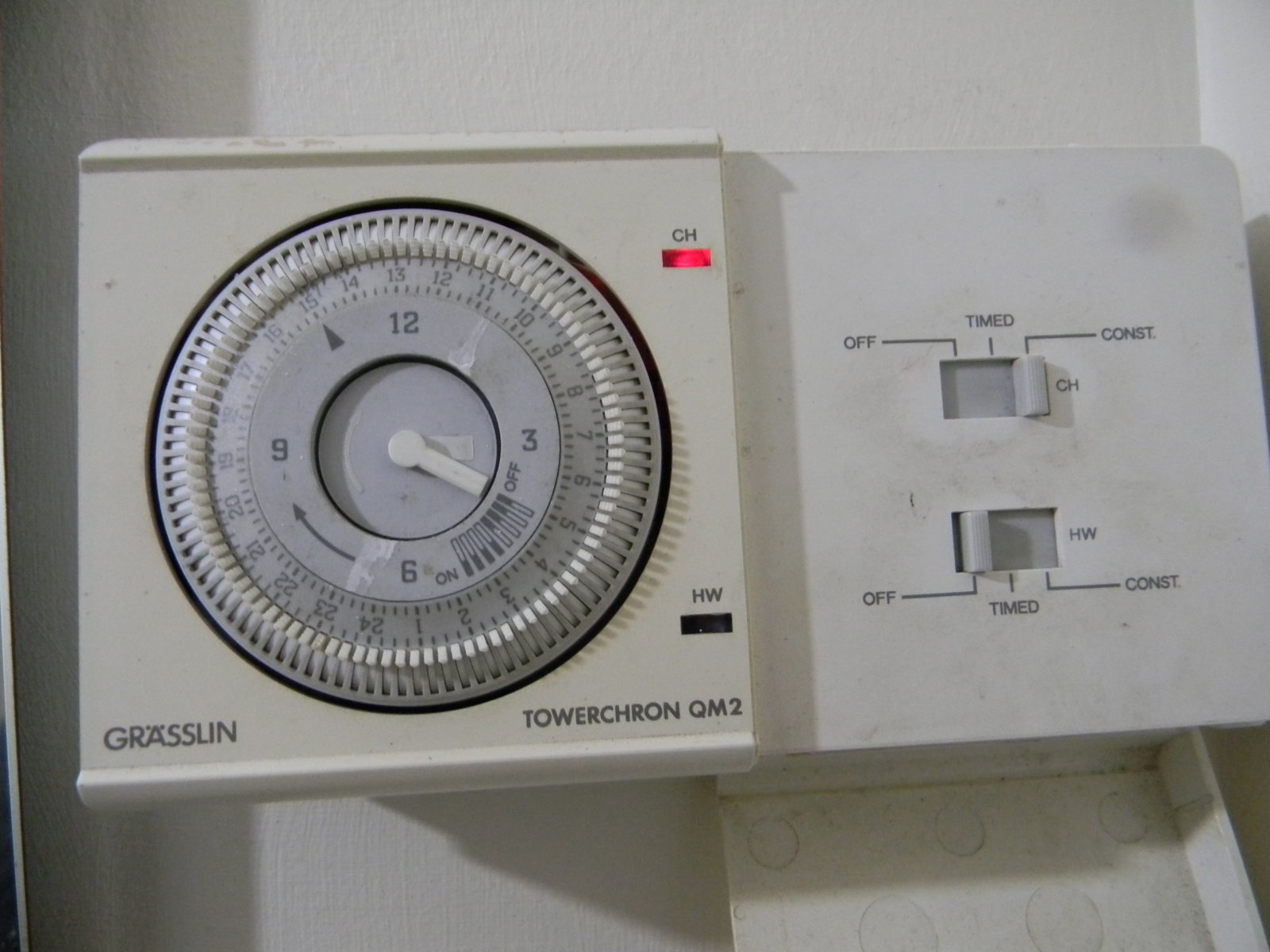

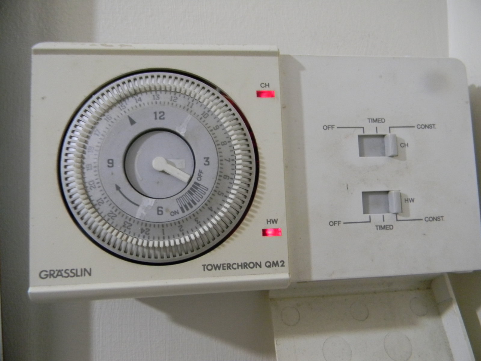

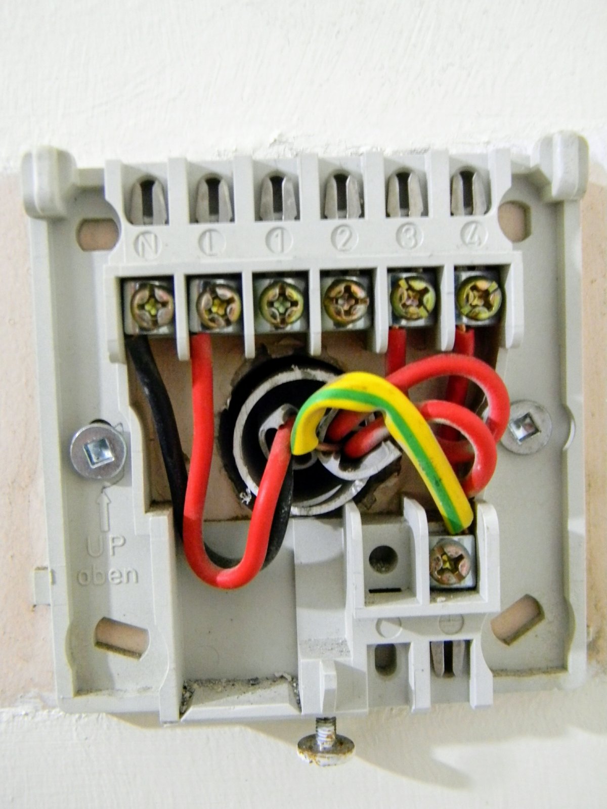

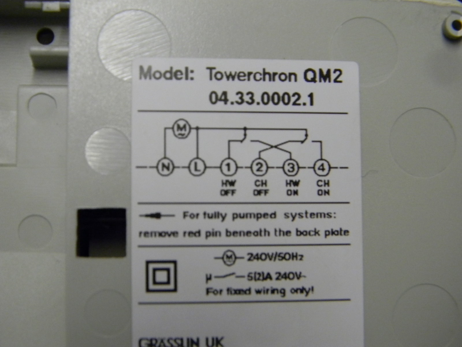

Hi, I would like some advice on why my CH will only come on when the HW is turned on at the same time? However the HW will work when turned on it self! Is there a problem with the switch or wiring or a problem somewhere else on the system? I have lived in the house over 5 years and this is the way it has always been. Any help appreciated. Thanks

you have a pumped CH and gravity HW circulation system , that is how it works , you cant just change the programmer , you will need to add additional controls and probably alter some pipe work
