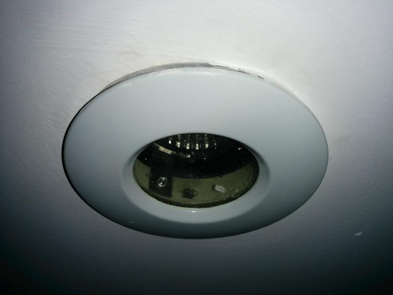

I've been looking for a wire clip on the fitting to remove the bulb but can't find anything to release it. I've tried pushing the glass (nothing), turning the glass (nothing) and not sure how to get to the bulb. Any ideas?
Please see attached photo.
firstly is the hole big enough for the lamp to pass through, looks like it might be the type where the lamp sits on a metal spring ledge and the opposite side has a metal spring, you push that edge in and the lamp tilts and out.
If the hole is smaller than the lamp then the bezel may pull or twist off, some fittings actually need removal from the ceiling to change the lamp, but not so common these days
The OP describes pushing/turning "the glass". Is there a glass cover in front of the lamp? And is this in a bathroom? Sounds like it could be an IP65 bathroom-rated fitting, in which case it is probably the bezel - the white plate that fits against the ceiling - which needs to unscrew. Worst case is you may have to lever the entire fitting out of the ceiling, which usually leads to collateral damage of the plasterwork round the hole.
[edit] Now I've enlarged the picture I can see it is an IP65 fitting - try unscrewing the bezel[/edit]
