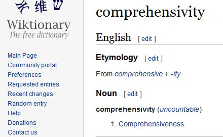

Even Americans don't say comprehensivity. :)
Doesn't that mean that it must be correct? :)
Mind you, albeit not the world's most authoritative dictionary ....
Kind Regards, John

The Concise Oxford has "comprehensiveness" but not "comprehensivity".
