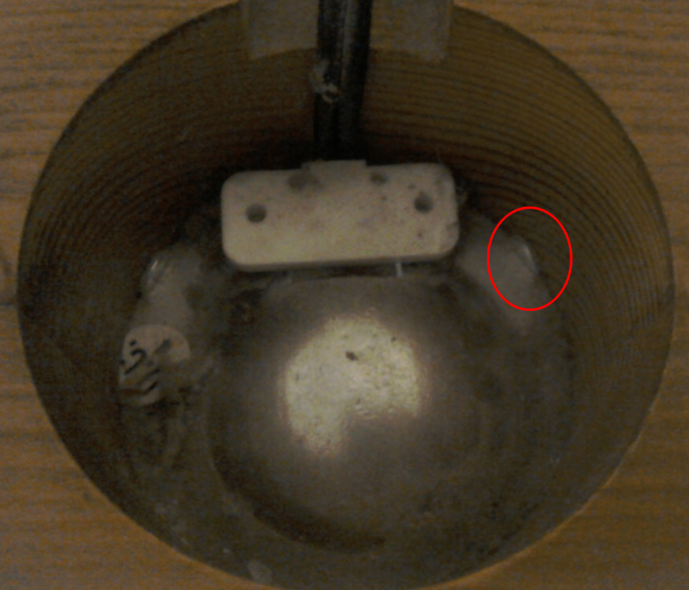

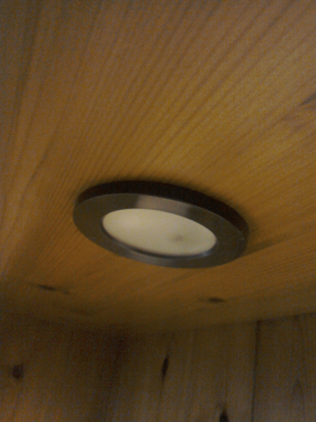

Hi,
Hope someone can help me please. The light on our Ducal Welsh Dresser has stopped working so I would like to replace it but am unsure how to access it.
The power comes from a transformer that is then fed through the top of the dresser and the bulb and cover are in a recess in the top of the dresser.
Attached are some photos.
Photo 1: Have tied gently levering the circular surround from underneath but it doesn't seem like it wants to be removed.
Photo 2: Also tried gently levering the plastic clip where the wires feed through the top but again seems to be fixed firm.
Appreciate any help, please.
Thanks.

It may also splinter the wood. Can't be sure, it might just be because if the light and/or camera angle, but to me this little lug (presumably there's a third one we can't see)
looks like it might be at an angle so that when the light is turned clockwise (from below) it bites into the wood.
Have you tried twisting the light anti-clockwise?

The chrome ring around the lamp, inside the cabinet, is fixed to the inside of the cabinet top with two small screws, and the inner part, with the bulb and glass, pushes into it and is retained with two metal barbs of pressed steel that spring out.
On mine, the part with the LEDs does not seem to dismantle for replacement of LEDs
I can't see how to remove it non-destructively, unless, from above, you can see the screw holes and drill the screws out.
You could perhaps slip a blade under the edge of the ring and force it off, ripping the screws out.

Wow, thanks everyone for such quick replies and for the suggestions.
The chrome ring (from the underside) seems to be held firm and I have not been able to twist or turn it. I have tried to lever it gently, but there is no movement at all.

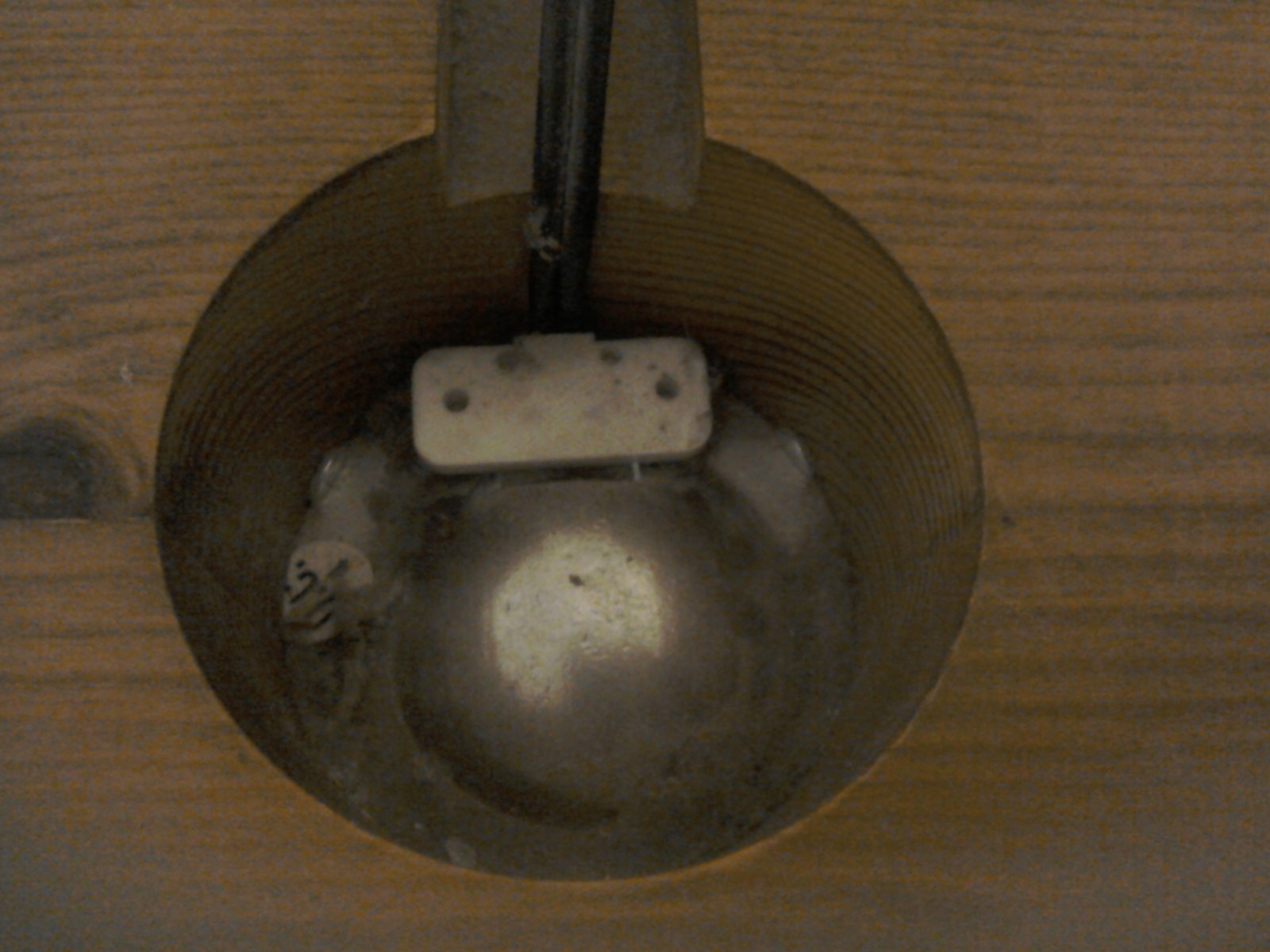

There are 3 metal tabs in the recess above, so I think I will try to bend these back first, then try the screwdriver and mallet suggestion.

I have managed to remove the complete fitting by bending back the 3 tabs and tapping gently from above with a hammer and small piece of wood.
Once out, I could see that in fact, the plastic outer ring (photo 1) was removable as it was clipped in, however, access to prising this out would have been very difficult. There were then 3 tiny screws revealed after removing the outer ring, which were holding the light in place. No damage done though as the screw heads just popped through the aluminium light casing and I can probably re-use them or get slightly larger screws if necessary.
It's a very small bulb so all I need to do now is try and find a replacement from somewhere!
Many thanks again to all replies.
It's actually just 2 straight prongs. It looks like the same as a G4 although the gap between the pins is less and the pins are shorter. Not sure if that is still a G4. It is marked as OSRAM 64415 which suggests on Google it's a G4. I will take a trip to the local lighting shop to try and match the bulb.
Thanks AP77, helped me a lot. The plastic cover surround (photo 1) is fiddly to remove but gently prise it then it pops off to reveal the bulb. The bulb is a G4 10 watt 12v. They do low voltage halogen which works a treat.
