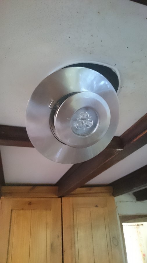

Please help! We had these recessed lights fitted about 2 years ago and a couple of them have gone. How on earth do I get to the bulb to replace it? Thanks in advance! I'll try to upload a photo
The little bezel will (probably) unscrew with a thread or turn until tabs can be released.
It will be full of dust and very hard to turn.
It looks to me as if the leds are built in (not replacable) and that the units are no longer manufactured. Shame as they claimed 5 years lifetime. I think you can still buy remaining stock on the internet , to minimize effort at this stage.

That would be very annoying if that is the case. I have a feeling you may be right though :(

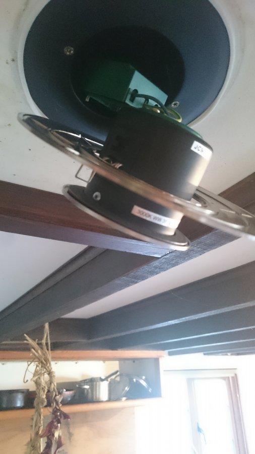

The only thing that looks like it could come out are two rivets on either side. I wouldn't imagine it would be that difficult if that was the way to change the bulb though?
Strange that Google doesn't give an answer as to whether the bulbs are replaceable or not!

The description of the units all use the word 'integrated' to describe the leds used. I think they don't make it more plain, in order not to put you off buying them.
