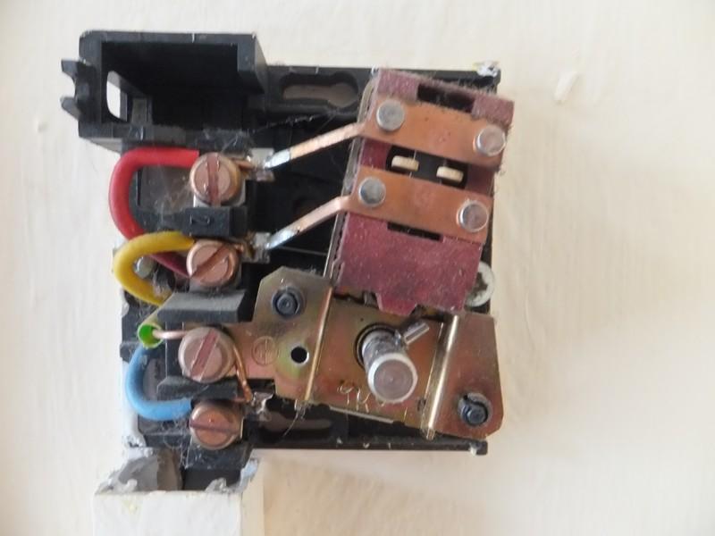

Our thermostat seems to have stopped working, so I thought I should change it.
I am a bit unsure on how to wire it up though, can someone tell me in simple terms i.e. red wire to no 1 etc.
This is the original one

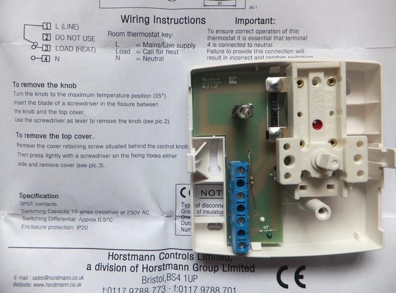

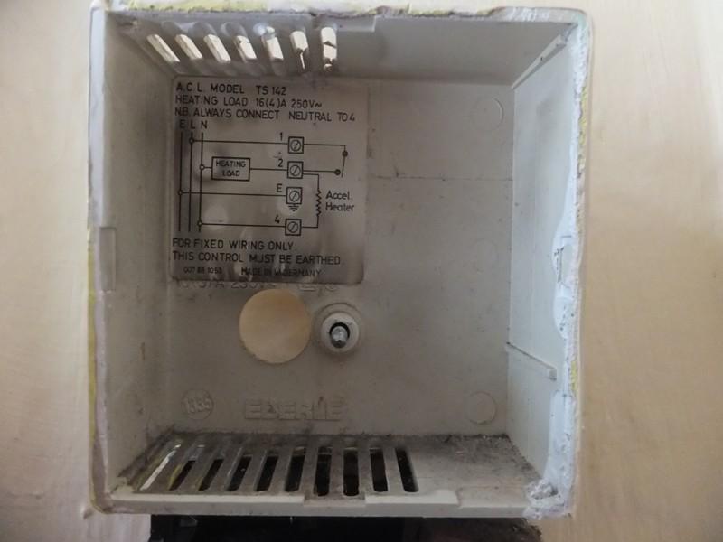

This is the instruction for the original
finally the new one with instructions.

Green&yellow to metal terminal - not 100% clear, is that a screw terminal above the blue ones? If not put in a connector block and position safely.
Blue to 4
Yellow to 3
Red to 1

Thanks for the reply, I just checked and the existing wiring is from top to bottom.
1 - Red
2 - Yellow
3 - Green
4 - Blue
So, if I understand you correctly, I don't use the Green and fit that to a connector block.
1 - Red
2 - Yellow
3 - Green
4 - Blue
1 - Red to new 1
2 - Yellow to new 3
3 - Green see below
4 - Blue to new 4
I am unsure from the picture if that object about an inch above the blue connectors is a screw terminal or not.
If it is I would think it the earth terminal.
If it is not then use a connector block for the g/y wire.
Do the instructions mention an earth connection?
Your diagrams tell you in simple terms.
You have one of your current thermostat, showing
Line connected to Terminal 1
Load connected to Terminal 2
Earth connected to Terminal 3
Neutral connected to Terminal 4
And you have a diagram for your new thermostat telling you to connect
Line to Terminal 1
Load to Terminal 3
Neutral to Terminal 4
You really, really ought to be able to understand that.
Thanks for the advice, all sorted out now, the thing above the blue box was a light, so I put the earth in a terminal block.
We can be warm again now :)
