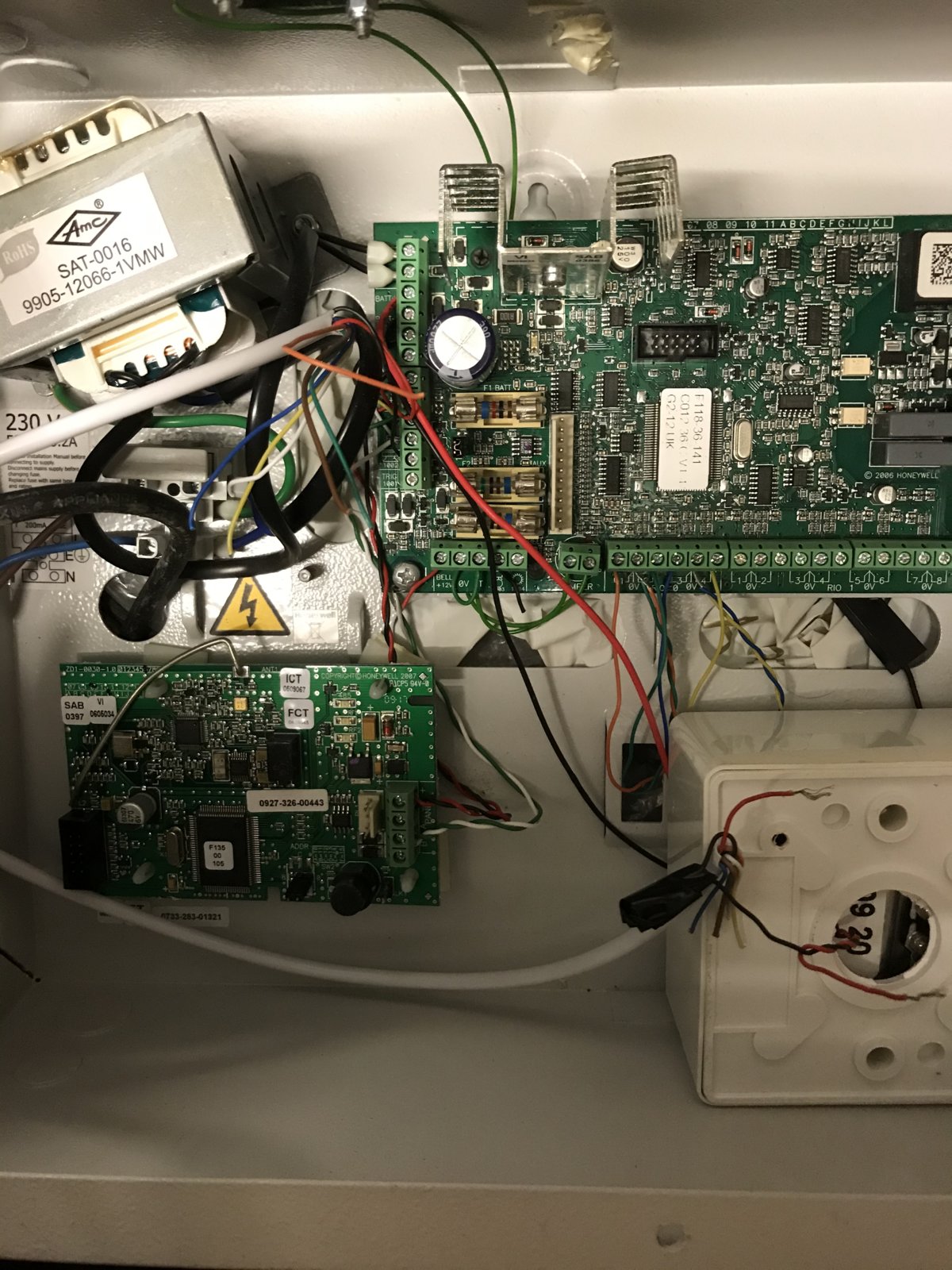

Got a galaxy 2-20 in at the moments got a 2-12 to replace but I can’t learn the fobs on the 2-12 I’ve gone into user (in user code) 42 - rf fob - ent -*auto but it doesn’t pick up the fobs anyone any ideas ? Thanks
Did you default the G2-20 and is it an ADT board that you've obtained ? Ensure that your panel is seeing the max reader in the keypad and that the max mode is enabled. 63.2.1 I think.
I’m replacing the 2-20 with the 2-12 (think that’s what it is ) sorted it now was waiting for a bar to appear when I pressed a+1 but it doesn’t it has now learned all fobs thanks again
The 2-20 I had a lot of zone were tampering (not being used ) so had to set as not used and also it’s gaining time the 2-12 has a wireless thing inside so I can use wired and wireless upstairs ,got this second hand but not surposed to be that old .

I'm not sure what you mean about wireless inside, as the G2 series has a metal enclosure, so cannot have any wireless module internal. It can take an RF portal in an external plastic enclosure though.
The wireless thing is inside metal box on plastic sticky pads ,what do the bugs cause ?
Sounds like it may be an old dualcom that's been left in the panel. This will be of little use to you.

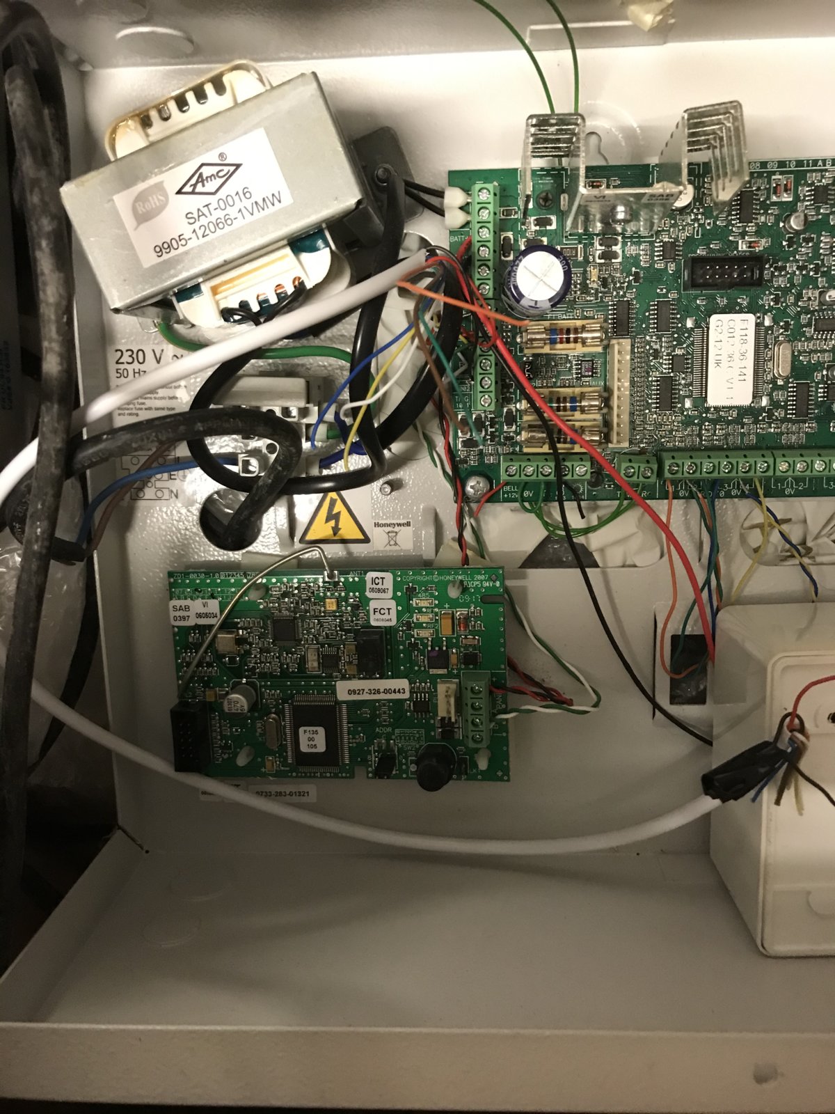

Think it’s definitely wireless I will send pic I’ve added wireless pirs to system as for selfmon I’ve got a speech dialler
Well, not sure who's put the RF portal inside the case, but that wouldn't work when the metal lid is fitted on the panel, as the radio waves cannot get through. If they do, it will not be reliable. Or has this been left running with the panel lid off ?
Must admit I’ve been programming it b4 I change Over so I programmed pirs with lid open ,the rf portal was already fitted inside,the old program zones were all wireless.4 zones in total .i have 4 wired and would have 3 wireless so I’m i right in thinking I need to put the RF in some sort of plastic cover instead of inside the panel .
Yes, the portal enclosure is the same plastic enclosure as the standard wired RIO's. A spring is placed on the black push switch and the jumper (that's currently fitted) is removed. The plastic RIO lid then depresses the RF portal tamper switch when closed.
