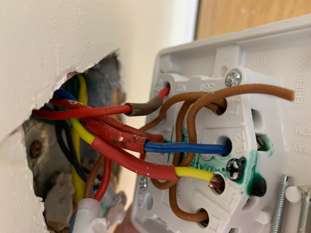

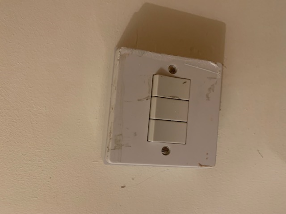

Hi any help would be greatly appreciated

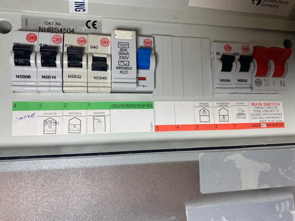

Replacement light switch 3 way to 2 way L2 blue red sleeve is from smoke MCB,
So you want a 2 gang switch, instead of a 3 gang switch.
You have a brown wire going nowhere, it may have broken off from a terminal.
I'm not clear whether you you want to combine two lights onto one switch, or remove a light completely.
That green slime will continue to be a problem, the only cure is to replace the cable(s).
Hey sparkwright ,

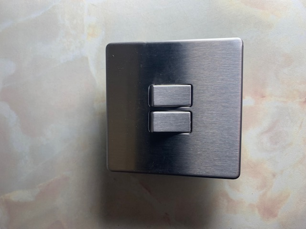

Many thanks for your reply 2 gang switch to replace 3 gang switch the brown wire was supplying outside light which is now redundant, consequently
cut, as per photos.
Green goo is more of a concern we had a electrical inspection on 30-10-2020 all passed .. with a recommendation re inspection on oct - 2025 are you saying this
should been deemed at risk during previous inspection ?
Many thanks ...
Remove the short brown bridge wire that goes between the L1 terminals of left and right hand switches.
Then it's a like for like swap
Old switch L1 is new com
Old switch L2 is new L1
Old switch L 3 is new L2.
Is that green stuff present in more than one cable ? If so ,needs replacing .
Turn off ALL mains power before working on the switch ,it may contain live conductors from more than one circuit.

And don’t forget to extend earth to new switch earth terminal.
