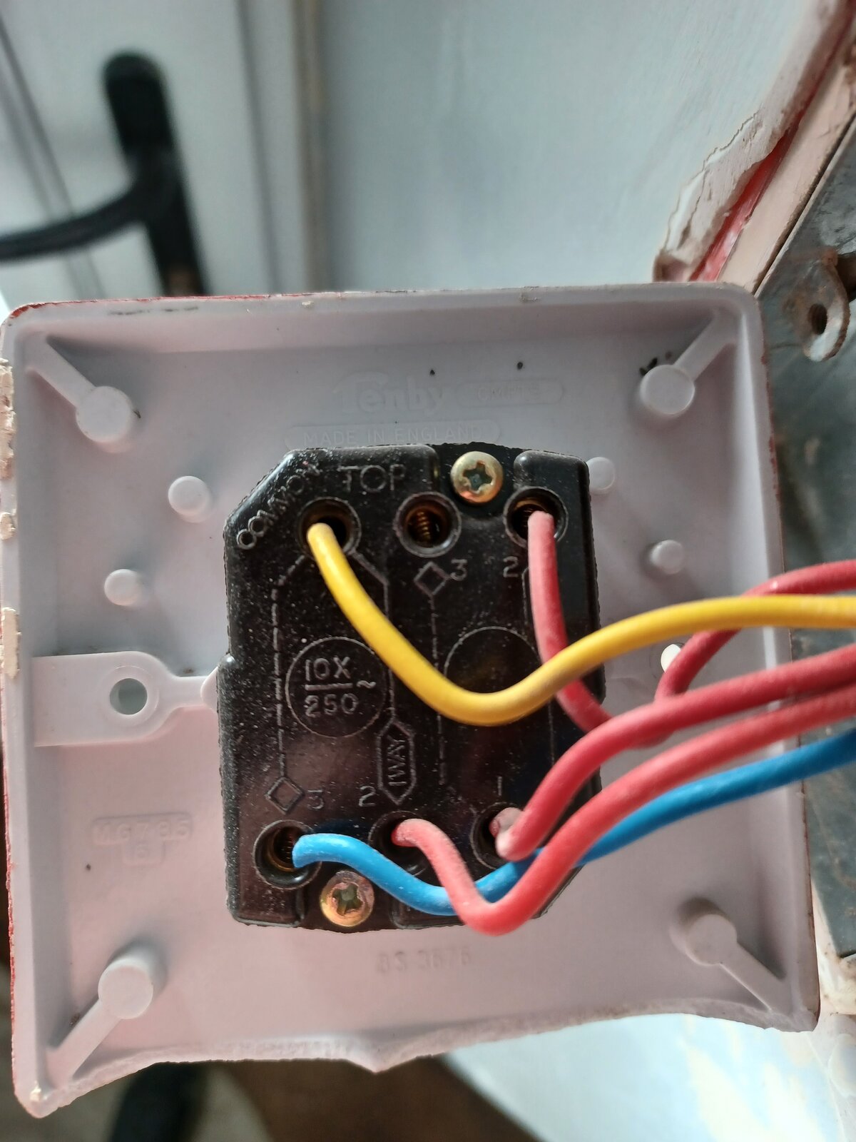

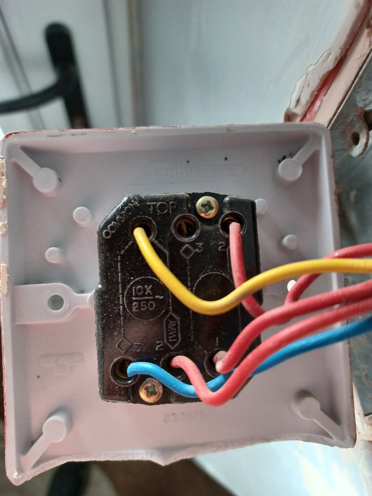

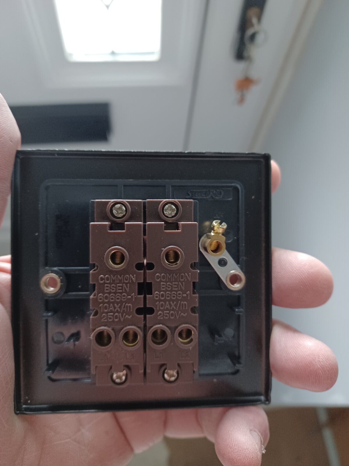

Hi everyone I'm changing the old light switch for a new one and need help as they are different on the back, thanks for your time.

Follow the triangle for the left side and on the right the two reds, one goes to COM and the other in L1.
The new switch will need to be earthed.

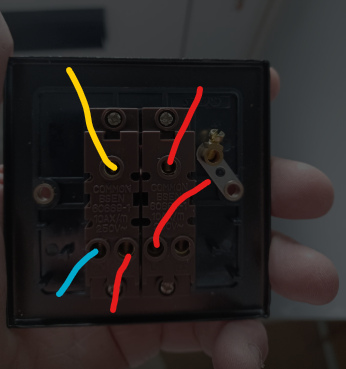

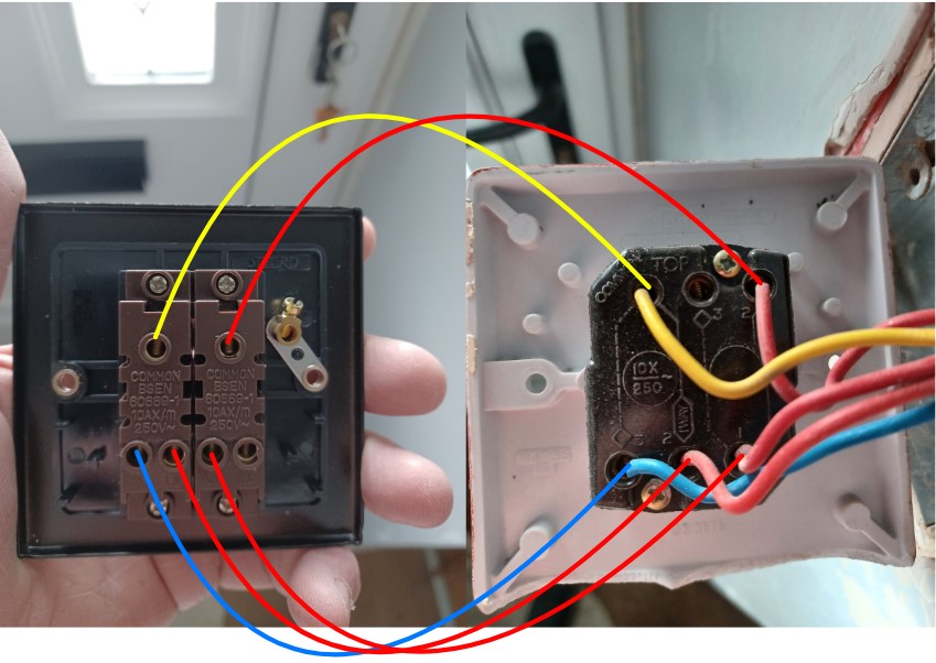

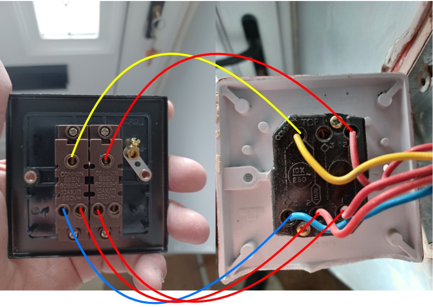

Hi, thanks for answering my query, am I right with the picture I have added? as I thought the bottom right red wire was marked up as common when i looked?
Yes,but for the both red wires on the right it will need to be swapped around.
