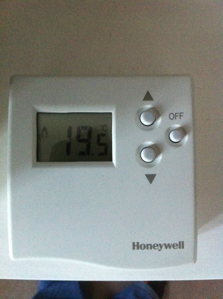

Hi all,
I am looking to change a Honeywell dial thermostat with a digital one, problem is the wiring options are different in both. Thought it would be a simple job!
Can you have a look at the pictures and let me know what you think?
Changing room thermostat

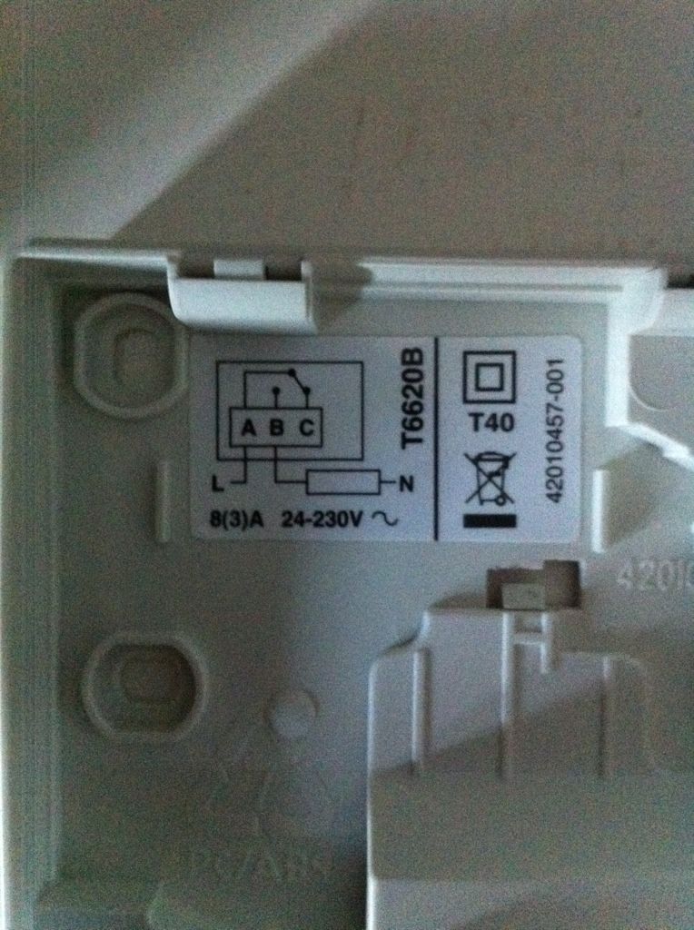

You really should not have needed someone to tell you to take the L that's in 1 as per the top diagram and put it in A as per the bottom one, and to take the one going to the load that's in 3 as per the top diagram and put it in B as per the bottom one.

I do need to grasp these circuit drawings.
I find them hard to follow.
In the example above first one it looks like live goes to A which will then switch between B and C. C being off and B goes to load.
It was the neutral going to the load. It looks to my mind that you are switching from the live to the the neutral . which is silly.
It is showing the live switching to the switch live which goes on to the load where there is a neutral to complete the circuit. Correct?
thinking out loud...
the original stat needed a neutral. Is this purely to operate the stat. only the live gets sent on, the load will get its neutral from elsewhere. The new stat does not need a neutral as it has a battery for the time clock.
But what did the neutral do on the old stat I thought it was a bimetallic strip that reacted to temp so its a mechanical action, why would this need a neutral.
In the other diagram it looks like the live goes to 1 which switches between 4 and 2 /3
4 does not go any where so is off
3 goes to the load
2 is the neutral
I don't understand the connection between 2 and 3 it looks like the live is going to the neutral via a resistor
If the stat needs a live and neutral to work why are you switching it? Should 1 not be connected to 2 via the resistor.
The bi-metalic strip controlled snap action switch opens at a different temperature to that at which it closes. The neutral is used to supply a small heater ( about 1/2 watt ) that slightly warms the air in the sensor to "trick" the switch into opening and closing at almost the same room temperature.
Yes.
No. It's just a switch. The wires do not know what colour they are.
It would be. If you connect live to another wire then that will become live.
Yes.
Yes.
Yes.
Well, it does not 'get' a neutral. The wire which completes the circuit is called neutral.
Yes. Some just work with the bi-metal strip.
It must have had internal workings that need power (as Bernard said).
Yes. 1 goes to 4 or 2&3.
4 would signify that the other devices are off - needed by some Central Heating valves etc.
3 goes to the load
Yes.
2 is the neutral
Yes.
It's only 'called' neutral after a load.
The wiggly line represents the internal workings.
That would be something which is not needed when the heating is switched off.
