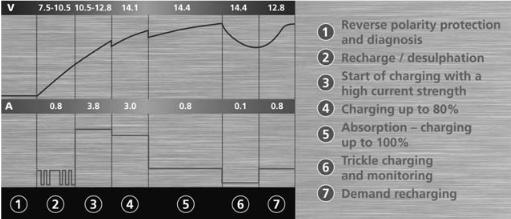

In the narrow boat it does not switch off the alternator when accelerating, and back on with over run, and the alternator is not connected to the engine management, so yes the Sterling unit works great allowing you to use both 70A alternators to recharge the domestic batteries and use stage charging, however this is not an option for many tow cars. Also on the boat the engine start battery and the domestic battery are next to each other so no volt drop problems. Even then for the bow battery to work the bow thruster it is common to use a DC/DC charge controller.
Engine starting is very different to domestic use. If you can charge a battery for 10 minutes with a set of jump leads from another car you will likely transfer just 10% or less of the batteries capacity but that is enough to start and restart the engine. To run heating fans and lighting over night however if it takes 10 Ah per night the 88 Ah battery will only last 8 nights and on the 9th the heating will stop. Bang in the same 10% which got the car started and running, and with the caravan battery you don't even get one night.
The question which can't be answered is how much power is required to maintain the battery? If 0.6 amp then at 0.8 amp in the end it will charge, if 0.9 amp then it will never fully charge, I think my 3.8A is sailing close, but at 0.8A it is possible the battery never will fully charge, if my energy meter drops below 14W then I know battery fully charged and the charger is big enough, until it does drop, don't know if big enough or not.
