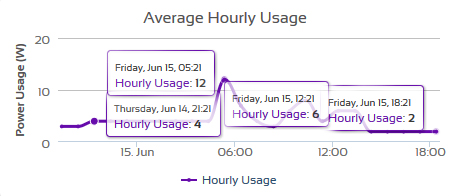

I tried to recharge some 7 Ah VRLA batteries some time ago using a Lidi Smart battery charger with good battery in parallel, I was surprised to see a sudden recovery over some 8 hours after they had been on charge for around a week.

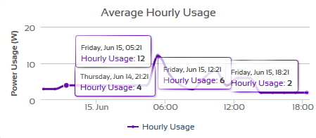

So last Friday 8th June I started to charge a 20 Ah VRLA, the parallel battery a 75 Ah leisure battery had just been used with the caravan motor mover so to start with the charge rate was 3.8A quickly dropping to 3A, and then 0.8A by Saturday sitting at 0.1A where they stayed until this Friday. 5:21 am the 20 Ah VRLA started to take charge, then two more peaks as shown, but by 6 pm it had settled down to 0.1A charge again and 13.4 volt, while connected in parallel with the 75 Ah switching off the charger dropped to just over 4 volts. I need 7.3 to 7.5 volt before it will charge without a battery in parallel.
Now I need to consider how long before I accept the battery is duff? The 7 Ah batteries took nearly a week, but once they started then they fully charged, so this is a different pattern. However at 13.4 volt it can remain on charge with no worries.
Has any one used one of the so called smart chargers, like the CTEK MXS 3.8 to revive a VRLA and what results did they get? Or am I on my own being able to monitor what the charger is doing? I am using a MiHome energy monitor on input to battery.

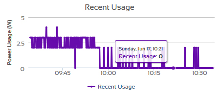

The energy meter measures watts, the charger has 4 current levels, 3.8A, 3A, 0.8A and 0.1A, once the voltages have been reached once, this changes to 0.8A and 0.1A only, when volts drop below 12.8 then current goes to 0.8A and when it hits 14.4 it drops again to 0.1A, the resent usage shows a load of spikes as it keeps swapping between 0.8 and 0.1 amp, but the average hourly usage smooths down all the spikes to show gradual rise and fall.
So 2.5W = 0.1A but will not show 2.5W so keeps jumping between 2 and 3 watt, same with 14.5W = 0.8A again some times shown as 14, some times 15 watt.
Without the VRLA battery the leisure battery stays at 0.1 amp and 14.6 volt, with the VRLA it has dropped voltage to 13.3 and as seen on graph it did at one point start switching between 0.8 and 0.1 amp, you are right I should get the Mk8 out and measure actual current to VRLA, however until today that has been nearly zero, disconnecting the leisure battery while it is charging the voltage goes over 15 and it auto switches off.
With last VRLA as soon as it started to charge I was able to remove the croc clip off the leisure battery. I had expected same today, however simply did not happen.

Unfortunately my variable voltage and current power supply has died, I did use it to charge small batteries, however it seems the cheap Lidi battery charger has an undocumented function, it actually does drop the charge rate to zero.

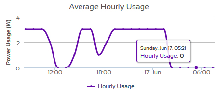

this morning I found this graph, the 12:00 and 18:00 dips are where I turned it off, but the drop between 17 Jun and 06:00 was the charger, it had not switched off, it had just reduced charge rate to zero with a few spikes, volts showed as 13.1 I removed the leisure battery to see if it would now charge the 20 Ah without it, but the charger switched off showing the VRLA voltage as 5 volt. On switching on again the charge rate was 0.8A for few seconds, then returned to 0.1A, how long it will charge at 0.1A before going to zero again I don't know.
Before switching off this was the graph, wish I had not switched off, as the charge pulses are it seems exactly what is required to revitalise a sulphated battery, I do think your right, and the VRLA is scrap, however I would leave the charger on the leisure battery on charge anyway so it is ready for next time we take caravan out, so may as well leave the VRLA on for another week and see what happens.
As said before seeing the way the 7 Ah batteries recovered I would not have considered leaving on charge for so long, if nothing after 24 hours they went in the bin, the 7 Ah batteries sat doing nothing for around 10 days, then fully recharged.

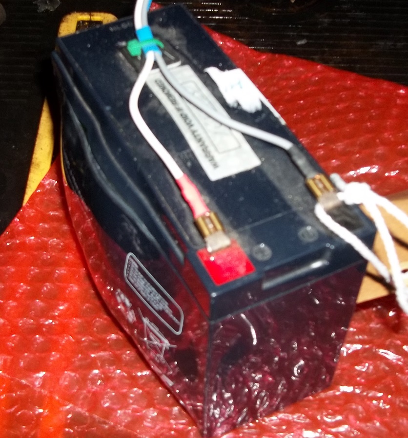

I had a similar "surprise" but it took longer. It was one of two 10 Ahr batteries that I had lent out. Both were completely flat on return ( circa 9 volts off load )
Charging both from power supplies set at 13.8 volts but limited to 1 amp and left ( forgotten ) for several days. One is now a good battery.
The other was a bloated wreck..blown battery.jpg .

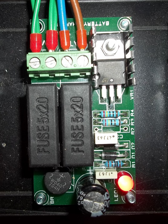

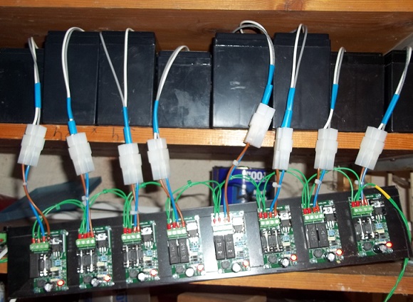

With 20 similar batteries to keep in good condition throughout the year and with advice from the manufacturer I built some simple mini chargers with output voltage fixed at 13.8 volts. Current limiting when charging a depleted battery is achieved using the thermal shutdown feature of the regulator. They are on permanent charge fed form a 19 volt DC source. Total current taken from the source is about 250 mA of which 160 mA is that used by the indicator LEDs

I am certain the bloated battery was due to a failed cell as the heat was concentrated in the middle of the battery.
