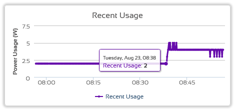

It is curiosity, removing the donor 12 AH battery the Lidi smart charger goes over voltage and switches off, but shows 9.6 volt, so some energy entering the battery, the 12 AH battery would be on charge anyway, and the power from mains is shown as 2 watt, so very little, just interesting to see if it recovers.

Today Tuesday 23rd August went down to check on brewing and charging and unplugged the donor battery, and this time the smart charger did not disconnect on over voltage, the voltage was dropping to 12.7 charger kicking in raising to 14.4 then charger stopping and dropping again to 12.7 volts before repeating.
The energy monitor is now recording a raise to approx 4 watt.
It seems it has just started to accept a charge.
