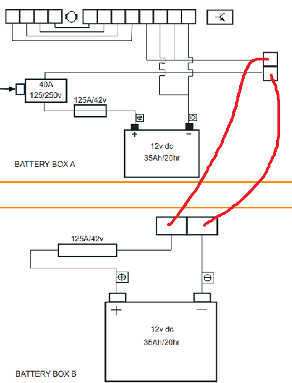

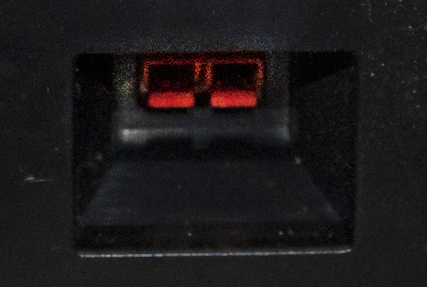

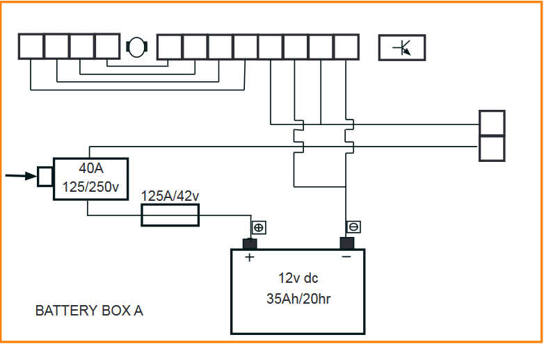

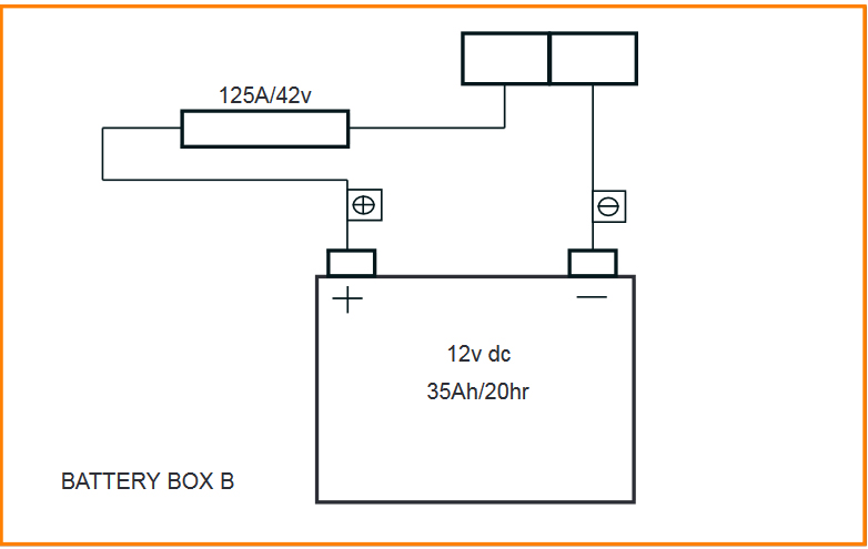

Above battery A you can see the multi-connector to right which connects to the scooter, not sure why so many, as it is simply duplicate 24 volt DC connection. In centre you can see where it connects to battery B.

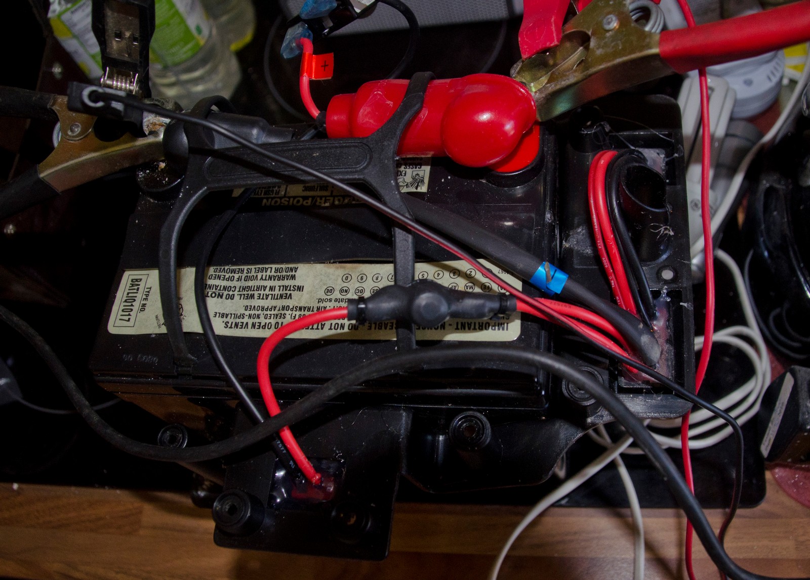

So to get a 12 volt connection to battery A would require one connection to side connector and one to rear connector, so at the moment battery case open so a smart charger is simply clipped onto the battery, because it is a smart charger designed to charge 6 or 12 volt batteries as a 4 stage charger, it will not as it is charge the battery as the voltage is below 7.5 volt required to switch the charger into 12 volt mode. So there is a 7 Ah battery in parallel to trick the charger into working, once removed the voltage goes over 15 and this turns the charger off.
This is not the first time I have done this, and in the past it has after a week or two as if some one has flicked a switch started to charge, the battery has been left discharged for a year, however when the other battery failed it may have damaged this battery, so it may never recover, but no harm in giving it a go, if one cell is shorted the charger will only supply 0.8 amp and the 7 Ah battery will not transfer a dangerous amount of energy so quite safe. At the moment holding at 13 volt with no output out of the charger, if it drops to 12.7 volt then charger will switch to 0.8 amp output then 0.1 amp, so will be a slow charge, but as you say that is good.
So since a simple 6 mm bolt to connect battery, easy enough to at cables with a ring terminal, but trying to work out an easy way to get a connector to easy connect to 12 volt charger, in a way where loading into a car can't result in a short circuit.
