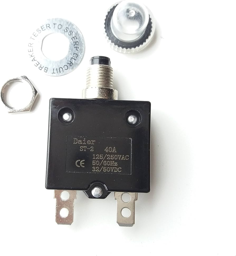

This is a mobility scooter, the overload has smashed, so clearly needs renewing, marked 40 A 60 Hz 110 - 240 volt and supply is 24 volt DC from two 32 AH 12 volt AGM (VRLA) batteries, I also have a problem charging the batteries as the charger has gone walk about, which is how I found the damage where the battery has jumped up and smashed the overload, as needed to remove casing to gain access to charge batteries with two 12 volt chargers.
I have wanted to modify for ages, as one can't charge the batteries off the scooter, would be better to leave scooter in the car, and only take batteries in for charging, it is a large heavy lump to take in doors for no good reason.
But to replace with an AC overload does not seem right. Looks like this 1690020539455.pngbut it seems Amazon where I got picture from is out of stock. Only second hand ones on ebay. And would like to mount where not damaged if battery bounces.

https://www.chinadaier.com/40-amp-circuit-breaker/ is the one you have posted a picture of. https://uk.rs-online.com/web/p/thermal-breakers/7827953?gb=b is a DC 40A device from RS. eBay has a different brand and google found me at least one mobility place selling similar DC rated breakers.

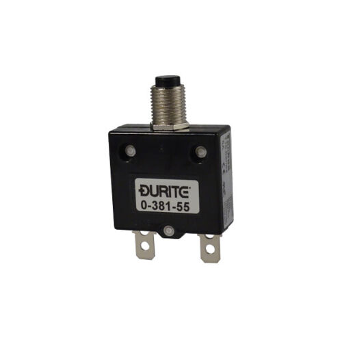

But it seems strange to use 230 volt overloads, there were a range made for wagons, I assume one can still get them likely Durite?
The breaker will not care whether it is triggered by ac or dc, what matters is the type and size of current it has to break.
Personally I'd try and change it like for like, the designer of the equipment has obviously assessed it as suitable for the function dispite it being used outside the manufacturer's spec....
And a breaker designed for AC might be unable to supress the arc after breaking DC
which is why the AC rating is 250 V and the DC rating is much lower at 40 V.
Also some circuit breakers that are rated for DC operation use a "forced break" where a sheet of non conductive material is forced between the contacts to ensure they separate.. This also extends the length of the arc to be long enough to ensure that it quenches.
