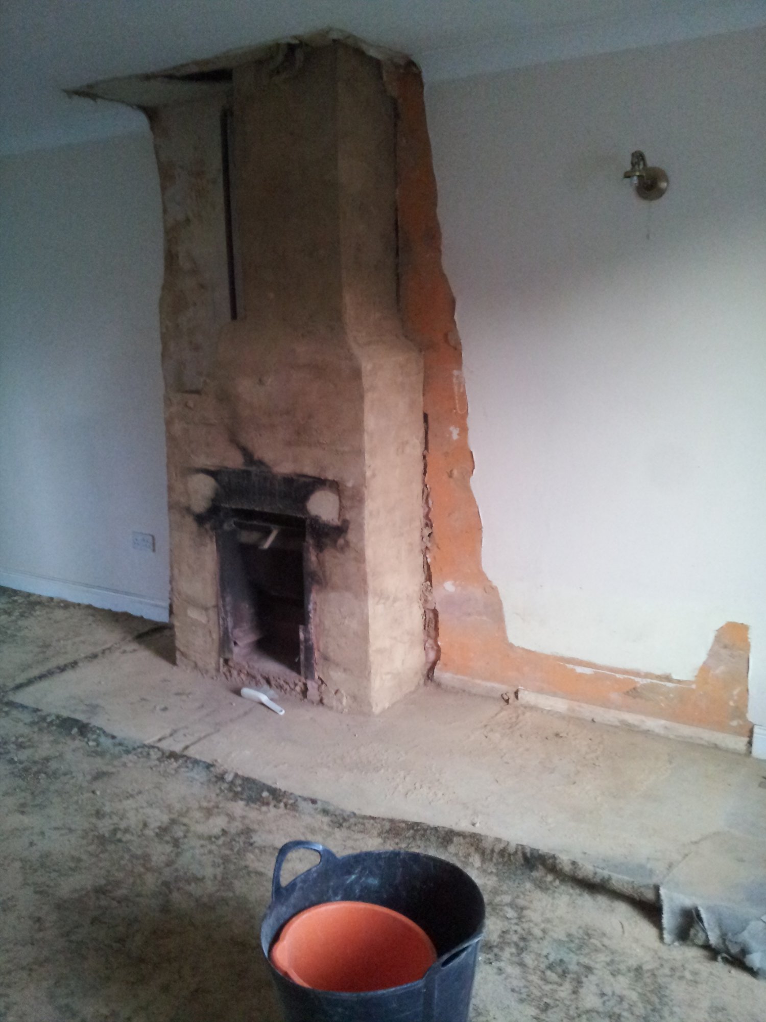

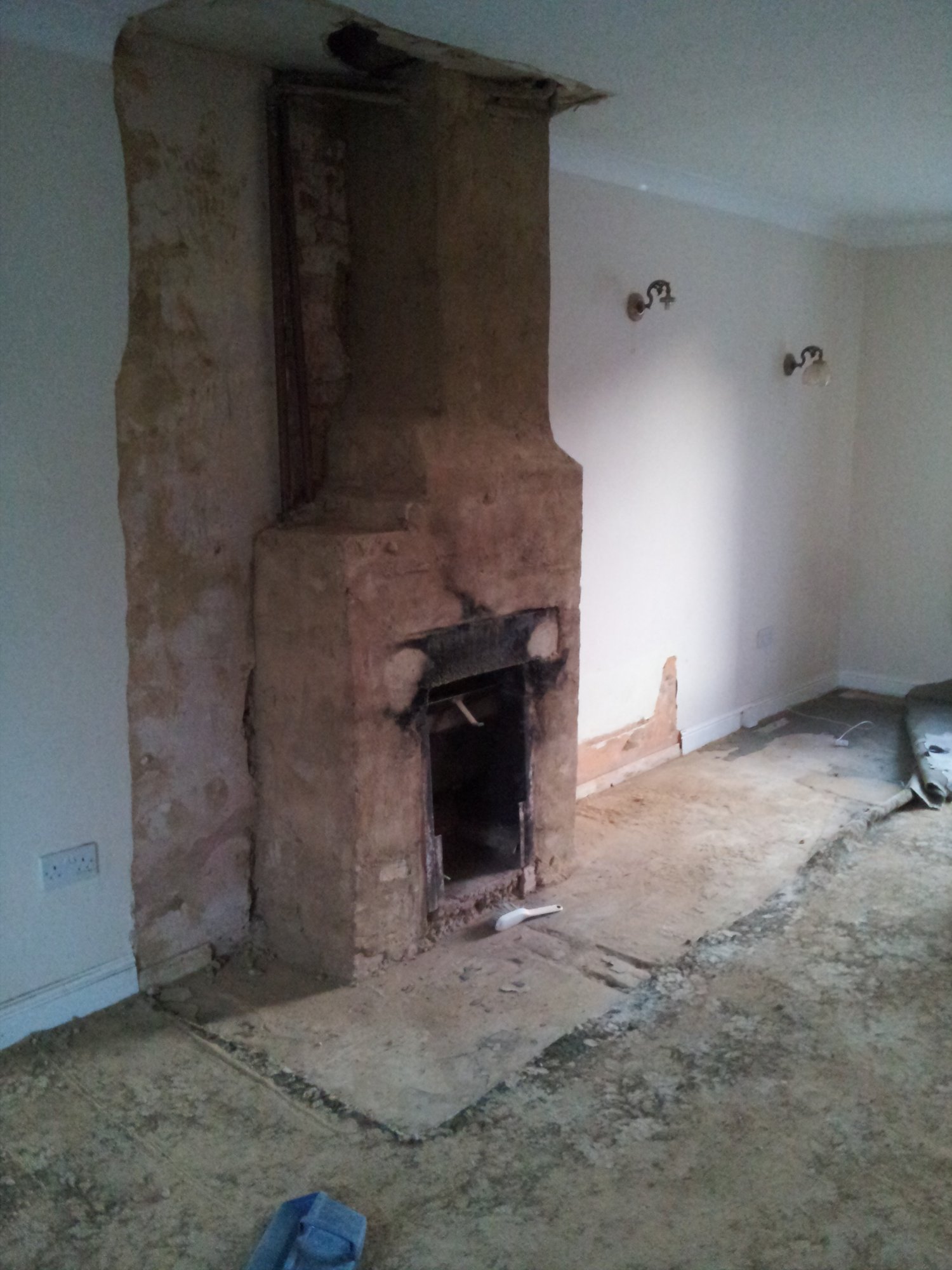

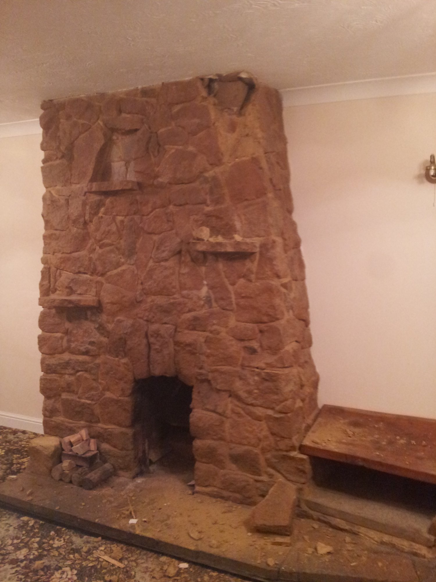

So...I've removed the old fireplace cladding and am left with an odd shaped chimney. There is a heat exchanger in the fireplace I think which I've not removed yet ( the pipes are cut at the ceiling so its not functional).
Were looking to get an inset stove put in (by a qualified HETAS engineer) with some sort of stone or granite surround. Essentially i need to prep it for the installation and the chimney breast needs squaring off. Is this simply a case of breeze blocking a rectangular symmetrical wall either side? Can I tie it to the chimney stack? Can I put plasterboard over it? Do I have to use special materials or does it not matter once I've allowed for the clearances around the opening (typical sizes seem to 400mm above and 150ish either side - depending on the manufacturer)
Thanks for your help.
Before:
After:
Remove all remains of the previous appliance, including the copper pipes. Smash out the fire back.
1. sweep and smoke test the flue.
2. check or have examined the chimney stack and flaunching, flashing, and what kind of terminal is present.
3. you must have the Mfr's instructions for the inset appliance - and make your opening in accordance with the Mfr's dimensions.
The thing is, that the flue will begin to slant over to the right soon after the lintel.
4. If you have to raise the existing lintel then come back here.
5. Brick or block up from the c/breast shoulders - going back against bare brick not the plaster. Go up as high as the ceiling.
6. It would help if you have an idea for the new stone surround.
