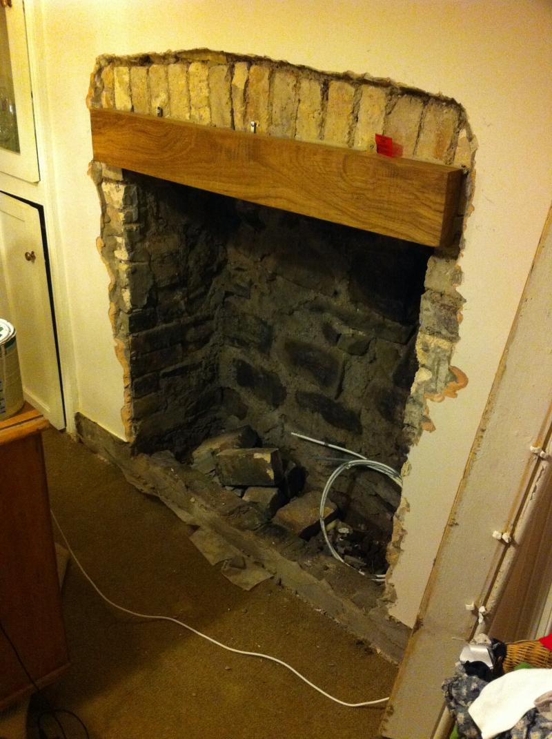

Hi All,
Here's a pic of my latest project.
I knocked this through and will eventually be putting a log burner in there. Plan is to render and plaster the internal side walls, and around the fake oak lintel) but leave the stone wall exposed at the back and tidy it up.
I want to have a welsh slate hearth that extends out into the room and creates a T shape around the side walls. The floor in the main room is concreted with plastic moisture barrier up to the edge of the opening.
At the moment the floor inside the chimney breast is just soil.
I'm willing to get my hands dirty on this one, but just wondered if someone could walk me through the process to get it ready for laying a slate heath?
I'm a bit of layman so go easy on me :)
dig down in the soil, put some plastic in the bottom to prevent damp coming up, pour in concrete to desired height and put slate down
Lime render is OK but you cant use gypsum plaster, it won’t stand more than 49 degrees C & will crack & blow off the render immediately you use the fire.

Thanks for the help both.
With the concrete floor....
1. Is there any plastic in particular I should use?
2. Is there any partiular type of cement/ratio?
3. How do I finish it off when it's at it's desired height? Will it just be flat or do I need to level it with a bit of wood?
With the walls...
1. If gypsum is no good, what plaster should I use?
Sorry for being clueless
Before you go doing that, look at the Building Regulations link for constructional hearths, the depth & size has to be in accordance with Building Regulations. See also the link below.
Typical mix is 4 parts sharp sand, 1 part cement. Here’s another link, read the section on hearths;
http://www.solidfuel.co.uk/pdfs/opening_up_your_fireplace.pdf
Oh dear :cry:
You can use sand/cement/lime render for the base coat, lay on in two coats 5:1:1 then 6:1:1. If you want plaster finish over that, you need to use a heatproof plaster such as Vitcas; http://shop.vitcas.com/vitcas-heat-resistant-plaster-16-p.asp
Lots about render & plaster in the DIYnot links I posted.
You don’t really seem to have read the links I posted; you really will find most of the answers in there. From the questions you’re asking I would advise you do more research before you go any further or you will start making mistakes. It’s not difficult but really isn’t a job to tackle if, by your own admission, your clueless about what your doing.
