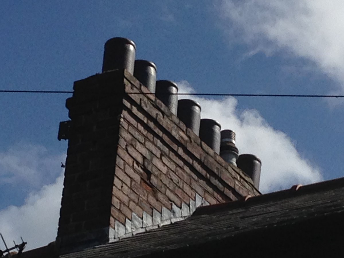

Just had a mortgage valuation done and a retention attached to it. It highlighted the fact that there was no chimney breast in the bedroom above the downstairs room where the chimney breast is. They have requested that we can prove sufficient support in the loft for the removed breast. Having looked in the loft, there has never been a chimney breast there apart from a section of about approx 2m wide where there looks like a single course of brick sticking out that runs up to the roof line. The people selling who we know don't ever recall there being a breast in the bedroom. The property is 1950's semi and the stack on the roof is long and narrow which has 6 pots/vents on it. breast in question is on a party wall. It also has a back boiler. Any ideas as to whether this is an original design or not?

1. of the roof stack with the 6 pots (are there any other stacks?)

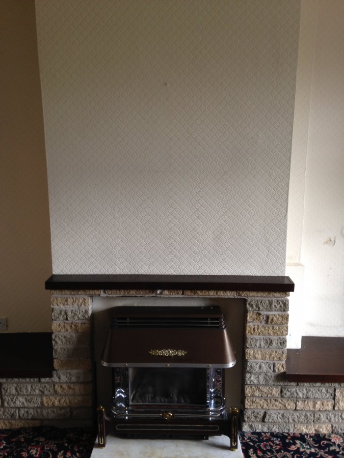

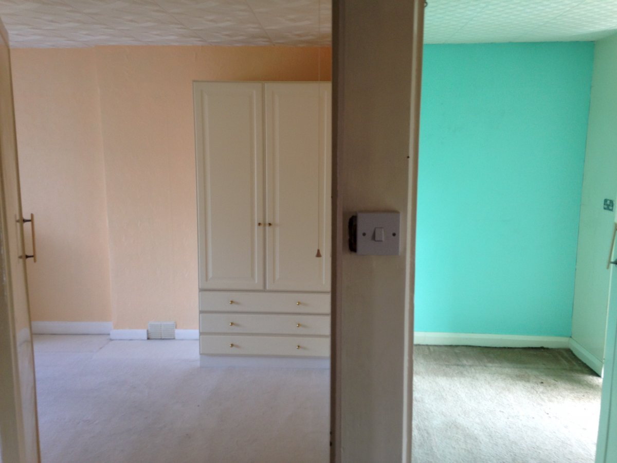

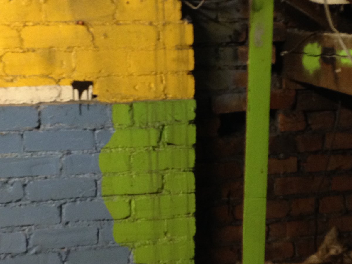

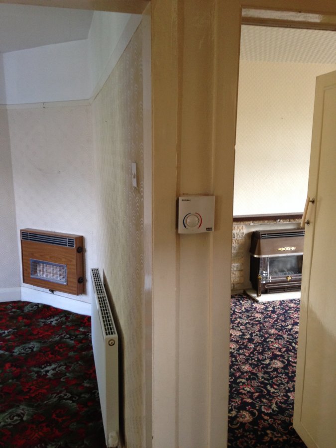

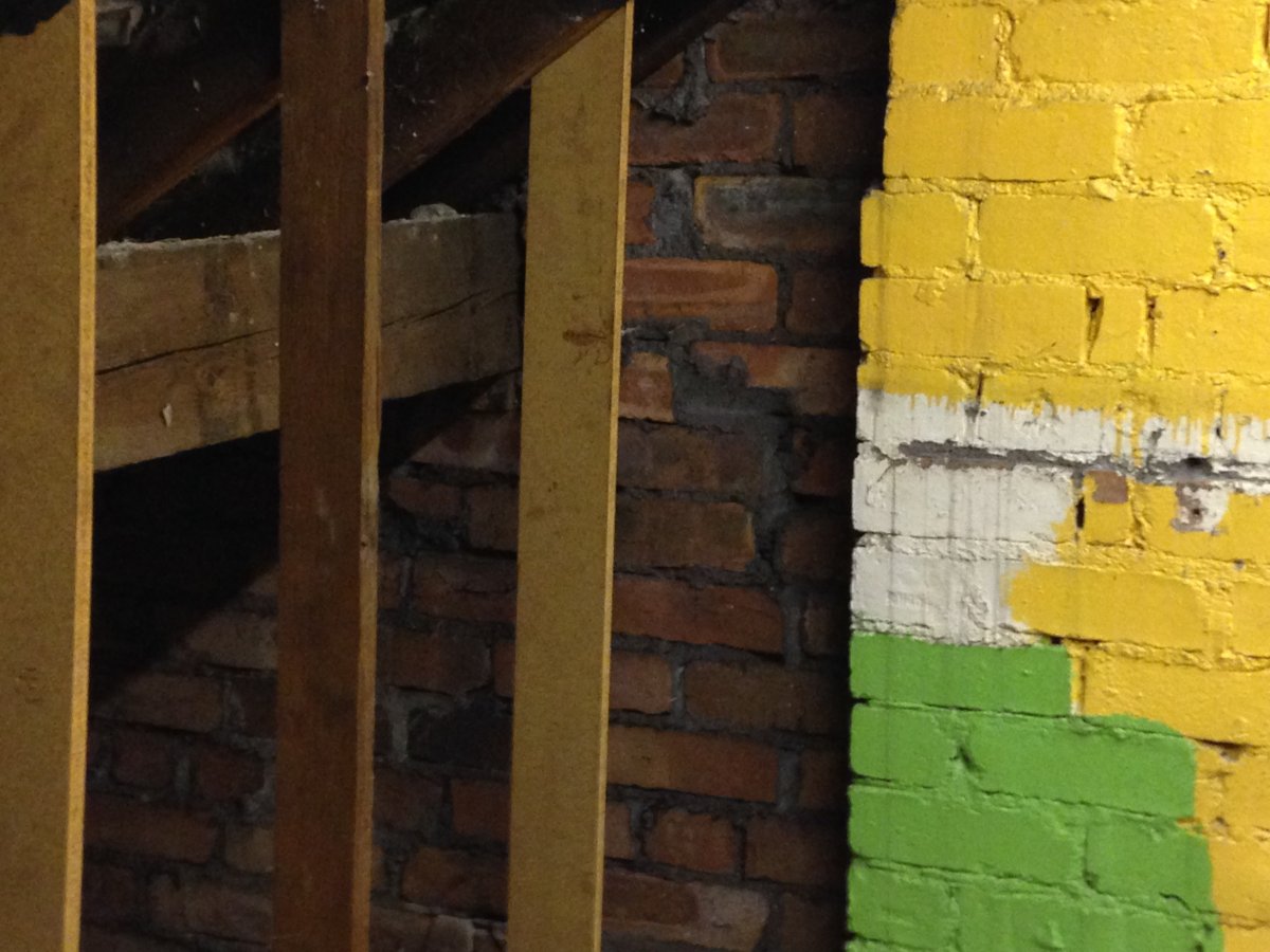

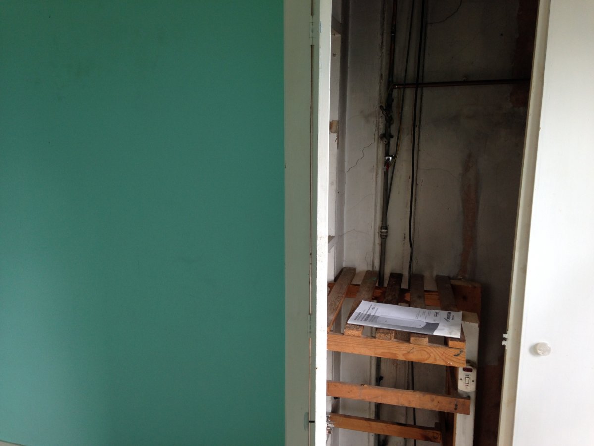

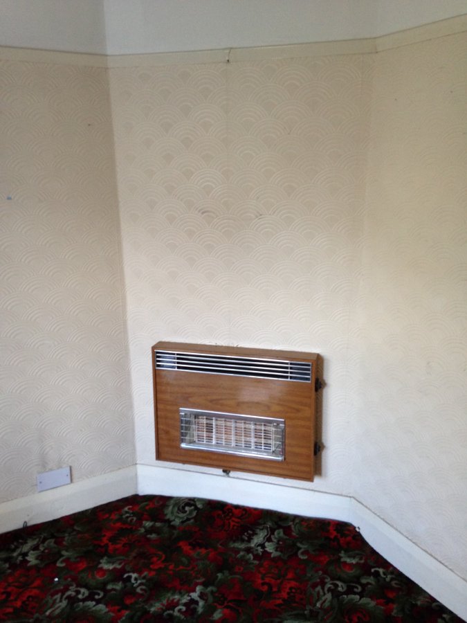

These are the pics that i took today, having spoke to a builder, he says that this is the chimney breast upstairs in the two rooms and loft. They are built into the party walls of the two properties and being a 1950's house, they were not designed for coal fires, hence the narrow breast. The only reason the breast is bigger in the room below is because of the back boiler. Make any sense?

That is clearly the chimney in the loft.
Is the wall between the two upstairs rooms directly above the downstairs wall?
It looks to me as if the left bedroom clearly has a chimney - there is even a vent! In the right bedroom, it's possible that the entire back wall is chimney though there is no vent.
Maybe you need to do some measurements to prove what lies above what. Or poke something through the bedroom ceiling and see where it comes out in the loft.
It does sound as if the surveyor is confused. You could ask them to clarify what their complaint is.
Thanks for the reply endecotp, yes there is a wall directly below the separating wall in the bedroom and although it is not that evident from the pictures, the blue wall with the old airing cupboard has the same wall as the front room, by that I mean the wall sits back further in the cupboard.

In that case, I really don't know what they're complaining about. What precisely does the surveyor's report say?
"Confirm suitable support is provided for chimney breast within the
roofspace. The breast within the rear bedroom has been removed".
In photo 0709, move that wardrobe and measure from the doorway down either side of the wall. Presumably you'll find that both sides are the same, proving that the back wall of the right bedroom is the chimney.
Looks like a standard Bermuda 552, Honestly don't know how the surveyor got to that conclusion? Did he even look in the loft? The coloured bricks are the breast you can clearly see left & right is the party wall behind. Looks fine to me.
Only other thing to do is knock a neighbour and ask if they mind you having a look.
Don't need to move the wardrobe, measure before the vent where the wall dips further back, to the opposite wall, measure after the vent and measure in the right hand side bedroom.
