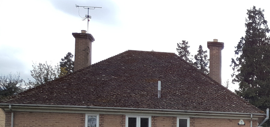

I'm currently in the process of having a new gas fire and fireplace installed. The old fireplace was an open fire so has a plain chimney pot.
As I'm having a HE gas fire installed, this'll need to be replaced for something like a GC1 terminal. The issue is the installer wants £££ to hire access equipment for his guys to replace the pot as it's not straightfoward to access.
Do you need to be Gas Safe to replace the pot? (i.e. can I replace it myself.)

What sort of cash is your installer looking for? £450 because of the height and nowhere to hook a roof ladder to.
Maybe some photos of the chimney could find an alternative solution. Poor quality photo attached (I'm not at home)
Which gas fire have you in mind? Stovax/Gazco Logic HE
How many quotes have you had? 1 (only Stovax dealer nearby)
sorry a lot of ?'s but we need info to comment.
He was suggesting hiring either scaffolding with an access kit to get across to the chimney or ideally a boom lift.

I was thinking of doing it myself as I need to replace the antenna anyway. Any legal issues re: Gas Safe? I have a scaffold tower, but the entire assembly is not kitemarked so they are not willing to use it. (Individual components are, but some parts are a different brand)
One could argue that the terminal should be fitted by a RGI. Why not just fit a basic bird guard? In one respect it is better - there is no resistance. When your GC1 gets full of cobwebs you can end up with problems - which you don't want if it is a £450 access.
He is wrong, assuming the chimney is not metal lined. Fires DO NOT require a terminal.
Personally, unless you have issues with rain ingress, I would not fit one. HE fires are generally less sympathetic to increased flue resistance, whi
ch a GC1 will provide. As I intimated earlier, when (probably rather than if) the "can" gets a bundle of cobwebs, the fire will start to "spill"fumes. as the flue will not draw the fumes away. If he is charging £450, it will be financially painful to have to get some one back up there to remove and clear. It (cobwebs) will not be covered by warranty.

There is no recommendation other than the flue should have sufficient pull and minimum 5" diameter in the Gazco manual. If a cage is compliant with building regs then that is far easier for me to install.
He was going to install a cowl, but said the open pot was not compliant.
An open pot is perfectly okay and compliant. Except birds may enter. Too many folk get "a good idea" confused with "it is required".
EDIT: Just to clarify, the "fireman" in my username does not refer to the brave guys in uniform:)
Gone for a UFO cowl. Quick fitting and looks unrestrictive.
