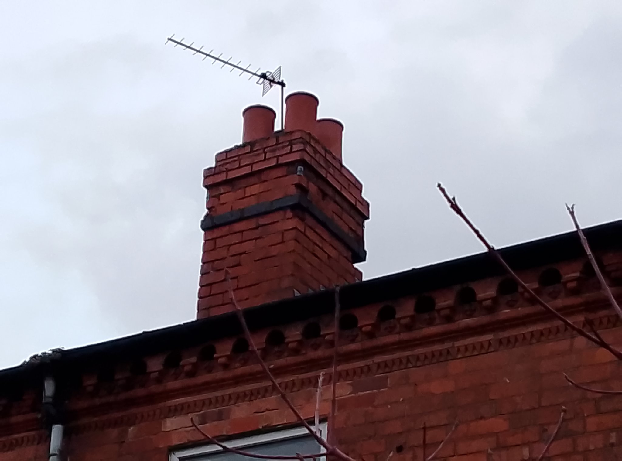

Afternoon , I live in a mid Terrace , I've noticed recently that the chimney is losing parts of the mortar and there are even bricks missing after harsh weather , the neighbour who shares the chimney left his property 5 years ago to move abroad and left it vacant , ( he owns it ) , I have no way of getting in touch with him and even though it is technically his side of the chimney I'm not prepared to be stubborn and allow for the chimney to crash through my room and destroy my property or worse .
Looking at the attached image can anyone please advise if they think this will require scaffolding or could the chimney be reached with ladders , also any Idea roughly how much this will cost , the majority of the bricks are fine so I would imagine that if would be a case of repointing and the missing brick being replaced ,
Some work (e.g. inspection) may be possible by rope access, but generally scaffolding is needed.
Your local council have powers to carry out emergency repairs on properties, especially abandoned properties, if they are at risk of damaging other properties. Get in touch with them, as a first step.
Get it assessed, it may require partial rebuilding not just repointing and a few bricks replaced.
And the assessment should ideally not be by someone who may want to do the work and charge you handsomely for the privilege. Again ideally, if an independent professional report can classify this as essential, that will help your position.
The council's powers won't extend to what is normal maintenence. However, should you want to formalise things, you may be able to secure an injunction to access and work on the neighbours half. Speak with your insurers on your legal options.
It will be a scaffold job. And unless you want to go through the palaver of tracing the neighbour, you may want to just bite the bullet and do the work and ask for forgiveness if the time comes.
