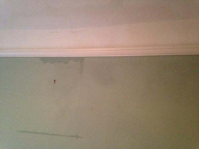

Thanks all for your replies.
Some pictures as requested.
The water damage:

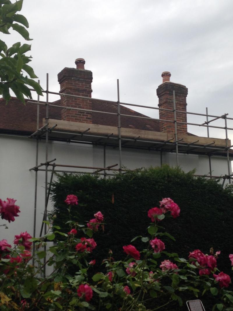

The stacks:
So yes, external breast....

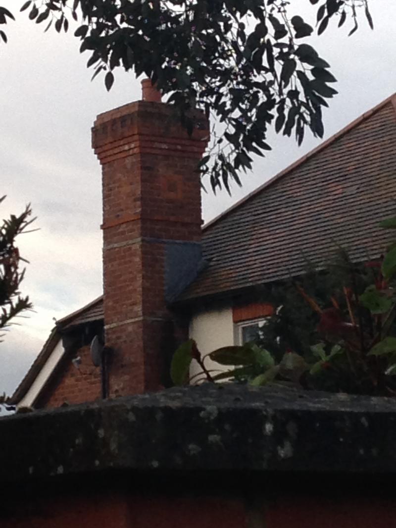

This is a pic of a chimney on a local new house. Yes, it has lead trays which I couldn't do without a rebuild but it has the lead sheeting at the rear of the stacks which I was thinking may solve the problem (would need more lead than the chimney pictured as would need to go 3/4 of the height of the stack...)

Thank you for the pics.
But if the scaff is still there, why not go up and take more pics showing the flaunching and flashings on both stacks?
Why do you have scaff there?
So you have two stacks, and two terminals (visible in the pic) both terminals are fitted with Colt air vents. The Colt gas vents have "higher" screens but these will work with a gas appliance.
Lead DPC trays are not much use on external chimney breasts - rain water will keep by-passing the trays on the external exposures. Sound pointing at 20mm depth is best.
The old flaunchings should have been completely removed, & new flaunchings applied. The new flaunchings should be sloped to shed water.
Each flue should have a separate Pot/terminal for ventilation - and to give the stack a balanced look.
The pics of the damage in the room (s) below looks like pure water damage but without pics of the stack back gutters, flashings & flaunchings as they look right now, its impossible to accurately advise.
All your flues must be swept or sulpherisation will take place.
Any notions of installing lead cover flashings higher up the stack, as in the other house pic, is unnecessary, simple step flashings & soakers will do. Likewise, any kind of rendering is unnecessary. Rendering is always a last choice.

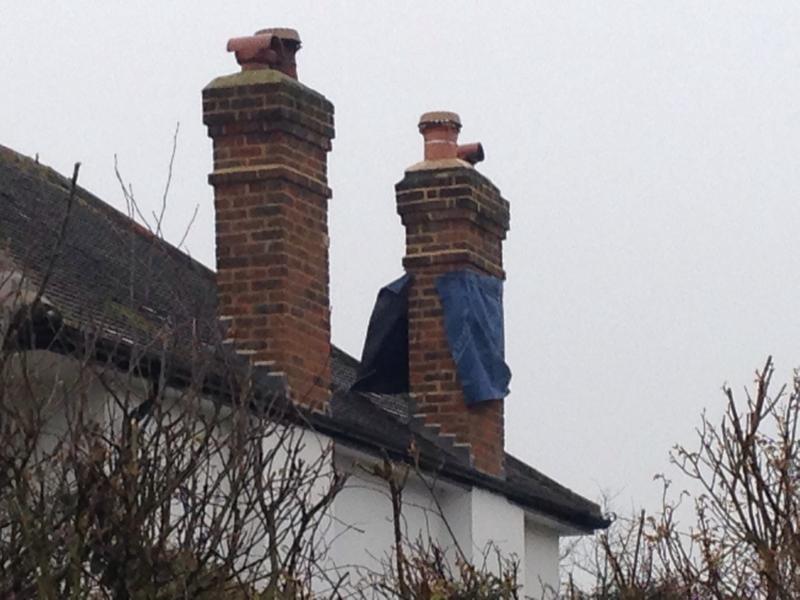

Thanks for coming back to me.
Pics were taken some time ago and scaffolding has since been removed. It was erected to do a full repoint of both stacks.
I've also has flaunching removed and redone, as well as correct ventilation of the unused bedroom flues. See pic from this morning:
As you can see, the rear stack has been sheet covered all winter ( is was taped shut on the left side but wind has got behind it and blown it open). As I said earlier, since doing this trial I haven't had a drip enter the house...
So while I can't take pics of flashing it surely can't be this on the back of the trial? This is why my mind is leading to me saturation of the bricks.

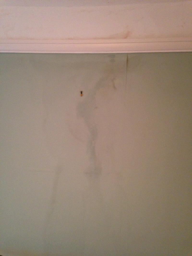

Evidence is not just stains. See the first picture of the water damage. I physically get runs of water falling down the lining paper. The paper has been so wet its bubbled off the wall. The staining is dried up water marks. I've had no running water on the wall since the sheet has been in place.
