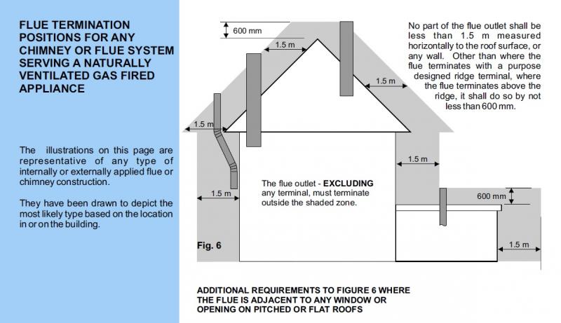

CHIMNEY STACK DOESN'T HAVE A POT/COWL FOR BURNT GAS EMISSION
I might add that on this estate, built in the 60s, dozens of houses have the same chimney stack with a concrete slab atop & side "vents". Unless the law has changed recently i cant understand how this is suddenly unacceptable.

Best to obtain a 2nd Gas Safe opinion & decide from there.
It may be that the same Guy had made a mistake and has been made aware of it. I agree it is strange but I don't know what changes (if any) have been made in the last six years that would cause him to now advise it is not acceptable.
Because you mentioned that he asked for a pot it made me wonder if the height of the vents was the reason for his comment so I did some digging and found the image below that illustrates some no-go areas. Is it possible yours is too low?
You might be on to something there, Blagard. The vents are above the roof top but not sure if it's 600mm. To be fair the Gas Safe guy has 'phoned the organisation for advice & they have advised we have a pot or gas cowl. Looks like it's hand in pocket time.
